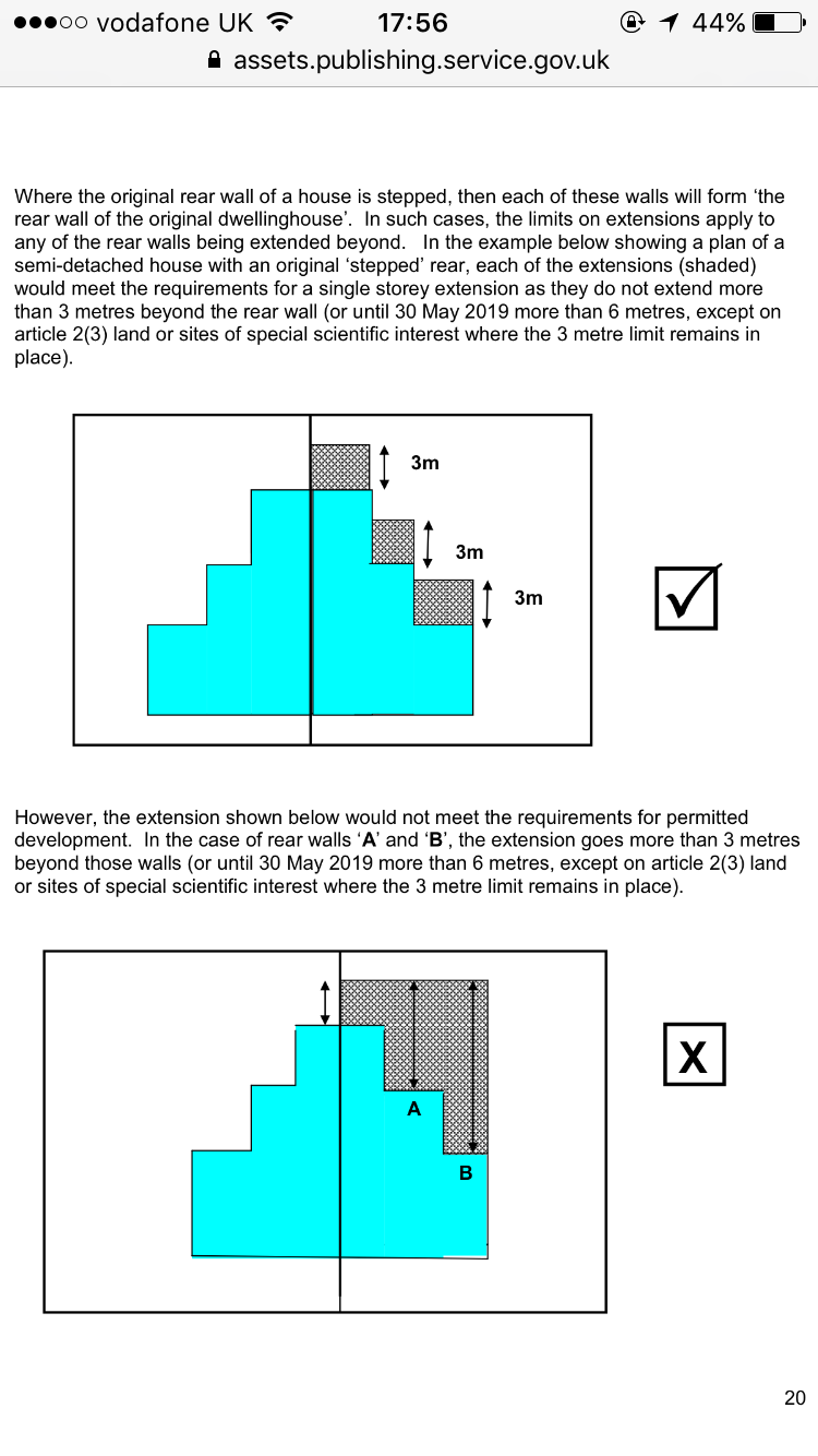

@op - could you post views of your plans (with address deleted) so that we can see what's going on; you might then get more accurate answers.
This is the PD guidance I referred to when I asked my architect to redraft the plans for reapplication, which addresses the stepped rear wall situation but does not mention that it forms a side elevation. does the above guidance not apply to my situation? Also, being quite a small step out (85cm) i'm not sure if that counts as a side elevation? our proposed extension does not go beyond 6m at any point.

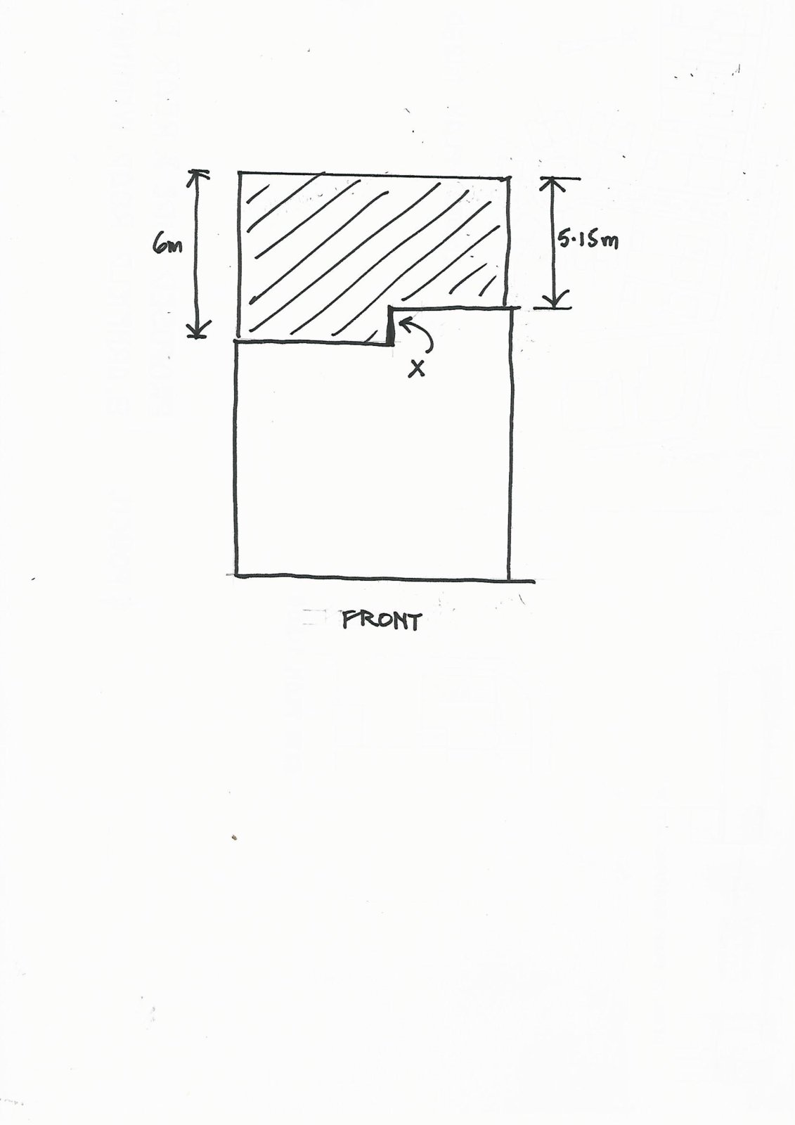

If this sketch plan is the situation of your house, then the extension would not be PD.
This is because it contravenes A(1)j, which states that it is not PD if the enlargement extends beyond a wall forming a side elevation and is more than half the width of the house.
Wall marked X is a wall forming a side elevation, so the extension can't be PD (even walls having 30-40 cm projection have been counted as side elevations).
If your original plan did not show the step-back, then unfortunately you (or your architect) has a problem.
Let's say the neighbour really stirs up a stink with the council. To defend its' position, the council will simply say that it was going off information you (or your architect) provided and that had it known about the set-back, it would have rejected the application as it could never be PD. Had you already built the extension by then, it may be that the council felt it necessary to take enforcement action to have it removed on the grounds that it was unlawful.
Not trying to pour cold water on this because sometimes the rules - and how councils interpret them - are ridiculous, but just trying to point out potential pitfalls - from personal experience.
Thanks for that thorough response with drawing. Yes, what you have drawn is exactly my situation, if our adjoining neighbour is on the left. In fact, my plans have been through the hands of two architect firms (one I employed privately for the initial drawings and one who works with my builder and re-drew the original set of drawing with structural details in the last month). All professionals above visited the property and knew about the original step in the rear wall and not one person has flagged this. I have now scoured the PD rules myself again and can see clearly that this is not PD, and even extending half the width would not be PD, as we are extending 3m on top of an extension, so as a whole the entire extension would be full rear width (6m on the left and 3m on the right) if we were to do this. So any PD extension is not possible for us because of this 85 step-out of our original house.
