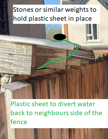

From what he's done he could support the joists on his side of the fence and then cut back the joists and the sheeting so that he can fit a gutter over the gap between the leaves of the fence and then drain it to his side.

I just want the lean to draining appropriately and not flooding my garden although I also don’t feel I should have to give up an area of my boundary for him to gutter. As far as I’m concerned this should be done at his side with no encroachment, regardless of the fence ownership.
I’ve been perfectly polite and explained the situation and I don’t think it’s an unreasonable request.

I well know my suggestion is not satisfactory but in this case could have been a compromise that worked until one or other moved or the fence fell down. Once you see the last photo it's very clear how to solve the problem. It's also clear that the fence is on his side of the boundary - look at the top of the posts where they have cut at an angle.

Does it matter who owns the fence? Surely even if it is his fence the lean to and associated drainage should stop at the fence and be contained. Regardless of ownership it is clear that the lean to substantially overhangs this with no appropriate drainage so my side is flooding.

It only matters for maintenance and replacement. Yes it is his responsibility to resolve the issue and dispose of the water to his side. But I doubt he is interested or cares about you from your comments.
So what is the solution? You could keep asking he sorts it out until he does resolve it (but he may equally so not do anything). I've provided a solution above.
You could put it in the hands of a solicitor - expensive and you may still not get the resolution. That would probably end up in court, how long have you had the problem? after you moved in? or was it there when you moved in?
Then there is the 'nasty' way. Confirm that the top of the cant rails (they are the rails that the fencing boards are fixed to) slope away from your side; then get someone or yourself to cut the corrugated sheets back so they are in line with the middle of the gap between the 2 leaves of the fence, do not cut the joists back. But that is not advice or a recommendation for you to follow. In fact I strongly say do not do that action.

Cut some plastic sheet into strips that will fit between the joints and long enough to drop down behind the fence.
