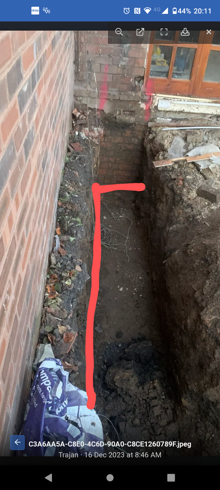

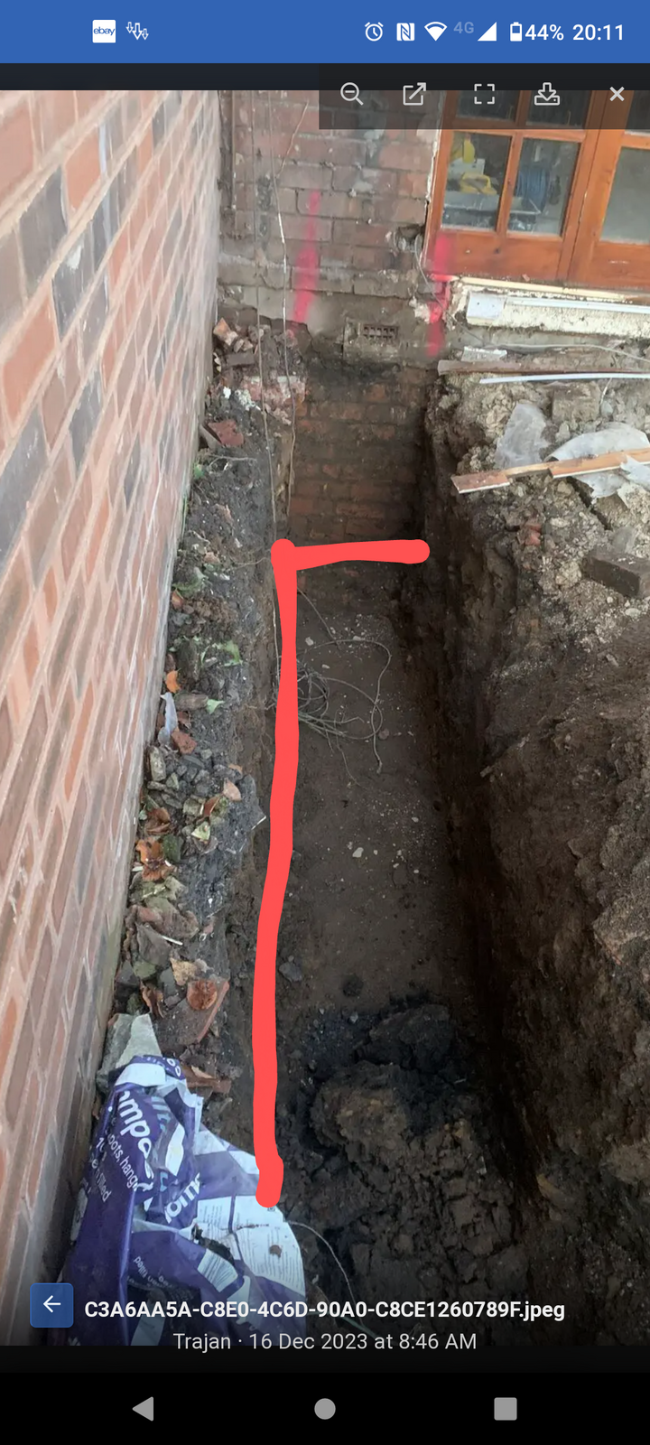

The subsoil looks ok, its taken compaction, who cares about the topsoil, that's just infill and looks like a river flood plain rather than spoil.

The op has stated that the trench is no more than 150mm lower than "the base" of their own extension foundation (not clear whether top of concrete or bottom of trench) so everything more than 6 inches above and left of the bottom of the trench is irrelevant backfill - and presumably the ground below that is considered "good ground". If that starts falling out I'd be more concerned about what my entire extension is built on.

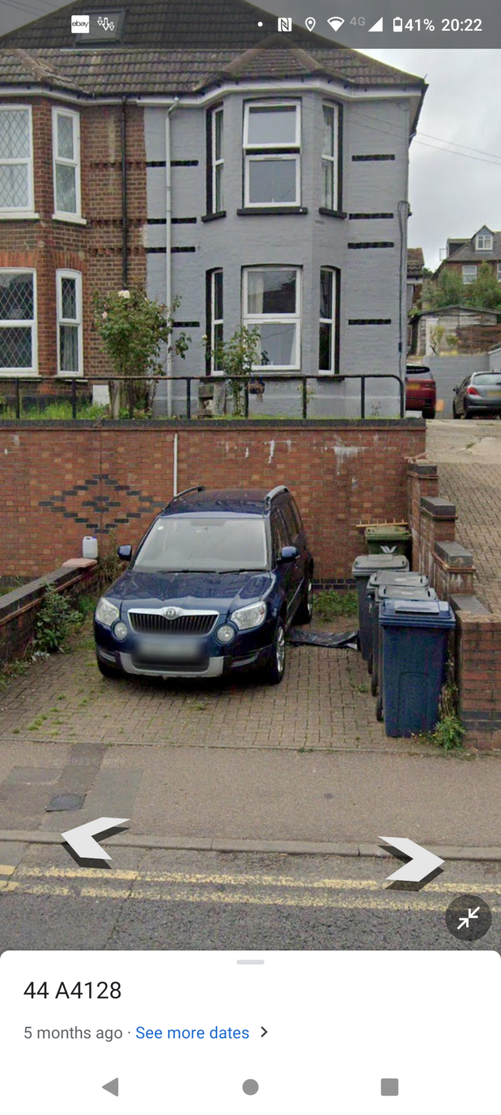

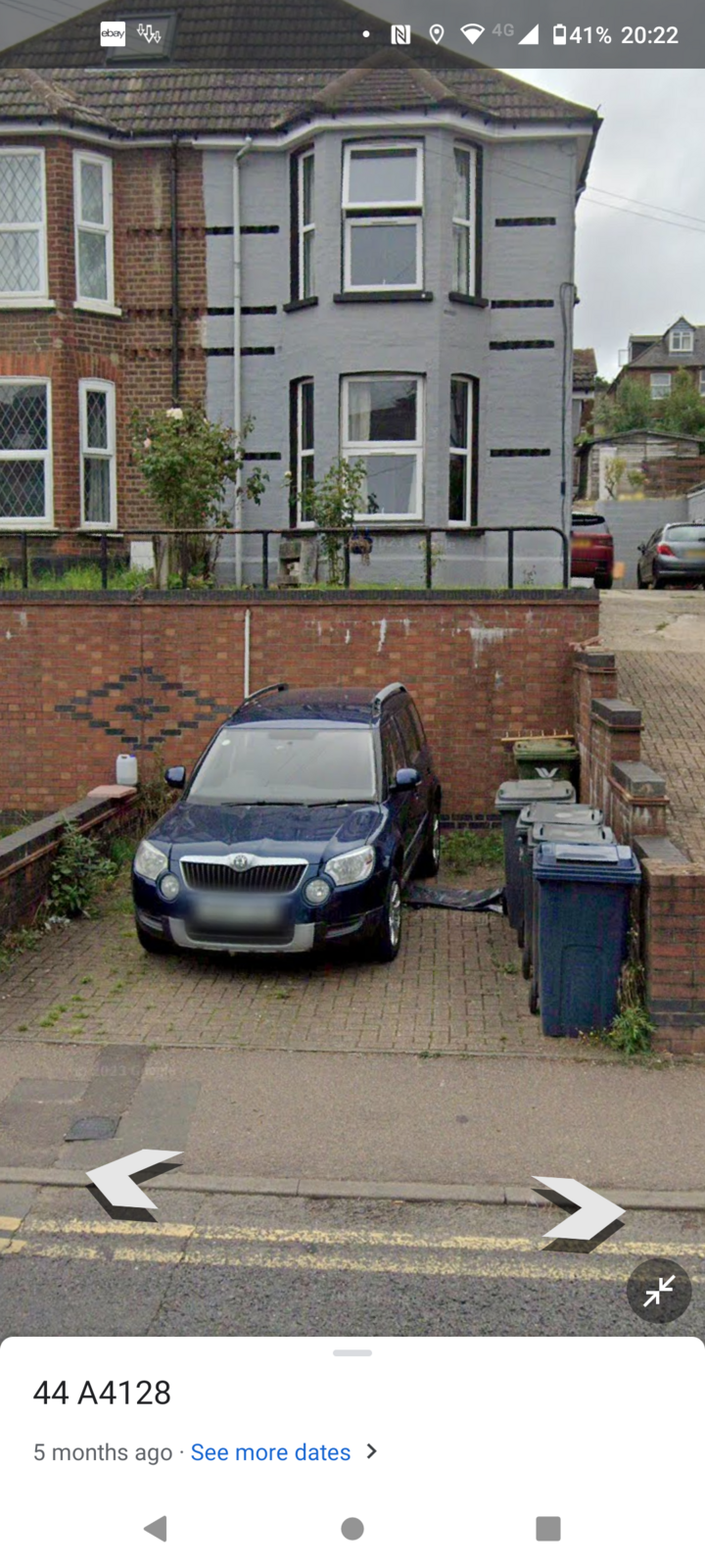

A few years ago the council built these parking bays across the road from me, the walls are about 450mm from the foundation at the nearest - when they dug out, the earth was retained by a few scaffold boards and diagonal acrows, for weeks, - and the foundation trench for the walls were considerably deeper than the finished "floor" level. I waited in vain for the houses to fall over but they didn't.
You normally don't build on topsoil, which is what that looks like from the photo. You normally dig down to clay, rock or sand. It looks like they've gone down a notional 3 feet then given up.
I'm guessing from your photo of the one over the road that yours is downhill from the road. So the soil may have been built up after the house was built, to make a level-ish area around it. Our last house was the same. Despite being 1930s built, I found black turf about 3 feet down behind the back of the house, which was the original soil level. After another foot or two I actually found subsoil, under the original layer of topsoil.

I would have got them to do it in two halves. Digging the entire length along a foundation and undermining it by 150mm isn't very high risk but there is a chance of movement. Sooner it is filled in the better.

Again, you can't dictate that they do this. But if I was them I'd refuse if this was suggested anyway, as it would leave them with a foundation with a bloody great break in the middle. Even if proddling in a bit of rebar to join the halves, they'd have a good chance of ending up with a crack up through the building there. Plus they'd need to pay about a grand extra for the digger for an extra day and an additional load of concrete.

WE had a similar situation and we were the neighbours putting in new foundations next to existing. 2 sides of a 3 sided trench were dug on one day- had to be by hand as there was no access for digger. Then the next day the trench next to the existing was dug and timed so as soon as the last spade and inspector had looked the cement lorry arrived and was poured.
