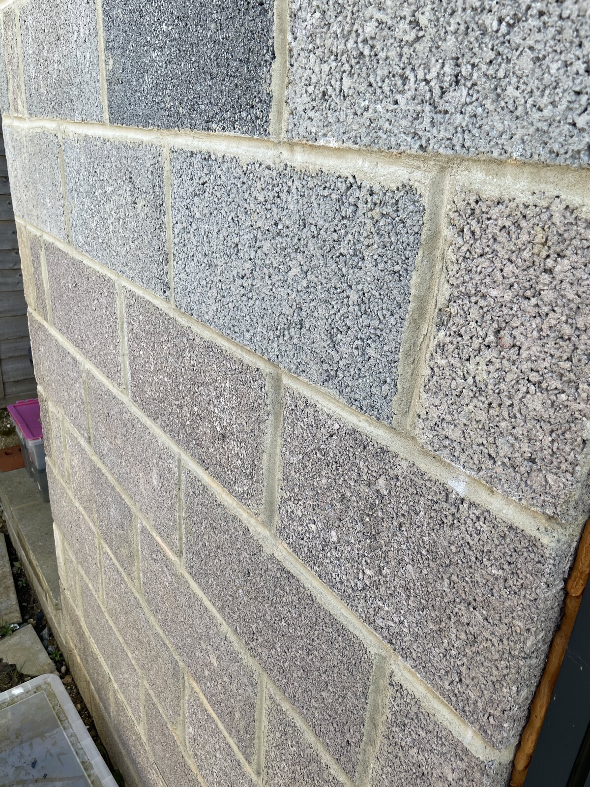

Neighbour hasn't rendered block built wall
Building control wont sign off my extension until the concrete block walls are waterproofed.

I did try and argue but they are insisting. No idea how to get around it. I will clad/render eventually.
The concrete blocks were bog standard 7N ones from Travis Perkins. No idea on the manufacturer...

Down south. Its got a 100mm cavity filled with dritherm 32 and thermalites on the inside... It was built 2 years ago and there are no damp issues...
Just look at table 4 Approved document C and Diagram 12. If you are in zone 3 or less, face blocks with tooled joints is perfectly acceptable.
Thanks, That is an interesting document.
Essentially it says blocks should be fine as I am in zone 3 with 100mm of full fill cavity insulation!
Would you say this mortar joint pictured was a "tooled flush joint"?
I need to write a email to them asking for an explanation?

I'd say a bucket handle joint was good enough. Flush means flush but I reckon they probably meant anything other than a recessed joint.
I have sent them an email... Hopefully they respond with some reasons why it's not considered water resistant enough to get it's final certificate!
