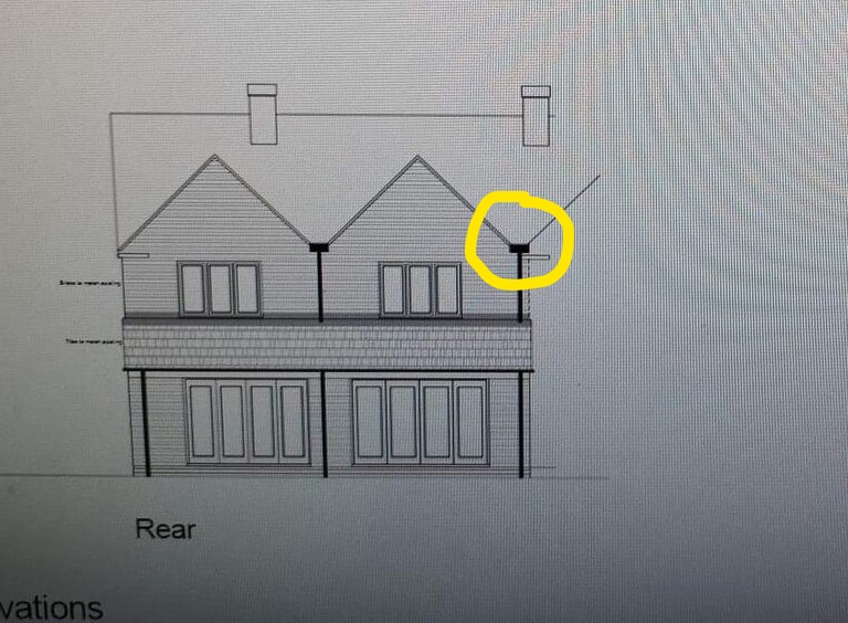

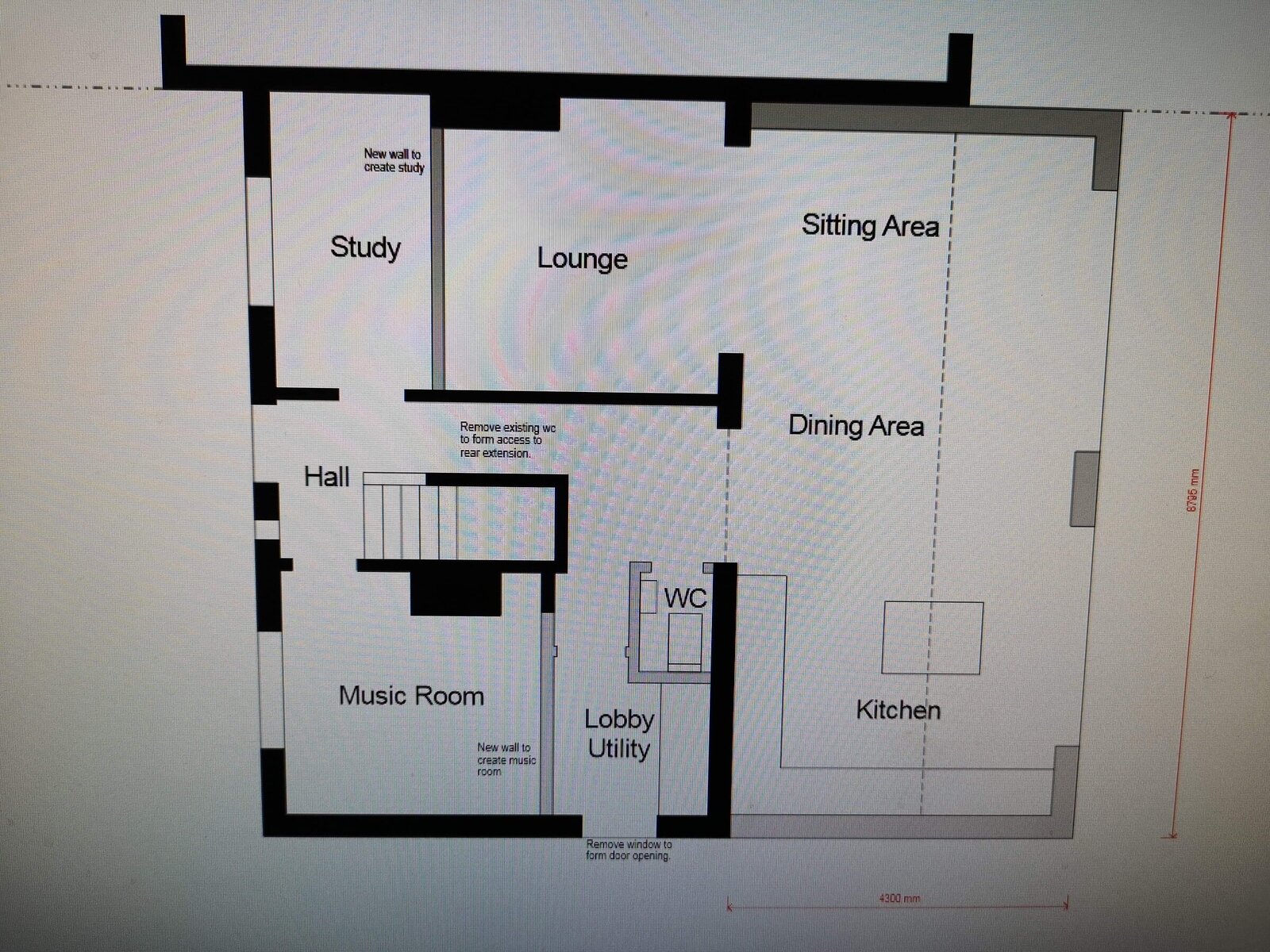

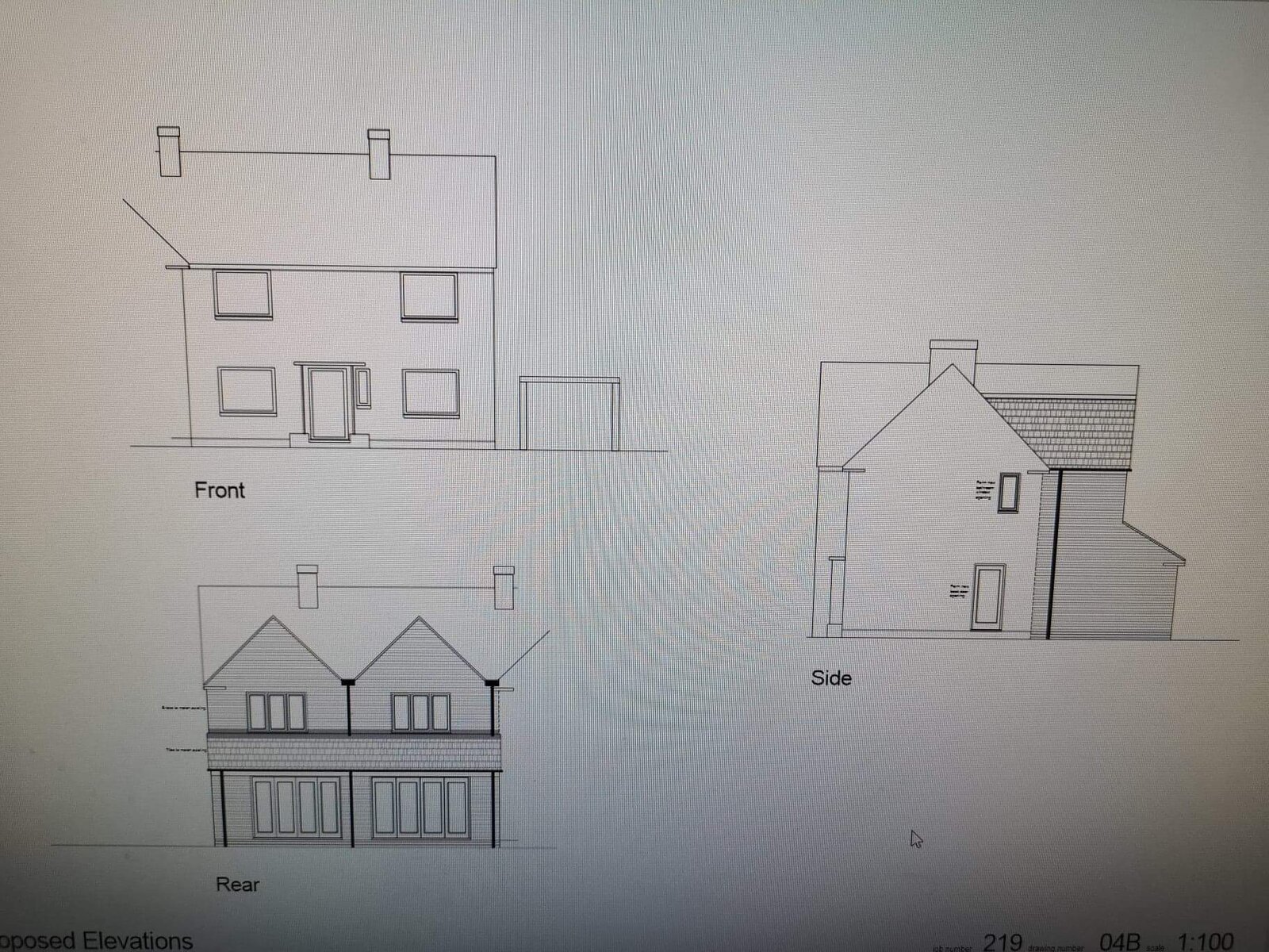

Hi,
My neighbour applied for planning permission to do a 2 storey extension. It got approved and building is likely to start very soon (digger and equipment has been dropped off today). We however have not had party wall notice. Can anyone advise if this definitely is a party wall as reading up things and I'm getting myself confused.
The black line at the top is my external wall, they are doing a 2 storey attaching to my 2 storey external wall and a single storey where my single storey extension in but not attaching to that as it doesn't go up to the boundary line.
By the look of the drawings they are also going upto our roof and making it shared guttering.
There are several ways that the party wall act may apply - proximity of foundations and raising or using a party wall are the common reasons. Each will have a slightly different procedure and notification timetable.
The other issue is connection to a wall or roof that are your property. This may be distinct from party wall matters, but comes under common law and property ownership - ie no-one can interfere with/connect to another's property without their express permission, including gutters.

This was especially cheeky I thought. They want to create a new valley gutter which will involve cutting into your roof and didn't feel the need to discuss it with you first?
That would be ringing alarms bells with me and I would be talking to a local party wall surveyor to send them a strongly worded letter suggesting they appoint a surveyor and serve notice pronto or it will get very messy very quickly.
