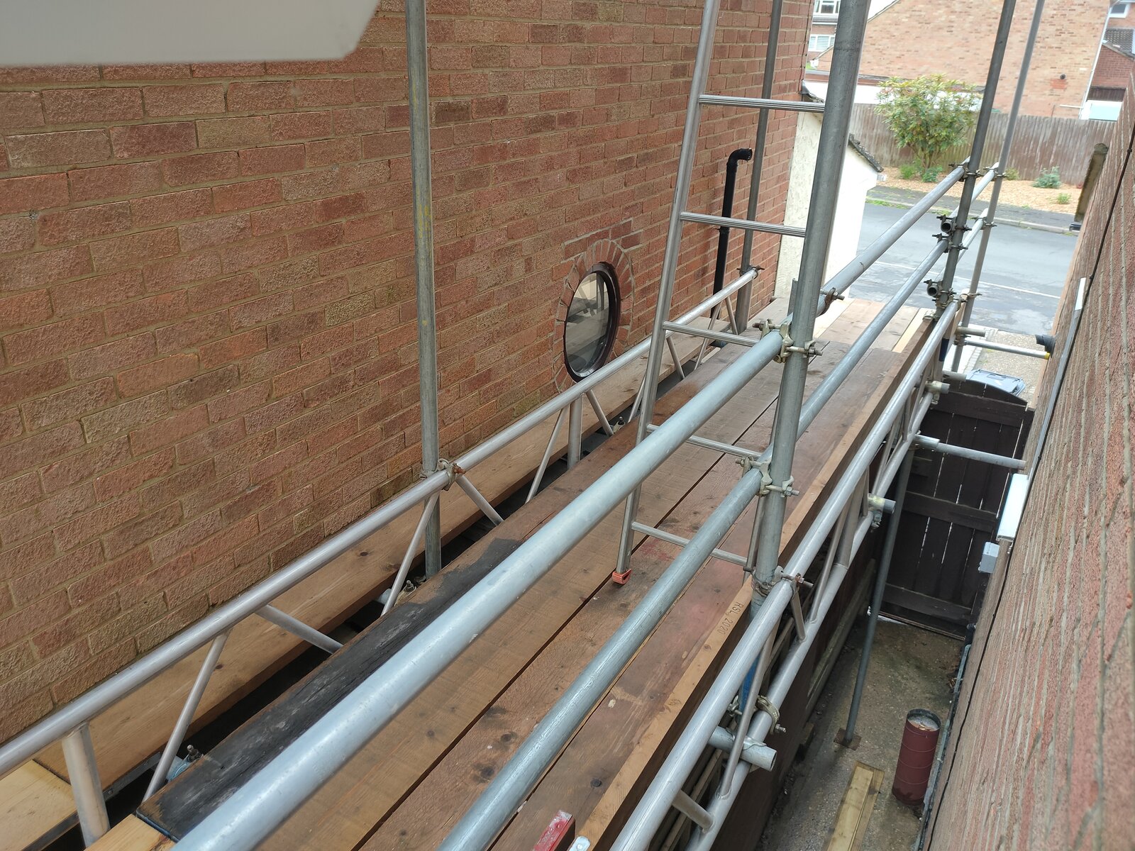

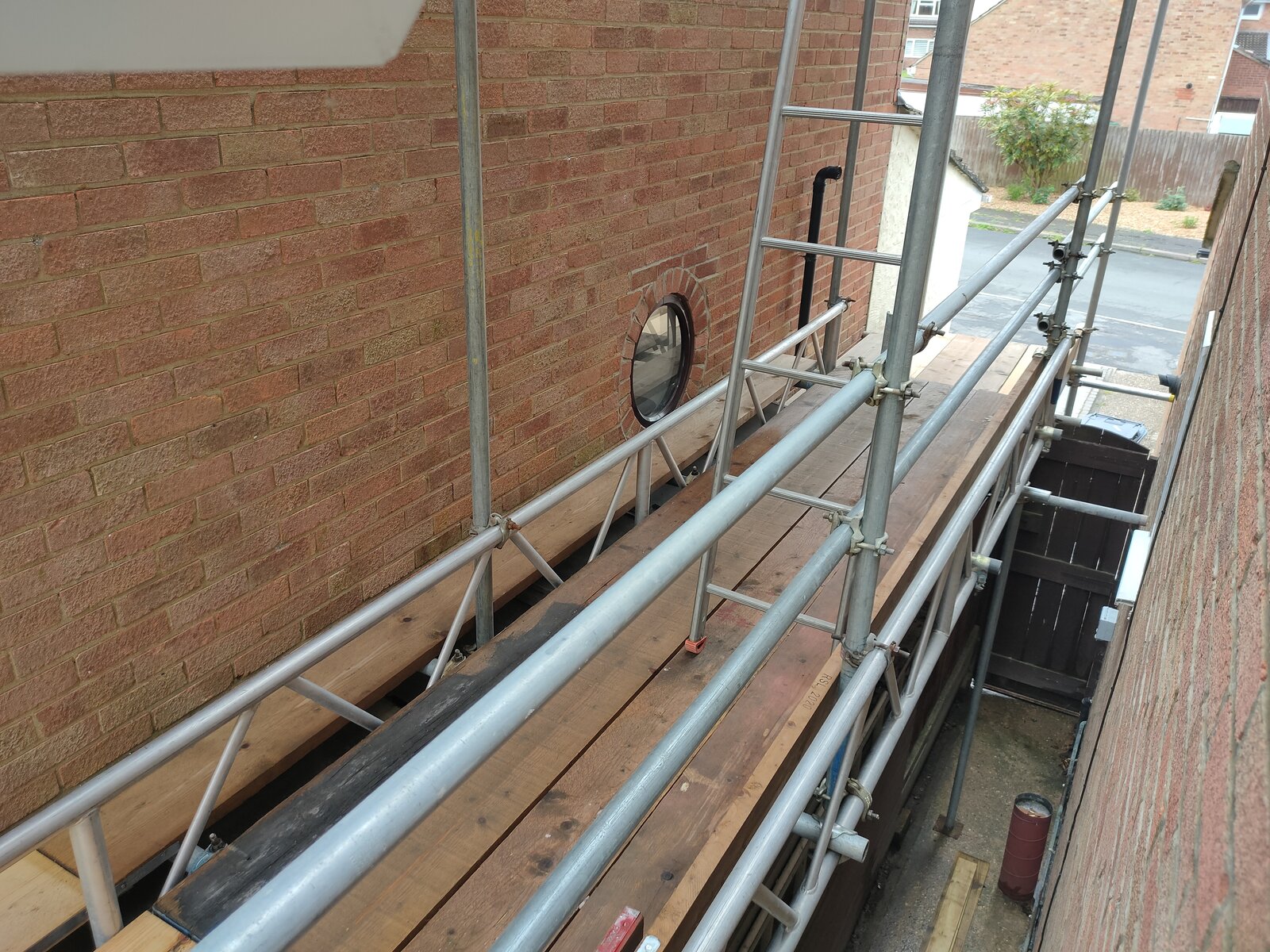

My neighbours have a lean to/shed built in the side of their detached house (annoying as it's made my side access really narrow)
But they've had scaffolding put up to repoint the side of their house, I've attached a picture. It is possible

Also if it's a habitable room, it needs building control, so if you look on your local council recent planning applications list, it should appear.
He can't start without a building notice or full plans application.
If you post a sketch plan of your neighbours house and the extension, we should be able to indicate if it's deemed permitted development or not.
Under PD, it has to be matching materials.

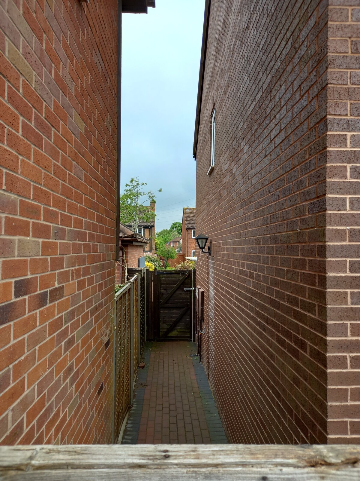

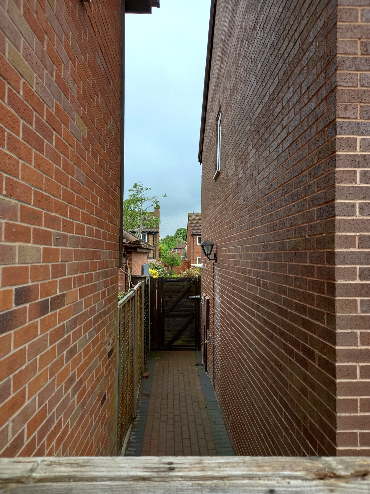

Picture attached. This is taken from a passageway on the side of my house by my kitchen. The original owners bought that from the original owners way back when.
The wood at the bottom of the picture is the top of my fence. The passageway you can see is all my neighbours that he will be covering from the initial gate to my fence and round a bit further. I can't see how i sort the soffit out if needed in time but that is my problem i guess from the comments about.
It won't be habitable, just for 'stuff'. Thanks for all the comments.

As above, he cannot attach it to your wall, he cannot have water run off it onto your wall so it cannot "lean" towards your wall.
He also cannot block the passageway as he has gas and electric boxes down it, AFAIK they need to be accessible at all times.
