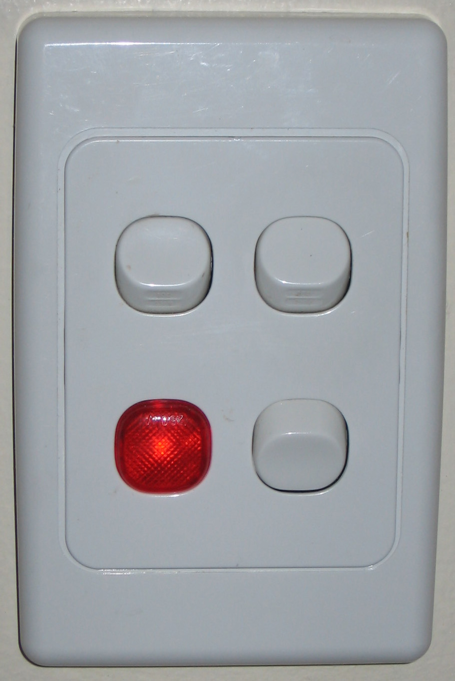

Two way light switching (two switches), switching light in attic. One in attic one in hall. Need a switch in hall with a light that indicates loft light is on. Looked have not seen one. Any suggestions?
Not sure they can exist, due to the varying switching combinations, you normally use a separate indicator, you would also need a neutral at the switch, one other way is mount an indicator on the ceiling and wire from the loft light in parallel, if you do have a neutral at the switch, depending how its wired regarding the switch line, you can change the switch to a modular grid type and incorporate the indicator there.
Using that system either L1 or L2 depending which is permanent line and which is switched line could work a neon if there is a neutral at the switch, however it is unlikely you will find a switch pre-wired.
Clipsal Australia (Schneider) make a SPDT switch with a neon indicator but I do not know if it available in the UK.
https://www.mjselectricalsupplies.c...ker-with-neon-indicator-switch-mechanism.html
However I have had two of a previous model of these - because the neon in the first one failed and the second one has also failed!
The best approach would be to use a two gang wall plate with a seperate neon indicator.
I have used a four gang wall plate with three switches and a neon indicator at the door-way in a laundry which leads to a garage where the light is two-way switched.
The neon indicates if the light in the garage has been left on.

You can build a two way switch with neon using MK grid plus. K3632+K3702+K4889+K4981
