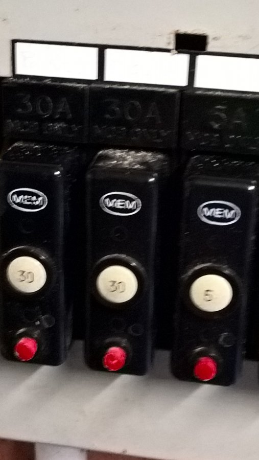

Here is a photo of the garage consumer unit, where the 5 amp MCB of the lighting circuit broke. As I wrote, putting in the one that seemed to be spare (the only unlabelled MCB and also 5amp, and I haven't that anything stopped working after we swapped them) fixed the issue.
It is a very old CU labelled MEM where the MCBs have round buttons. Is there any chance I could still get a replacement breaker from somewhere? Any shops specializing in old spare parts?

On ebay they are selling used ones, taken from boards that were removed- for £20+!
Thanks. I just came across the ebay listings myself.
I don't think I will spend that much on an older breaker, that may or may not work!
I do realize they stopped producing them, but perhaps there is hope that someone stocked up on them years ago and is desperate to clear the stock?
One of those shops that got stuck in time (1971 ideally - year the garage was built). The problem is, they don't tend to sell on the internet...
