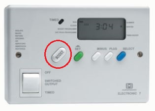

Can you be more specific about the "Honeywell" with the "Boost" button with a photo or provide the model number. I don't ever recall seeing a Honeywell product with a boost button. However I guess there are dozens of different models about so I might have missed one or two. A boost button is normally associated with an immersion heater controller, it switches the element on for a short period to provide a 'boost' if you run out of hot water. The example below is a Horstmann.

Ur right, it doesn't have a booster.
Probably got confused with other things.

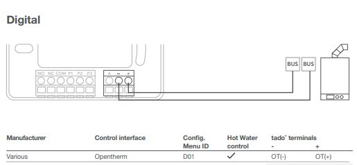

As you can imagine, NEST has a lot of connectors on the controller whereas TADO has a RELAY: COM NC NO and Digital / Analog connectors.
I am not an expert but again just going to what people have shared online. I prefer TADO as it also has smartTRV and sounded best advanced thermostat outhere but yeh ...
I hope I get to the bottom with this as now have a boiler but not working due to this wiring etc.
There are several types of TADO for the various types of installation, this example is for the wired thermostat and shows OT control. But this diagram is with a combi (ie no motorised valves)
Yeh would be easy on combi boiler!
I got system boiler Ideal Vogue Max s18
Also the Tado EU model is only one supporting OT but then how I connect CH / HW PDHW is a puzzle.
