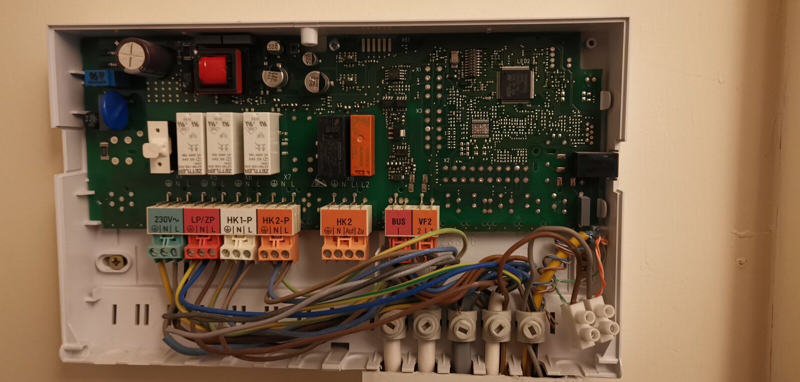

On closer inspection I have a VR61/4 not a vr65. Any ideas on the wiring?

Correct. All zone valves use the orange SL to control the boiler using on/off controls via terminal 4. The VR66 and VRC470f/VR20 are used only for modulating flow temps.
