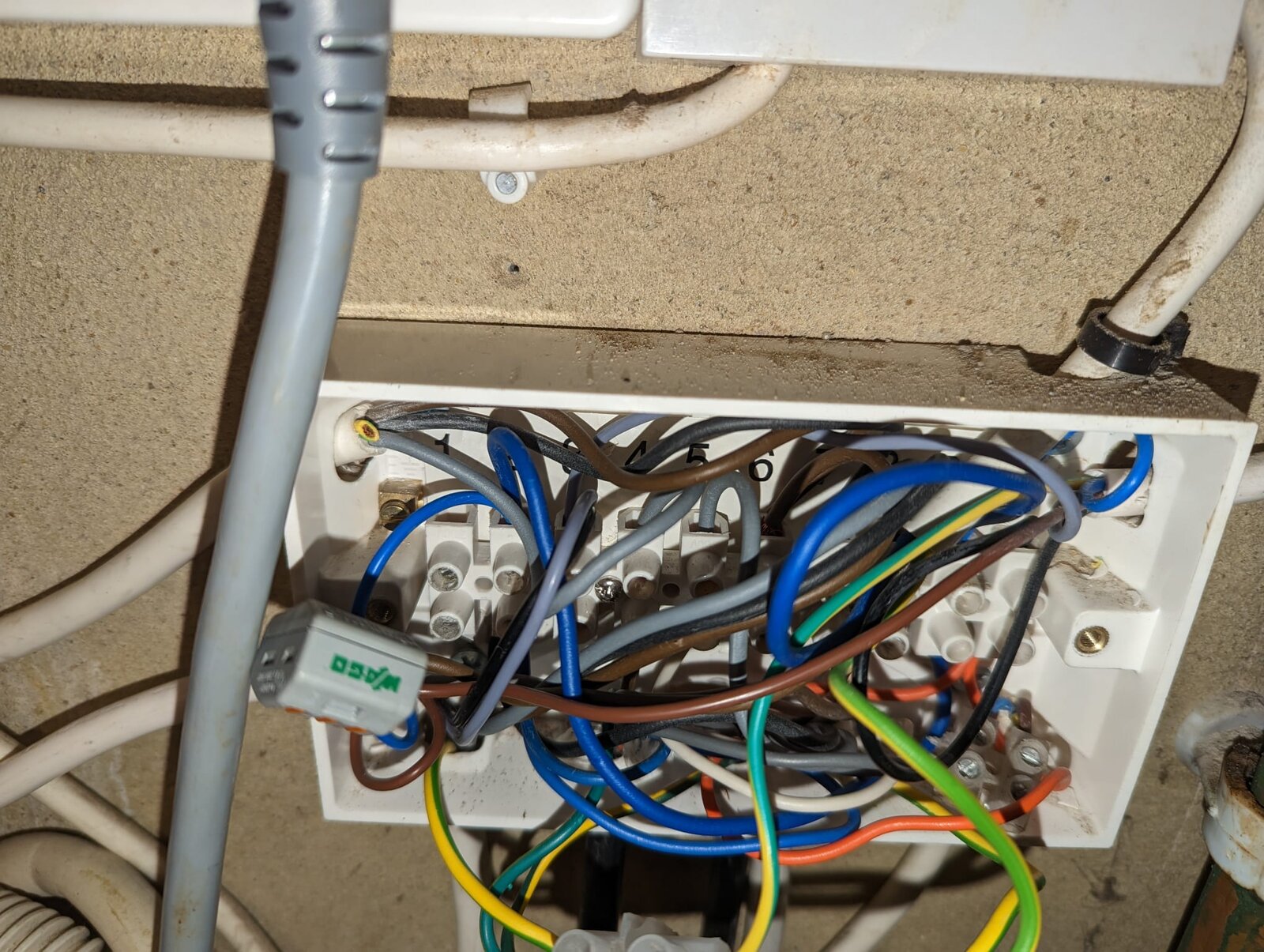

Hello

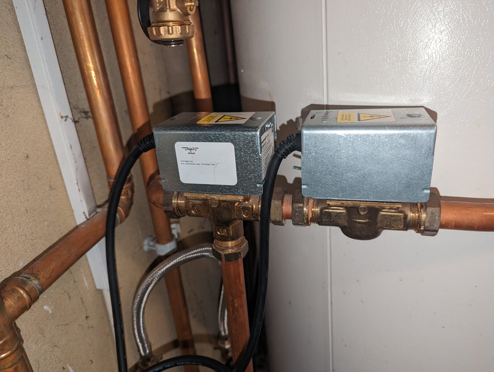

I have a nest third generation thermostat that was connected five years ago, The heat link died and google offered to replace for free. Around the same time another engineer replaced a mid position valve. I believe my system is neither s nor y plan (it has a mid position valve and a 2 position valve that connects to a megaflow)
I noticed that I was having issues with hot water. The guy who changed the mid position valve assures me that the wiring is correct for the valves (he doesn't know how to wire nest). Boxt engineer (who seems clue less to me says there is nothing wrong with the nest wiring (I suspect he is wrong)
Issue I have is that hot water does not work when heating is on. I have to switch off heating to get hot water. When heating is on and I turn hot water on boost I can see the 2 position valve is opening (the lever on back is free) so I suspect that there is something wrong with the mid position valve.

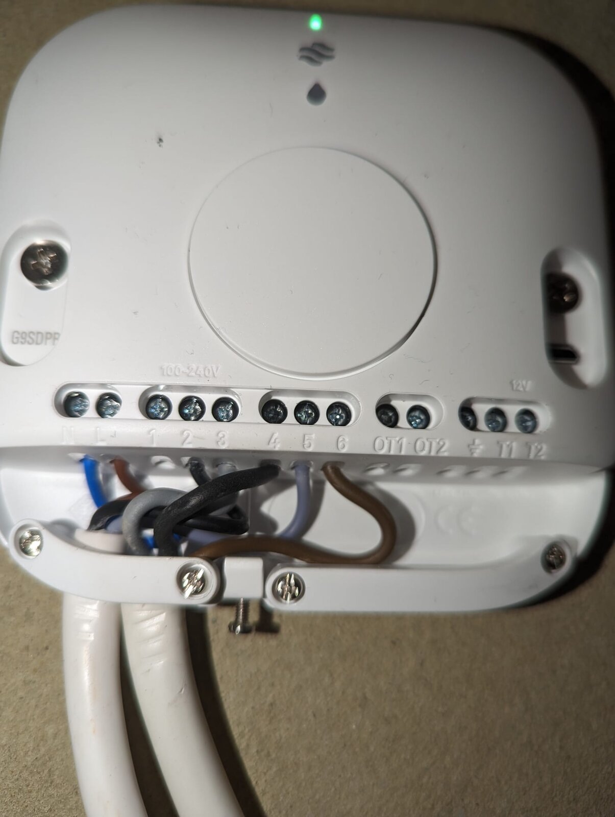

I have attached photo of nest wiring.
Please help

Did it work ok when the Nest Heat Link was replaced before the 3-port valve was changed?
I suspect you have a Y-Plan system with an additional 2-port valve to protect the cylinder from turning into a kettle in the event of a fault.
See:- https://flameport.com/electric/central_heating/heating_wiring_Y_plan_unventedHW.cs4
The 3-port valve will stop HW from flowing when CH is ON if it's been told to move to Port-A only. You can check what the position of vale should be using the following test sheet.
The only diagram you really need to check the NEST is this.
Terminal 6 should be live when Hot Water in ON, 4 should be Live when Hot Water OFF, 3 should be live when Central Heating in ON, 2 & 5 should be Live all of the time. This obviously only checks the NEST is working ok, it doesn't confirm that all is ok from the wiring centre.

The state of your wiring centre probably isn't helping the engineers diagnosis though. It really needs a proper tidy up and to make sure that the terminal block follows the same order of the diagram, plus I tend to label the cables to make fault finding easier.

I agree the wiring looks like a complete mess.
I did some tests
On the NEST (on / off refers to the status in app)
Heat Off HW off
1,2,4 and 5 are live
Heating on HW off
2,3,4 and 5 are live
Heating off HW on*
1,2,5,6 are live
Both on
2,3,5,6 are live
Above seems to suggest NEST is connected ok.

Based on those readings I can confirm that the NEST is outputting ok in all heating modes.

Yes to the 3-port valve being a mid-position valve.
Heating off HW on
Red and White live = Should be no voltage on white. With your measurements the valve is open for Heating AND Hot Water.

I think your problem is with the wiring to the valve (possibly in the wiring centre) or at the valve connector itself when the new valve was fitted.
Unfortunately it's something that needs to be looked at properly in person as there is no obvious error that stands out.
The only other thing I can suggest is if the 3-port valve is on a connector, can you power down the system and open both ends of the connector up to make sure that all wires are in and maybe make a note of which colours on the valve are connected to what colour on the cable that goes to the wiring centre.

I replaced the new one with the old one (The old one was replaced because the heating was on switching off at night on very cold days - I think it was because the mid position valve was getting too hot and not operating - the frost thermostat is not connected)
With the old one connected back again HW does come one when heating is on.
This led me to believe that the new one is either faulty or intended to work differently.
My old valve was V4073A1039. New one is 40004805-001 . It says Sundia Y Plan 3 Position Diverter valve
Either the new valve is not a like for like replacement or faulty
