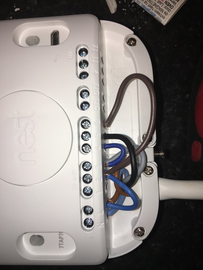

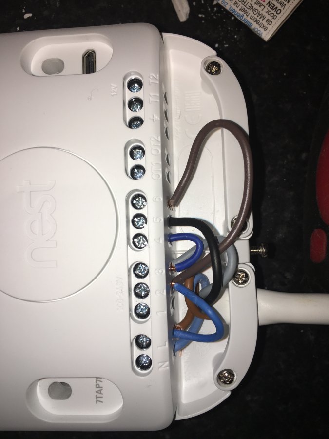

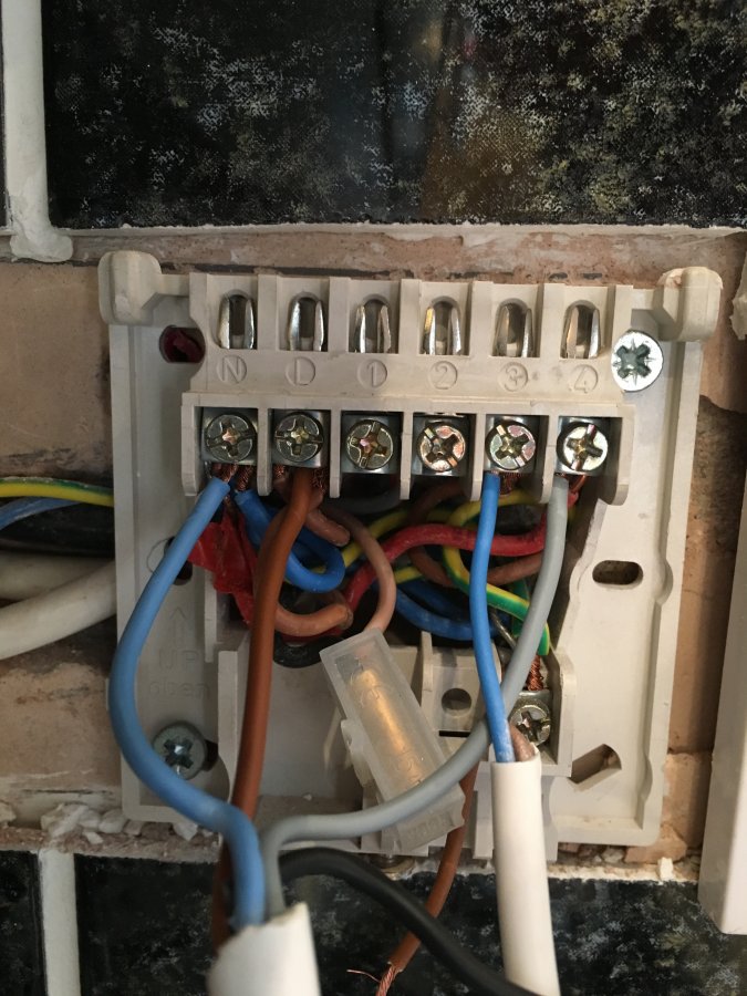

Hi, I'm looking for some advise. I have installed a nest heatlink. when i use the wirelessly connected nest thermostat to control my heating it won't switch the heating on, it will if i select boost on hot water switch the hot water on. to complicate things (with makes me believe it is wired up correctly, mostly) when i push the large button on the front of the heat link it switches the heating on! it just won't do the heating through the thermostat or iPhone app. Who i do try to switch the heating on through the app i hear the heat link click and the valve turn in the boiler also the old existing thermostat in the hall clicks (which i have turned on to max) but the pump DOES NOT fire up with the boiler. again when i hit the hot water boost in the app everything clicks and the boiler fires up.
Any help would be greatly appreciated. thanks

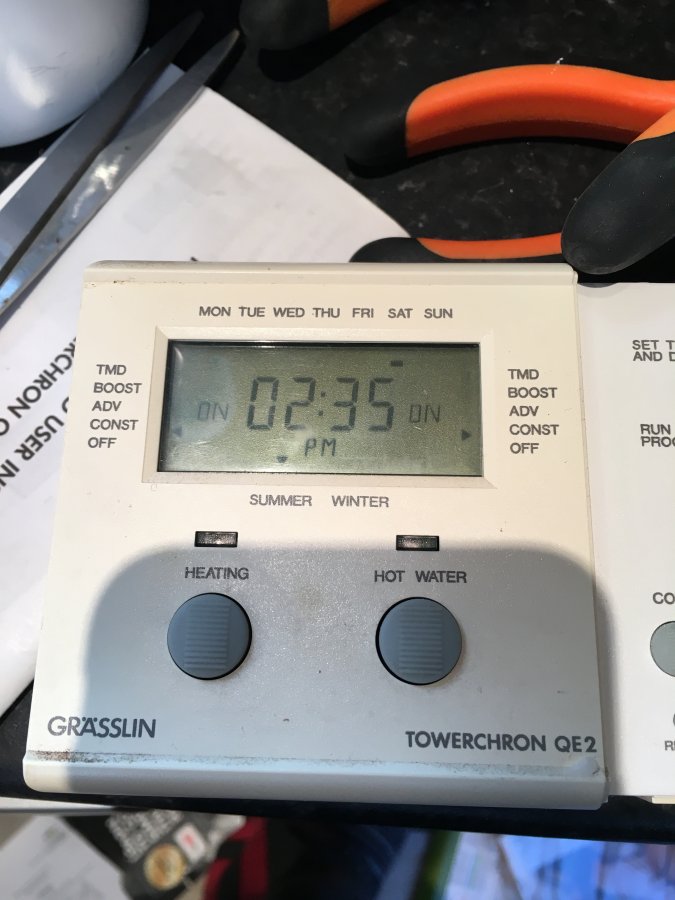

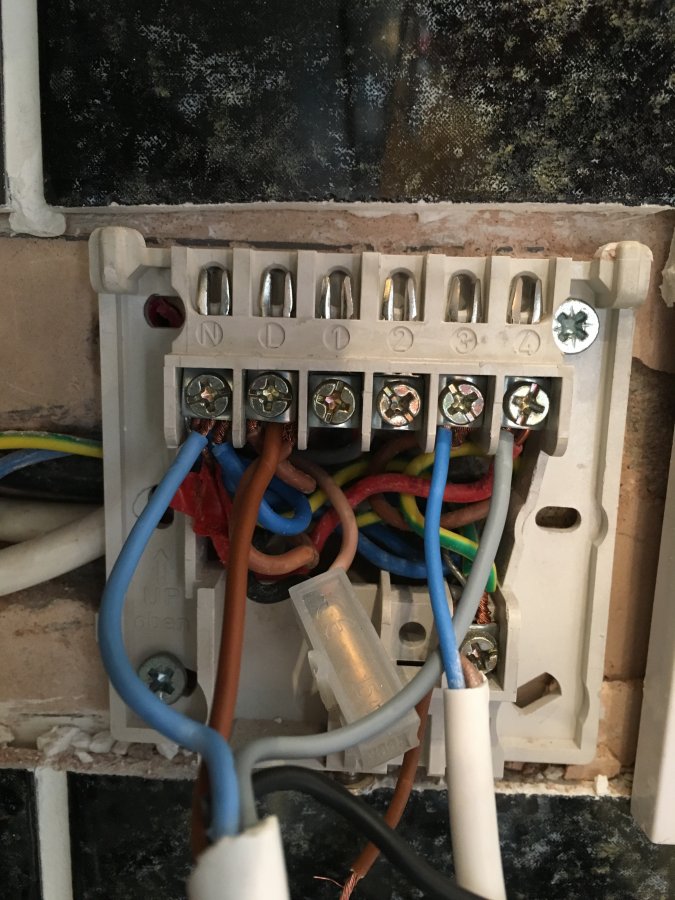

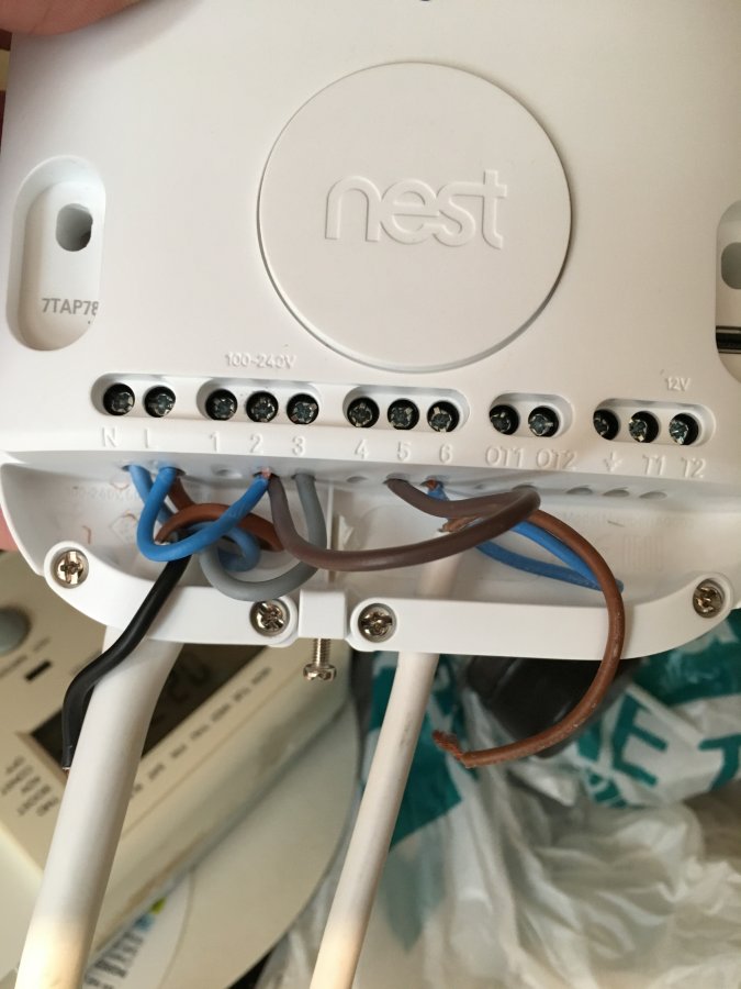

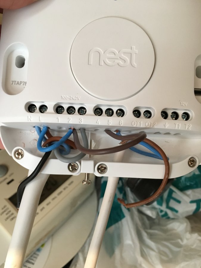

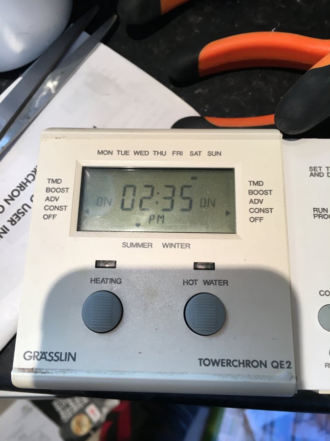

Bit more info ports 3 and 4 in the Towerchron QE2 are the water and CH calls to heat. the grey and blue are going to the nests 3 and 6. The live in the nest is linked through to 2 and 5. the remaining wiring in the towerchron has not been changed other then me pinching of the live and neutral for the power link. if i remove all of the nest wiring out of the towerchron and put the original timer back on everything works as it should. thanks
Thanks to Mark C off another forum for the solution everything now works perfectly. solution:
So, all you had to do was jumper 3 (CH ON) to 4, connect live to 6 and have (HW ON) fed off 5.
Turn on CH it also passes current to 4/5 which is "Normally ON" so kicks in the HW. Turn on "JUST" HW it bridges just 5 & 6 (4 & 5 are no longer bridged so no current to CH) Simples :)
