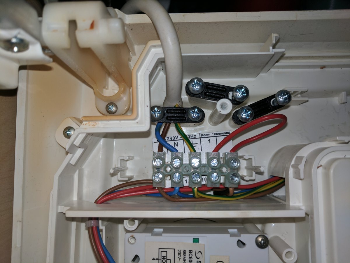

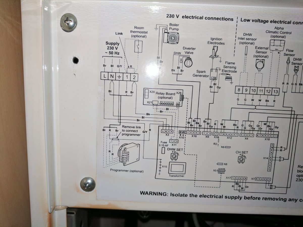

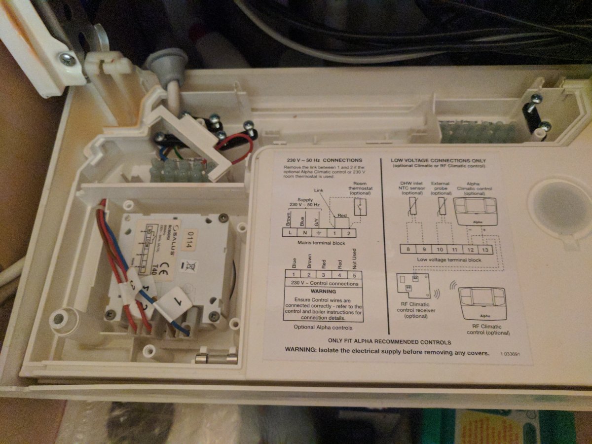

Hello, I have just received my nest thermostat and I want to connect it myself to my boiler. Could someone help me with the heat link wiring?
I guess I will have to remove the Salus receiver which is the receiver for my old wireless thermostat. What about that link between 1-2 on the main connector block?
Thank you in advance!

Today we use special TRV which transmit info back to a hub and that tells the hub when to switch off the boiler, there is a cheap system using a Nest thermostat using what is called ITTT (If this then that) so eTRV's like the Energenie MiHome can tell it to switch off similar to the EvoHome but not with as many bells and whistles, since your diagram shows you already have outside sensors there is very little benefit in using a half hearted approach like Nest. By time all the eTRV's are installed you can do all the things like have the heating come on when it detects your phone is within a set distance and also manually alter with the phone.
Your picture shows the link to remove to install a remote control for the boiler, however consider first why you want Nest?
