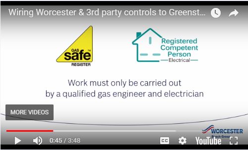

Hi all
Ive got a 3rd gen nest and Ive been looking into fitting it myself. I think that I understand what I need to but thought i should probably check
Ive a worcester greenstar 30i combi boiler and a wireless salus ST620WBC thermostat and receiver.
from what i have read and watched on utube videos i need to
connect power to the heat link from the 230v out [L][N]
call to heat [3]
water [5]
and thats it?
also, will i need to remove the salus receiver from the boiler?
thanks in advance

I saw this video on utube
(2.34) which led me to believe I needed to connect both. Was just looking for some advice
That's a Worcester video that covers a whole range of different boilers, and there's no specific mention of the terminals for a Heatlink in it. So, I'm still at a loss to understand how you came to figure out you would use Heatlink terminals [3] and [5]
For a Combi boiler (with no timed hot water control) then terminals [2] & [3] would be used for the switching the heating. (No connection would be made to the hot water terminals)
for a System boiler (with timed control for heating a hot water cylinder) then terminals [2] & [3] would be used for the switching the heating, and terminals [5] & [6] for switching the hot water. Systems that have a three port motorised valve (aka Y Plan) also require a 'hot water satisfied' connection to terminal [4].
I would seriously recommend that you consider the advice in the video you posted the link to:
It says for 3rd party stats which nest is.
