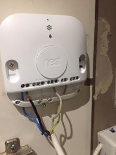

Hi I am sorry for resurrecting this issue but I am a bit lost and need help. Have a nest 3rd gen heatlink and I am replacing the current thermostat, a Honeywell ST900. I have connected the L /N correctly and the heatlink powers up but the pickle I face relates to the 2 wires coloured black and grey which I assume is for the Hot water and Central Heating. Btw I have a megaflow system and the boiler is a Valiant eco tec pro. The current honeywell thermostat is connected to a Honeywell junction box. I have no room thermostat so the nest thermostat is going to be wireless. when I connect the grey and black wires to the heatlink, it does not power the boiler. I need to know the correct place to insert the wires. Previous thread suggests black goes into no 3 and grey into 2 on the heatlink. Is that correct? Please see pic below. Any advice much appreciated.

I'm not aware of this product? Do you mean a ST9000? If you do have a ST9000 this is a programmer (time control) and not a thermostat (temperature control)
It is a bit unusual to have a combi with a Megaflow but not unknown. As you have a Megaflow, I am assuming that you are replacing a ST9000 2 channel programmer for both Heating and Hot Water, coupled to two port motorised valves for control as opposed to a three port. If so, you can proceed as below. If you have something different, do not proceed and post back what you do have.
The wire that previously went to the ST9000 terminal number 4 is the 'central heating on' wire this goes to Nest terminal 3
The wire that previously went to the ST9000 terminal number 3 is the 'hot water on' wire this goes to Nest terminal 6
You then need to insert links between the 'Live' terminal and both 'common' terminals number 2 and 5 at the Nest.
This isn't right:
The cable should be properly clamped, and no unsheathed conductors should be outside the enclosure.

Many thanks to all that commented on my thread..your comments have been helpful. Special thanks to Stem..you a star! I followed your instruction and connected the nest.
