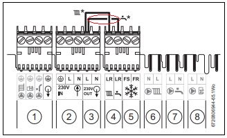

Am I correct in saying that if I configure NEST as a 'System' boiler instead of 'Combi', wire a live supply/DHW switch using N/O terminals 5&6 on the NEST Heat Link and remove link on the boiler, that I will then be provided with direct app control (and importantly, schedule) for the preheat function?
If this is indeed possible, does having the NEST set as 'System' affect any thing else that may be detrimental to my combi boiler?
If you are referring to terminals 'L OUT' and 'LR' (with the tap symbol) as below, those terminals are provided for external time control of the hot water pre-heat function.
The highlighted link is removed....
....and the terminals can then be connected to the Heat link 5 & 6 instead as you figured.
With some types of boiler it is necessary to open a 'room sealed' compartment to access the boiler's wiring terminals, where this is the case, this is not a DIY job and should only be done by a RGI (Gas Safe Engineer) who can carry out the necessary safety checks to make sure that it is properly sealed up again afterwards. I can't remember if your boiler falls into this category or not.
Configuring the Nest as a 'System Boiler' enables the hot water control functions, the heating doesn't work any differently. I seem to remember that the boiler switch needs to be left on the Pre-heat selected setting and not Eco.

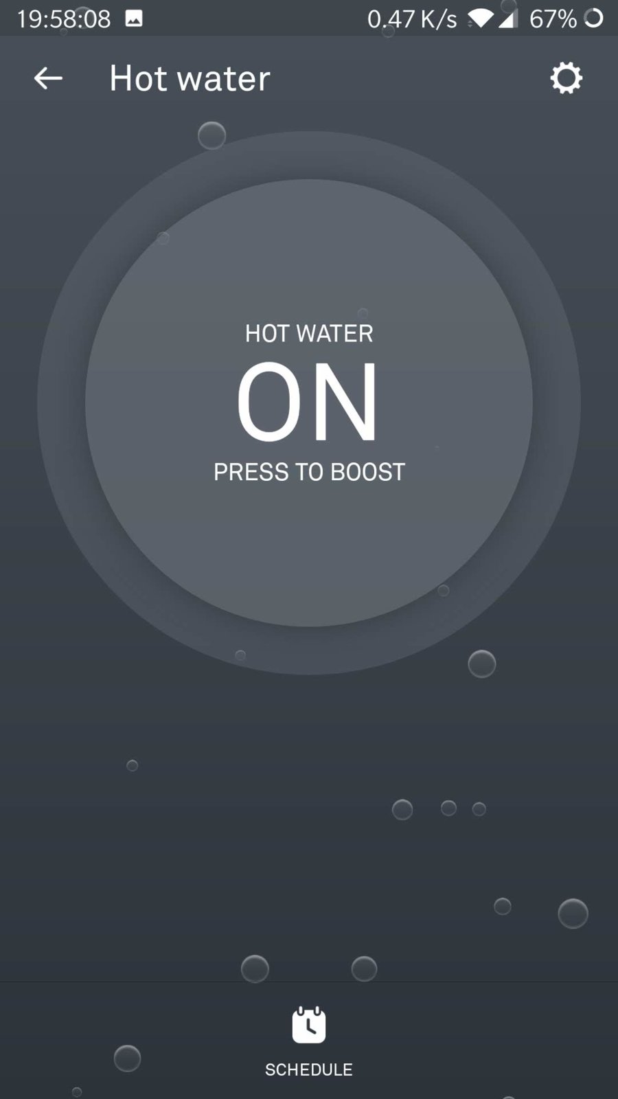

Firstly, my Nest integration works exactly as I intended it to. I set up the nest as a 'System' boiler which enabled a new set of options to control 'Hot Water' within the Nest app and the ability to set a schedule for preheat mode.

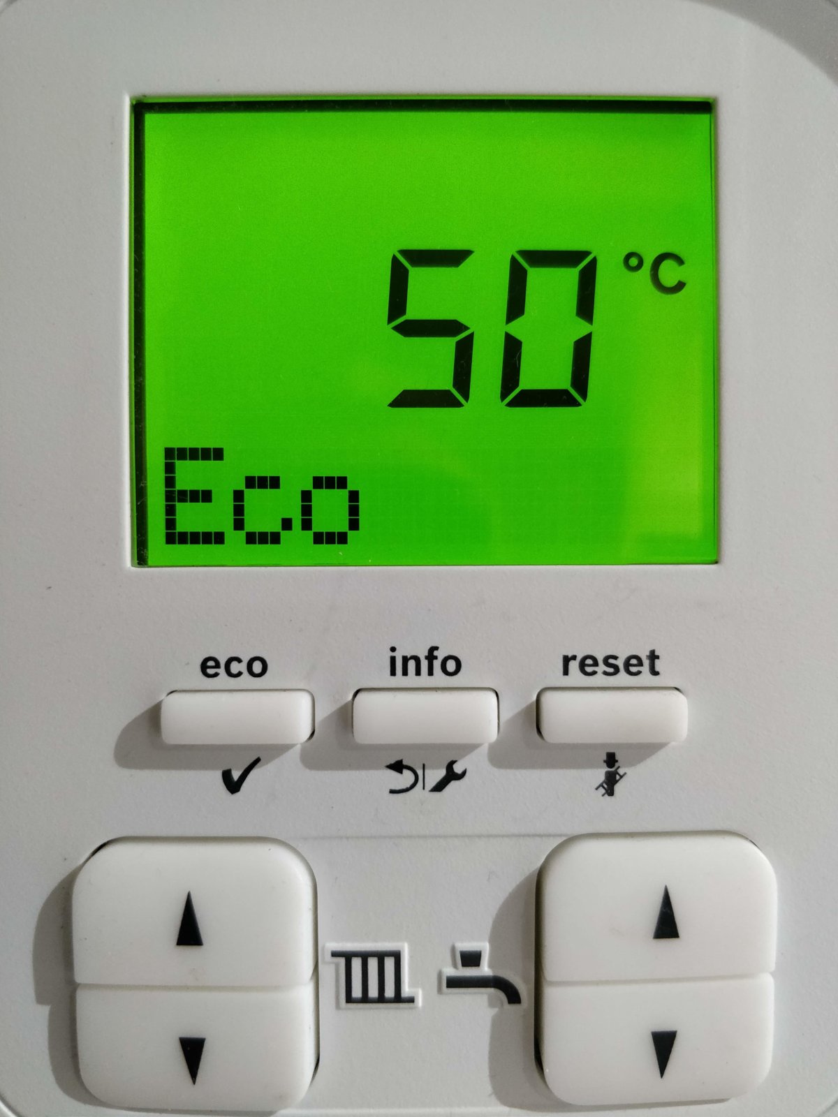

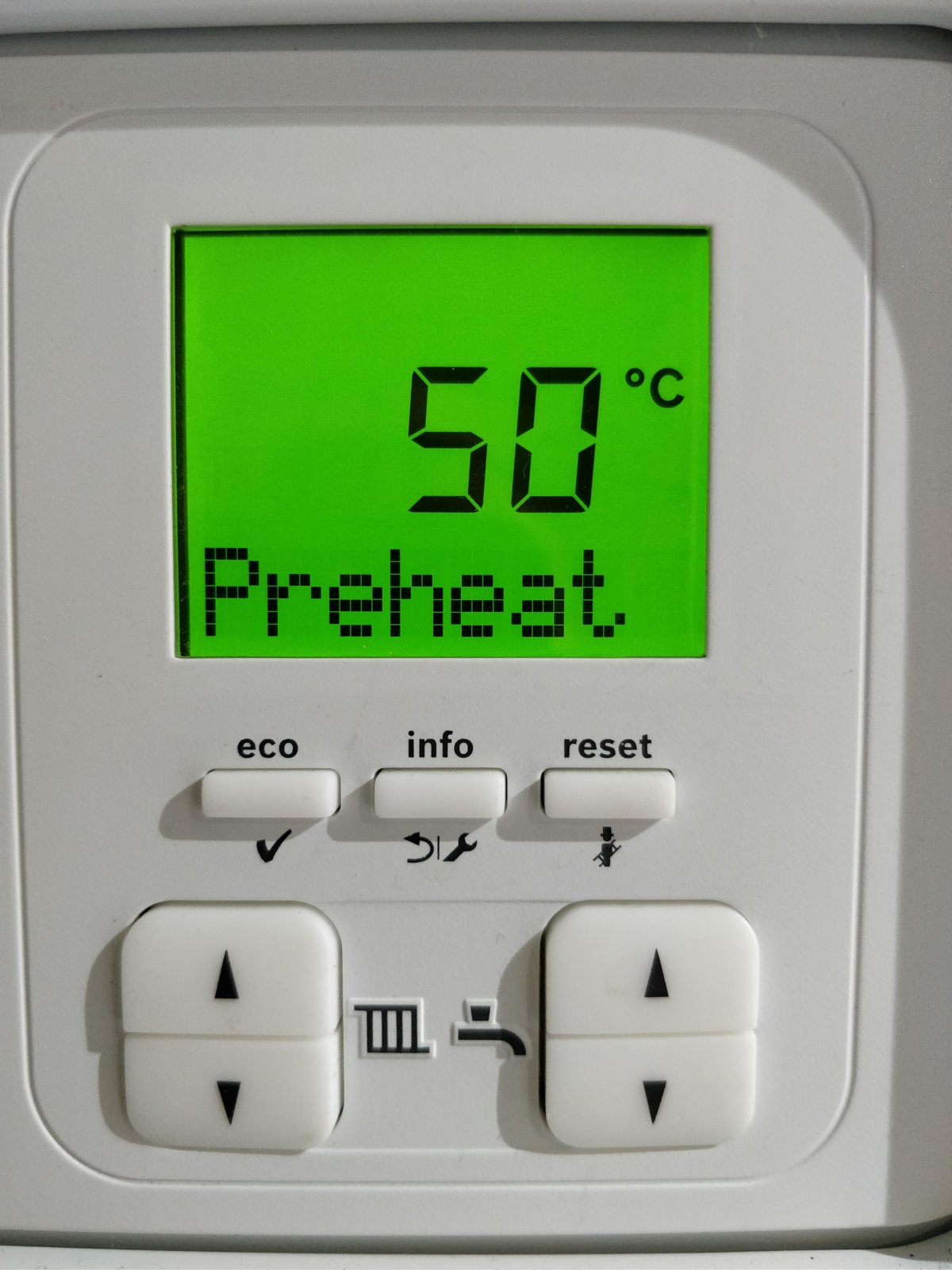

With the link in place, the boiler can be manually toggled between preheat off (shown as Eco) Eco.jpg and timer mode (shown as Preheat) Preheat.jpg with a 1 sec push of the selector button.
Of course, as the link is in place, there is no timer and therefore it is forced into preheat being on.
Simply put, preheat is either on or off and is controlled manually from the boiler panel. The state of this setting seems to be remembered if the power is disconnected.
With the link removed and replaced by the timer/Nest, when the boiler is on not in Eco mode, the preheat state is decided by the Nest.
So now, preheat is either off or timer controlled.
The manual toggle of these states has priority over the Nest.
If you manually set it to off on the boiler panel (Eco) it stays off, whatever the Nest tries to demand.

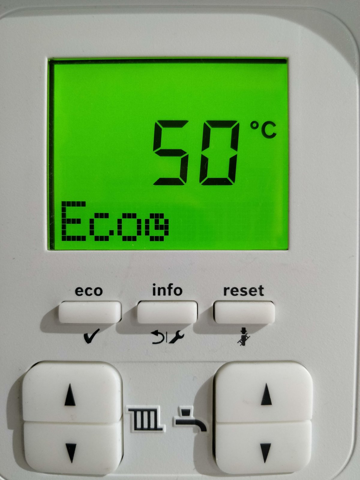

If it is on then it is up to the Nest whether preheat is on or off and this is shown by either the preheat display Preheat.jpg or the new display of Eco with a timer icon after it Eco Timer.jpg depending on what the Nest is demanding. The Eco with a timer display indicates preheat is currently off but that the state will change automatically via the Nest.
