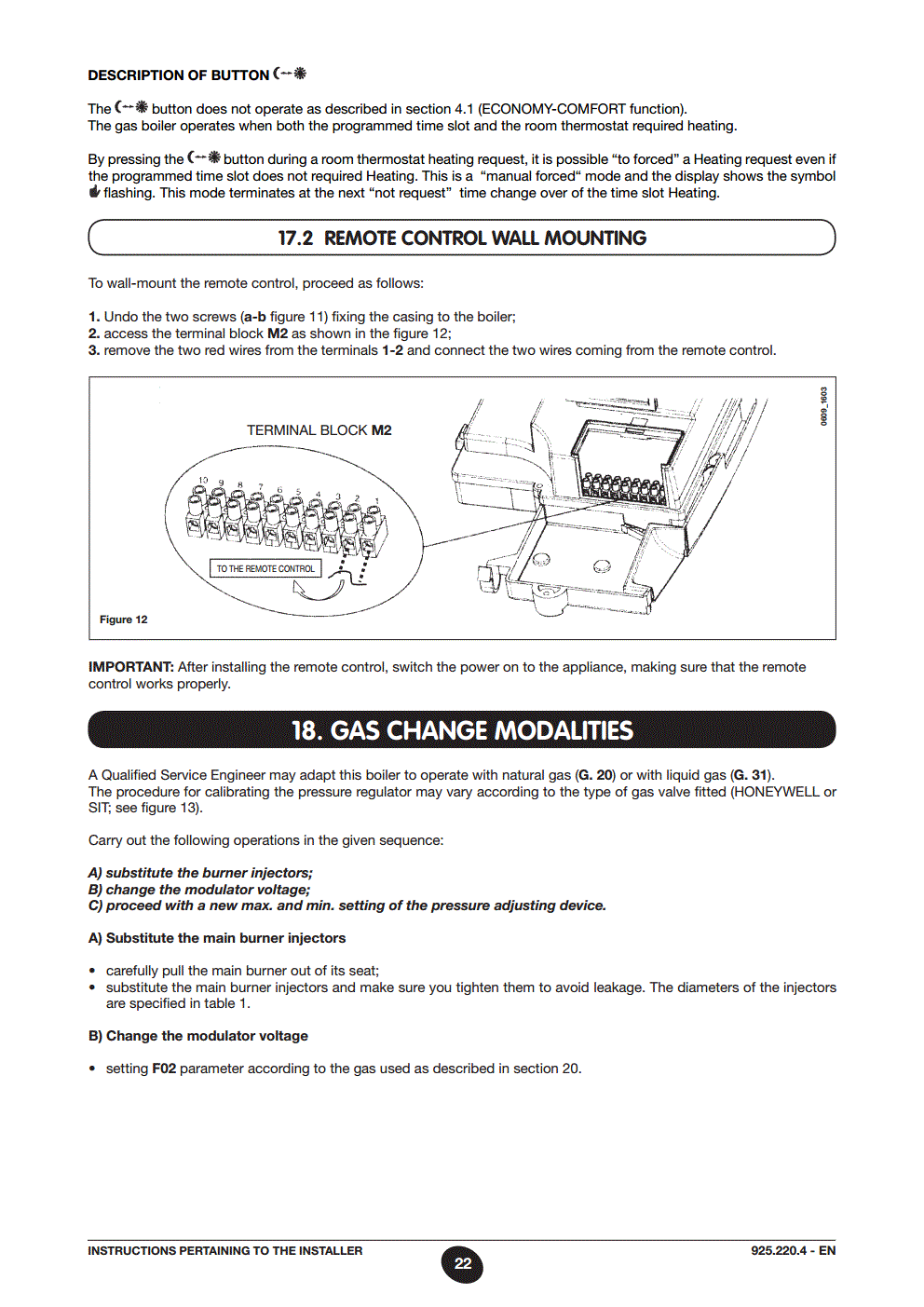

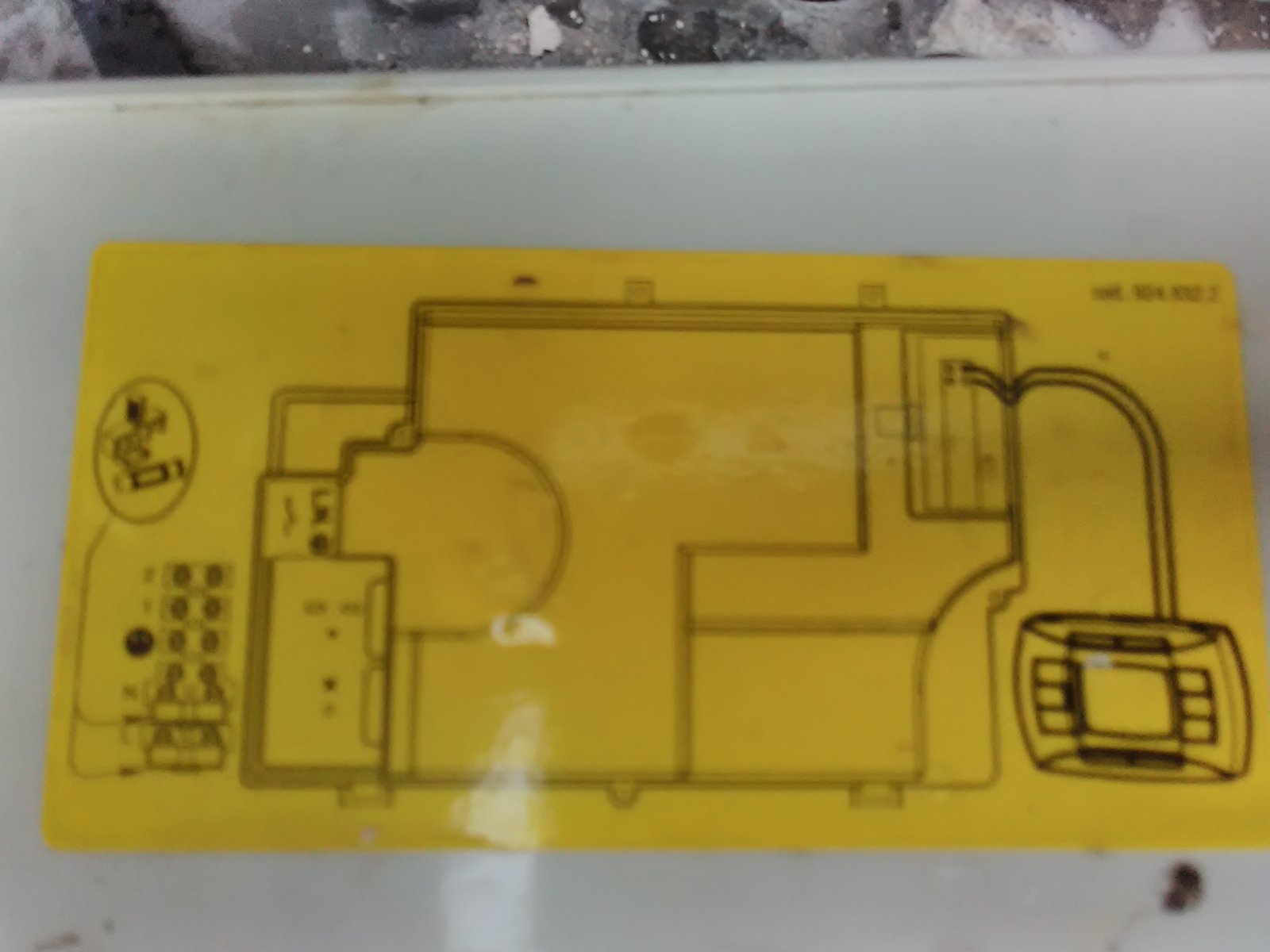

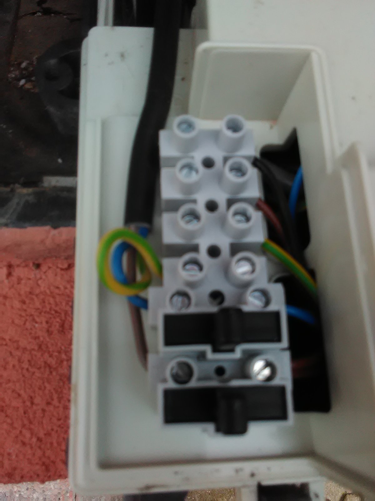

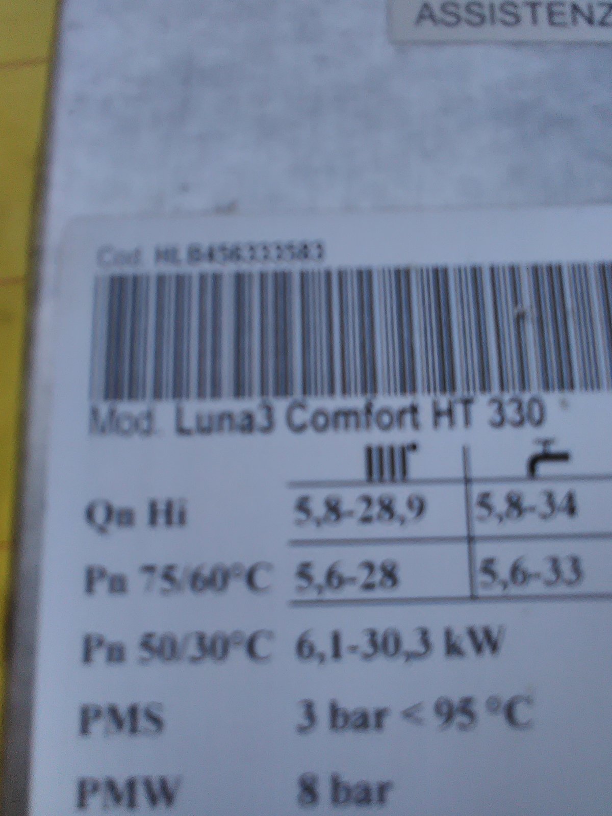

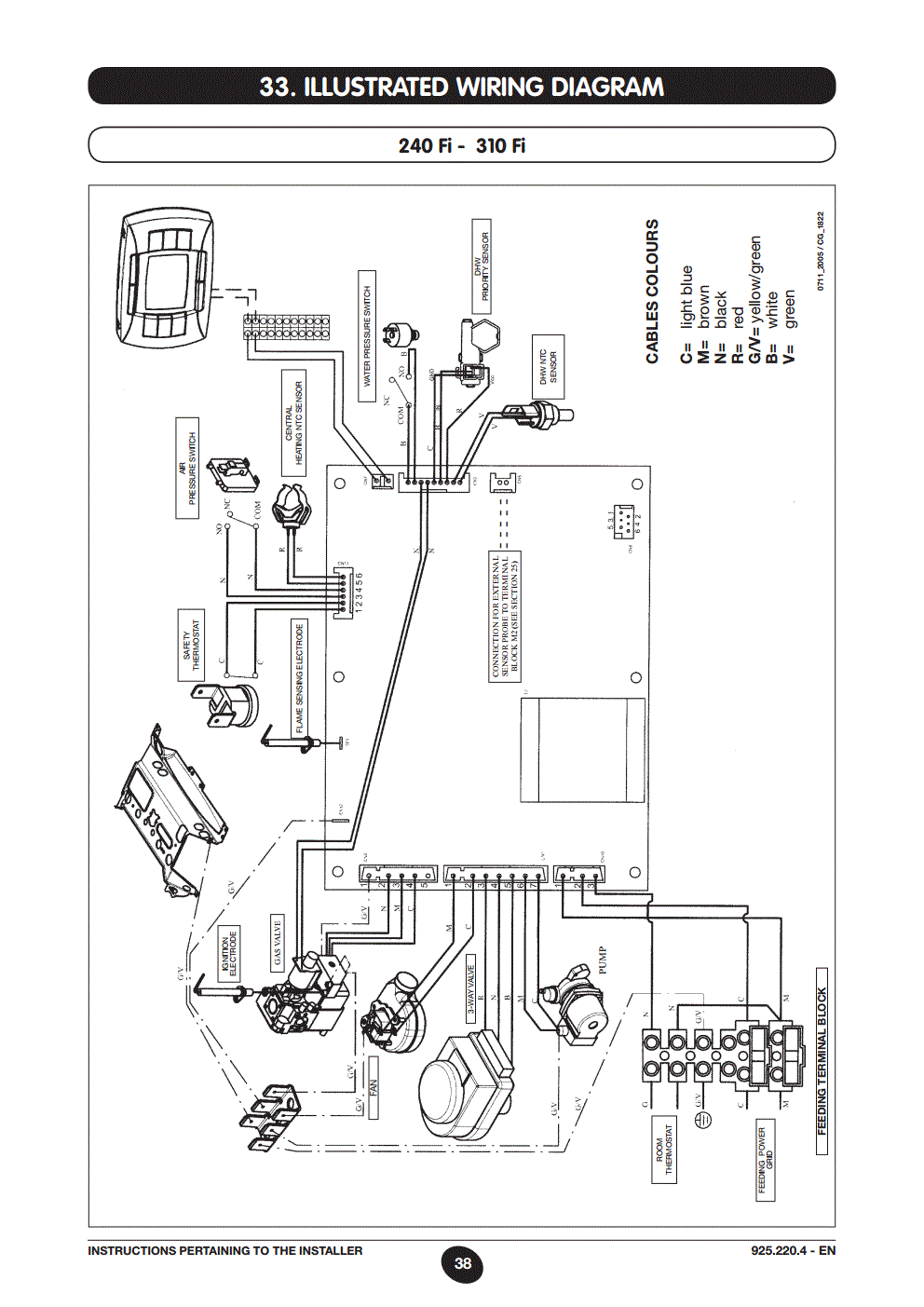

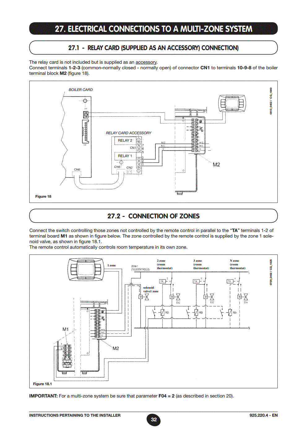

Gentlrman, a little assistance please,
Installing NEST learning thermostat on Baxi hT 330 has external wall BAXI thermostat, connected to M2 boiler connections, 1&2.
Connected Nest, using lot voltage combi, heat link connected to mains, heat link 2 & 3 back to Boiler M2 connections 1&2. T1 and T2 back to thermostat. Green light on heat link, thermostat says connected. But no heat and no hot water.
The boiler came with add on accessory board M2 for original Baxi thermostat installation.
I am thinking that maybe I should go back to boiler M1 and connect M1 thermostat connection to heat link 2 and 3. I haven't tried this yet. I am afraid to just start trying different connections, don't want to fry something.
If any one can offer some assistance as to what the correct connections from boiler to nest heat link, it would be much appreciated.

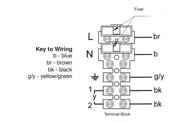

Hello Stan
I see you are in Italy so the products and methods you have may be different from what we have in the UK. However, I believe that your boiler is a combi and the wiring is as below:
In which case, there should be a permanent mains supply to the L and N, plus an earth connection. (In the UK this is from a 3A fused spur, but may be different in Italy)
I assume the yellow link shown between 1 & 2 above has been removed. The existing room thermostat should now be disconnected from the boiler and:
Nest (N) connects to boiler (N)
Nest (L) connects to boiler (L)
Nest (Earth) connects to boiler (Earth)
Nest (2) 'Heating Common' connects to boiler (2)
Nest (3) 'Heating call for Heat' connects to boiler (1)
You can then choose to power the Nest thermostat from a separate plug in power supply, or connecting it to Heat link terminals T1 & T2.
In the UK if it is necessary to open up a room sealed compartment to access the wiring terminals, this should only be done by suitably qualified and registered people. I don't know what regulations are in place in Italy.
If the boiler connections are different from above don't proceed.
Stem, I appreciate the assistance. Yes my boiler has the same connections. Yes it is a combi boiler, I also thought (M1) 1&2 to (Nest) 2&3 was probably correct.
I do have one other question. The M2 connection on my boiler, which was an add-on accessory in order to have the Baxi thermostat installed away from the boiler.
Just wondering, now I am connecting to the M1 thermostat connection, do I need to remove the M2 add-on connection? With it still connected to the PCB, do you think it will interfere or cause conflicts since I am connecting to M1 now? Also in the manual, when I see a thermostat connected to M1, the M2 is not present. Just wondering.
I appreciate your assistance.
Stan
Sorry I'm not familiar with the remote controls that you have now, I haven't seen them before, but you cannot have two working thermostats in circuit otherwise they will interfere with each other. It may be, that if you leave the existing controls in place and set them to maximum / permanently on, then the Nest will work.
Otherwise it seems from the instructions that tell you how to install it that it is an optional extra, so you maybe able to reverse the installation instructions to restore the boiler to its original condition. The drawings you posted show different options too. One has several zones. If you do have more than one zone each zone will need a separate Nest.
