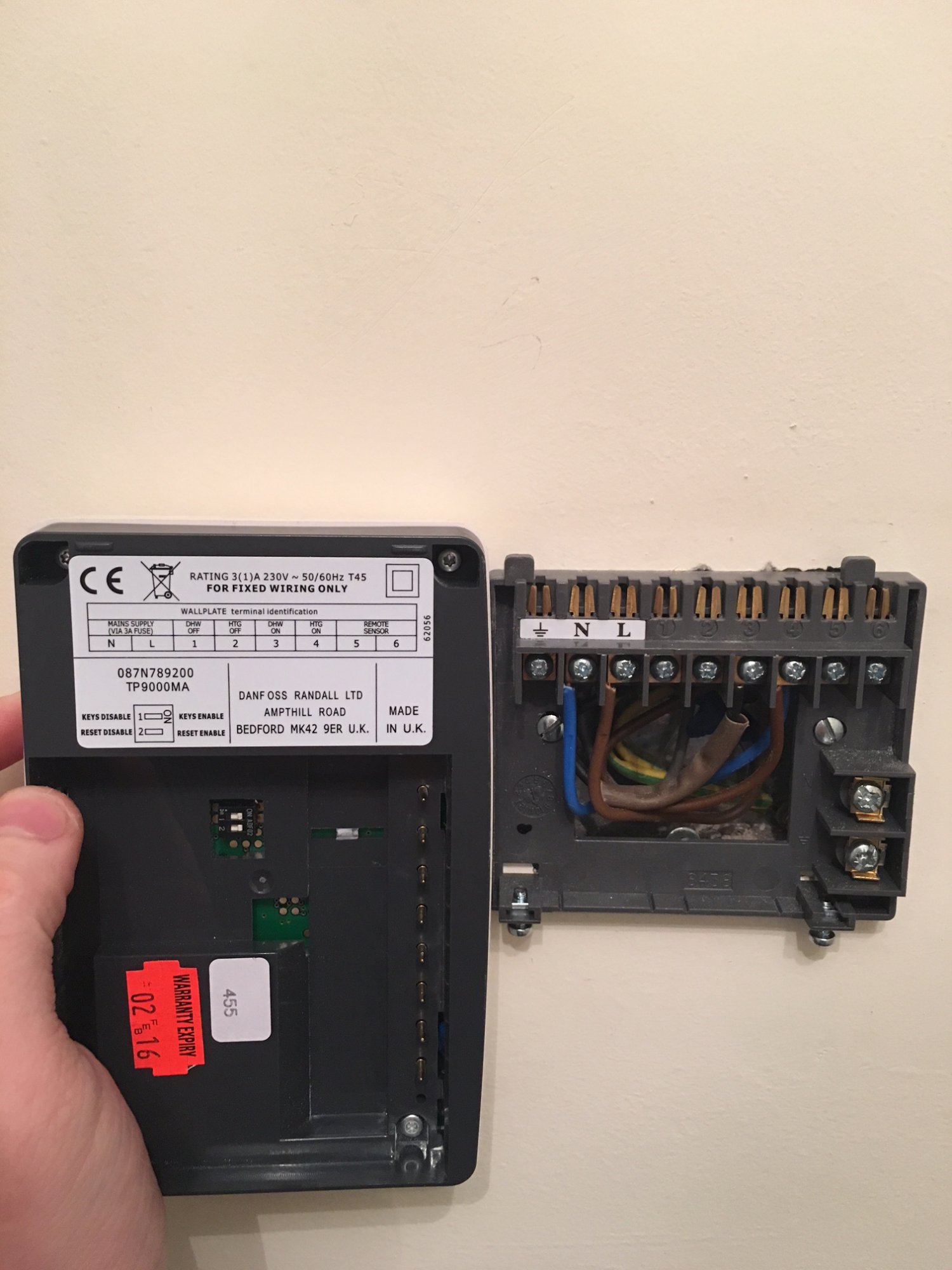

So in Z2 if I trace the two wires that go to the themostate, remove these in the MWC to use for the 12v power, and then add new wires going to the Nest Heat link where these wires were located. That should do it?
So far so good. Got the upstairs one all set up and working great! I made all the connections at the wall wiring center and didn't touch the megaflo wiring centre.
One issue I came across was once wired up the valve was working but the boiler did not fire, so I put back the old brown call for heat cable back in the choc block at the wiring center as well as the new cable going to the Nest heat link (all in the same terminal), and all worked great. Although I'm not sure why I still need that cable? Used some gray cables (they were not connected to anything in the wiring centre and just loose at the old themostate location) to carry the 12v to the main unit.
Going to do the downstairs one/HW tonight :)
Wish me luck!
Humm, downstairs didn't go as well. I managed to the the heat link clicking when turned the themostate up, but it was not triggering the valve or pump to come on. Looks likes it not getting power, so my wiring is not right.
See pic below, I take it this must use the neutral wire to bridge the call for heat circuit? Ie it connects neutral and number 4 to call for heat? So I need to find the wire that goes to 4 and the wire that goes to neutral in the wiring centre and connect the wire then went to 4 to 3 (call for heat) on the heat link and the neutral to 2 (common) on the heat link?

Yer no worries. Think I've cracked it now. Both heating zones working fine, just hot water to do. Pretty easy when you sit down and think about it.

Don't worry. I've done it. Happy days. It's really easy to be honest once you sit down, take your time and have a think. Money for old rope these 'professional' installers.
