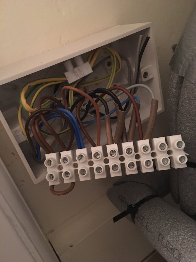

A pic of the inside of your wiring centre on your wall would be most helpful. Ignore the one inside the Megaflo. 0.75mm flex will be sufficient, you'll not get 1.5mm into Nest's tiny terminals, and it doesn't normally need to be heat resistant
A pic of the inside of your wiring centre would be most helpful. 0.75mm flex will be sufficient, you'll not get 1.5mm into Nest's tiny terminals, and it doesn't normally need to be heat resistant
Great, thanks. I'll get a pic of both wireing centres (one on the tank and one on the wall). Will 0.75mm flex be ok for the permanent L and N feed to the nest heat link?

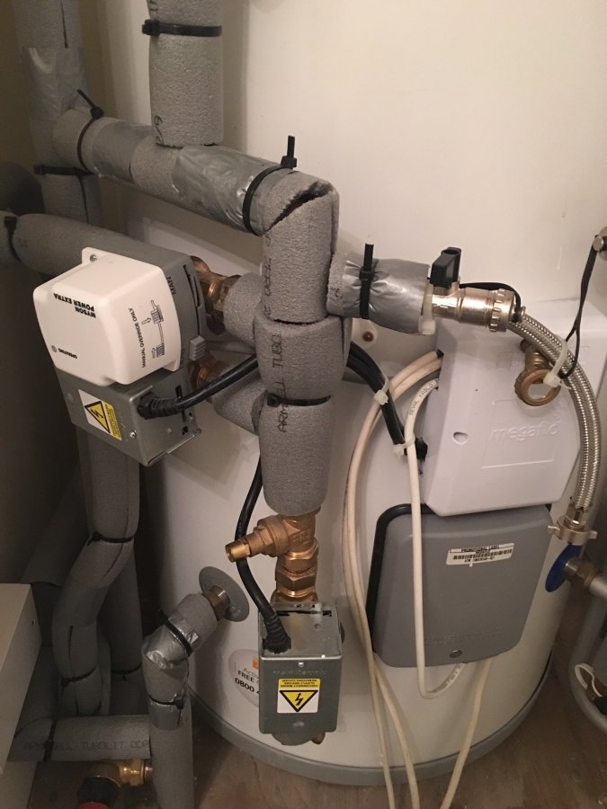

Valves (the white one is upstairs/zone 2, and the one under that is downstairs/zone 1. The lower one is hot water): https://www.dropbox.com/s/4h91sukxoe15fav/valves.JPG?dl=0

Wall wiring centre: https://www.dropbox.com/s/y5dhp4xiygffltf/wireing centra.JPG?dl=0
Wall wiring centre (pulled out/up-close):https://www.dropbox.com/s/jpjmn3ij17gcdw7/wc upcloase.JPG?dl=0

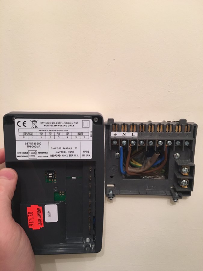

Downstairs (zone 1 and hot water) thermostat/programmer:https://www.dropbox.com/s/i4uprzzcbm15kte/downstares.JPG?dl=0

So, what next then?! What do I need to do to do to install the Nest's? One thing I've noticed is the wall wiring centre does not have any holes/knockouts (it all comes from the back of it through the wall), so I might have to drill a hole in the front cover for the Nest heatlink wiring?

OK, looking at your pics the Megaflo wiring centre week be most useful here. No idea what the other one does, you'd need to use your multimeter to find out
May as well do it all in one go rather than half now and half later. Start by turning off the power. Join the black and brown cables going into the Z2 Danfoss thermostat together, then do a continuity test between browns and blacks in the wiring centres until you think you've found them. Also test through to see if they join into the Megaflo WC if they join at the wall WC. Mark them, disconnect at the stat end, test at the WC end to ensure disconnection then remove those two wires from the WC, ensuring that they are fully isolated. Rejoin at the stat end and repeat continuity test to check you really have got the right ones. You'll use these later to power Nest.
Repeat the above for Z1 Danfoss, additionally positively ID the live and neutral in the WC and disconnect and trim back at both ends
Nest heat links will both need permanent live and neutral into the L and N terminals. Earth to Earth. Link L to 2 & 5. In your downstairs Nest HL, connect 3 to MWC 6 and and HL 6 to MWC 7. In upstairs HL, connect HL 3 to MWC 11
Fit thermostats and wire in. Connect T1 and T2 to their respective terminals on the HLs
Assuming everything is wired as per the diagram, it should all now work

Yes, but you'll need to check what the one in your wall does
