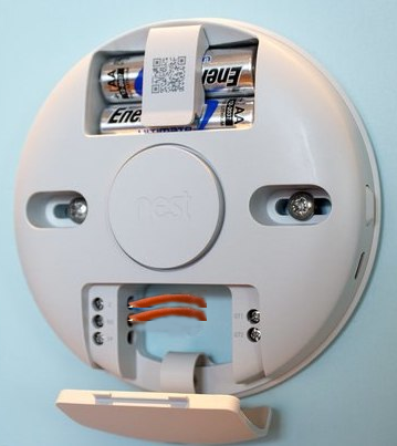

I installed the Nest Thermostat E, all went well until I turned it on. As soon as the power goes on, it trips the RCD unless the boiler breaker is off.
I have an all electric heating setup, the Nest only controls heating, not hot water. The Heatlink replaced a Honeywell 6360 thermostat which was wired as shown below. I connected the wire in the No. 1 terminal to the C terminal on the Heatlink, the wire in the No. 3 terminal to the NO Heatlink terminal and capped the wire in the No. 2 terminal - it's not connected to anything on the Heatlink. This was based on the guidance in the Nest app as I installed it, which also agreed with the Nest support site.
There was an earth wire in the wall behind it which wasn't attached to anything so I capped that too just to be safe. My understanding is that it's just a switch between the C and NO poles, so I don't understand why the breaker trips.

I really don't understand why Nest E should trip out a RCD there is no earth connected to Nest E and no neutral, 2 one with blue sleeve I have checked and should be neutral to the resistor and you say not connected, so there is nothing you say you have done which should trip a RCD.

This is the Nest Heatlink wiring.
Behind that, the blue sleeved wire in the initial image is capped, and the random earth wire is also capped (separately).

Nest wiring has 5 connections, two are for OpenTherm and not used, neither is bottom terminal so this
is all we have connected. And is what it should look like.

Did you try returning to old thermostat? I think if you return to old one it will still trip?
Ericmark, you are correct. I took the thermostat off, capped all the wires and it still trips. Replaced the old Honeywell and it trips as well. As soon as the boiler circuit is engaged, the RCD pops. The good news is that it's now my landlord's problem. The bad news is that I have no heating until they get hold of someone.

The electrician came out and discovered that the motorised valve is leaking which is causing a short. It was replaced last December when I moved in here because the heating wasn't working and the original one had failed. Is it likely that connecting the Heatlink caused that fault somehow?
It seems weird that it was working just fine until I wired up the Heatlink.
