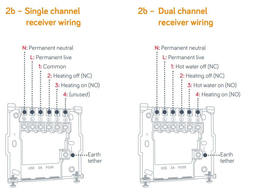

The problem is the boiler turns on but seems to not respond to the Hive, most of the time the burner just stays on but will periodically turn off for no apparent reason.
My Ideal Logic Heat 12 only has 2 cables, Heating on (NO) and Hot Water on (NO) but neither of the diagrams on the Hive installation manual seem to match my situation. I don't appear to have Heating off (NC) or Hot Water off(NC)

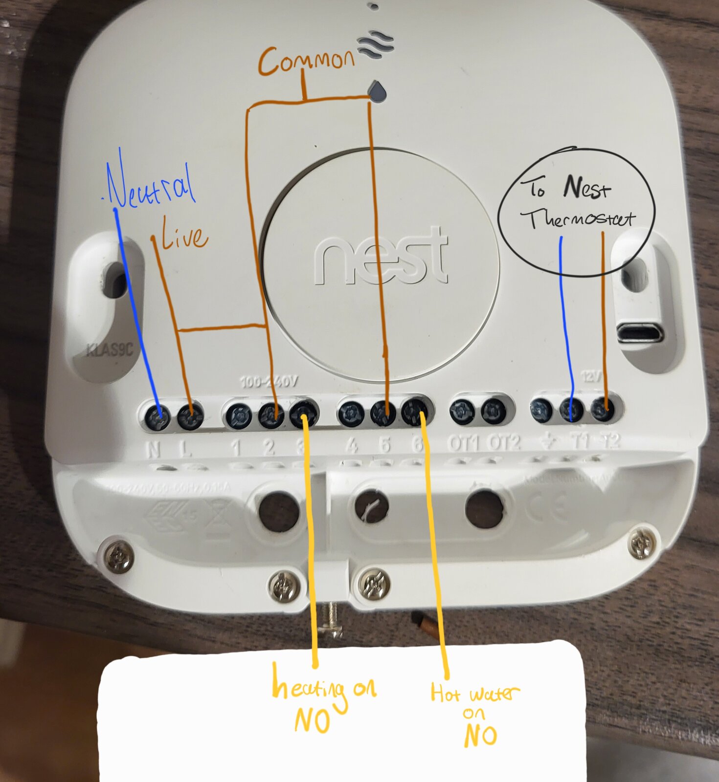

My Nest, which did work for a while was wired in as follows:
And although it was flakey it did work for a year pretty well.

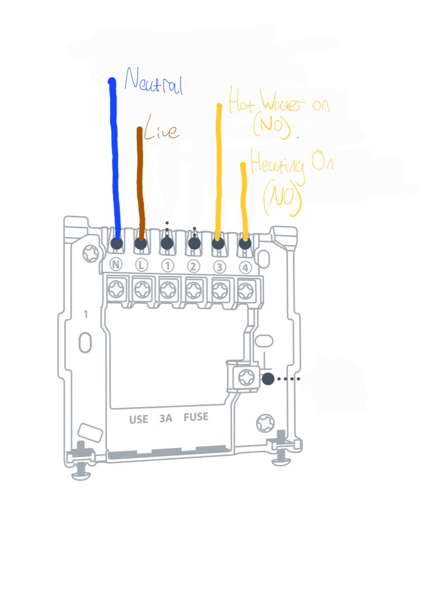

The Hive is currently wired in as follows:
But the burner comes on as soon as the boiler turns on, and it stays on almost all the time.
I have no idea what I need to do to sort it out. I don't even know if I need to call a plumber or an electrician.
Does anyone have any ideas or knowledge that might help me here?

What did you do with the Nest thermostat wires, T1 and T2?

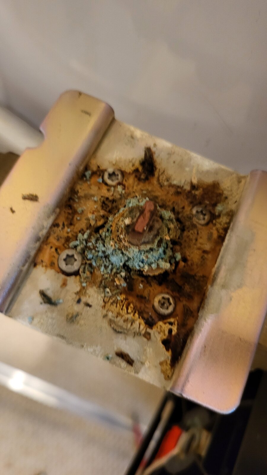

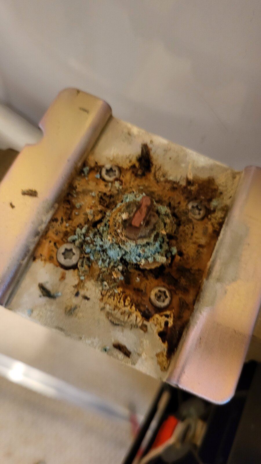

Yeah it's a Danfoss HPA2 and the actuator has gone.
Yeah it's a Danfoss HPA2 and the actuator has gone, new one from plumbase is about 55 quid. It does look like the valve itself may have leaked a tiny bit as there was corrosion around the copper valve under the actuator. I might get somone in the change the whole valve at some point but I'll test with just the head replacement.
This is what it looked like under the head. I've cleaned it right up but every time I twist the valve the tiniest bit of liquid appears around the valve
Based on that I’d change the lot
That's the plan, just need to wait until payday before I can get a plumber round to do it. Changing the valve is a little beyond my skill set. I wouldn't know how to get the water out the system to do the work
