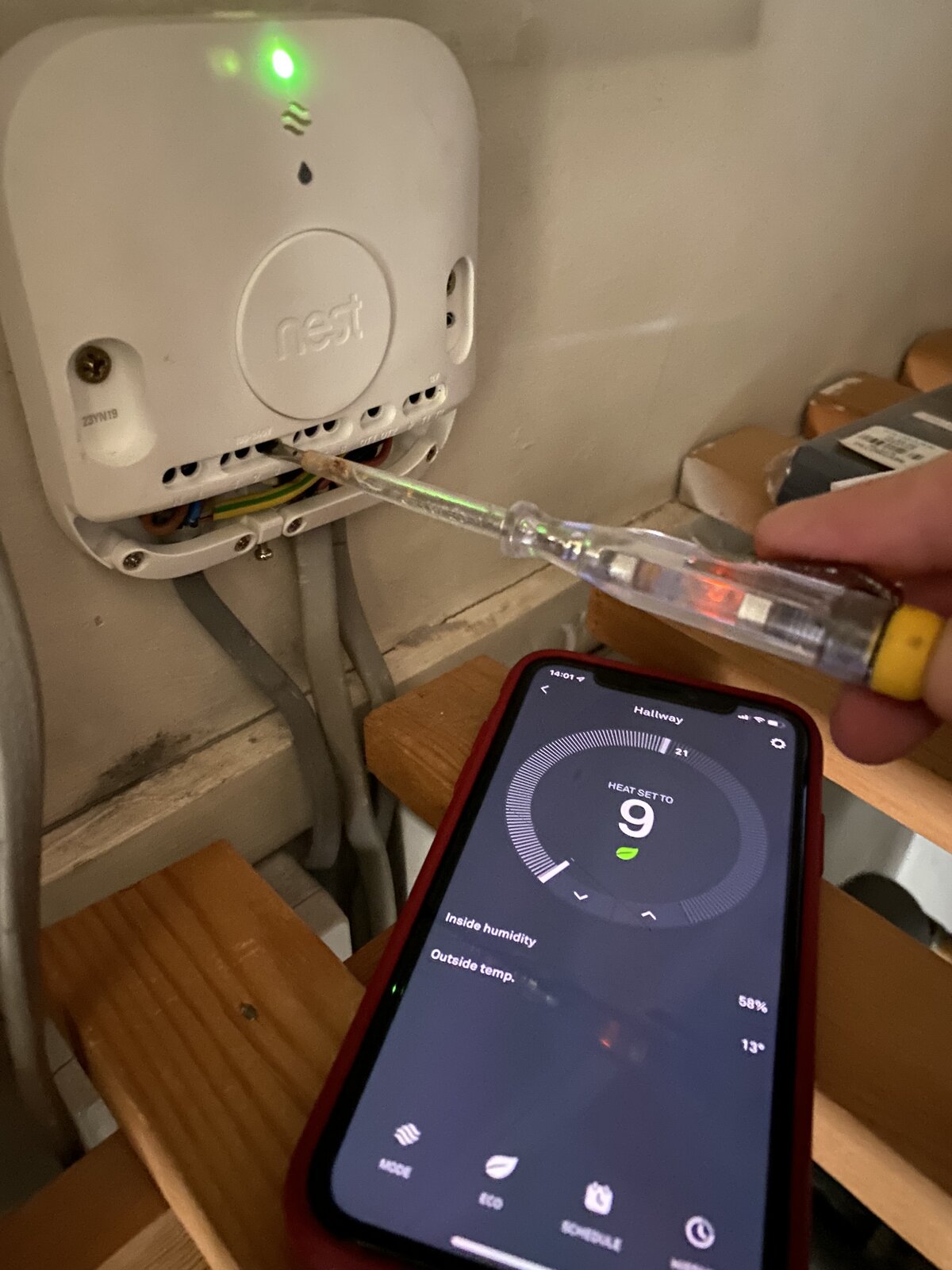

I have a Nest 3rd Generation heatlink and thermostat which is connected to a y plan system that includes a Baxi solo boiler, grundfos pump and a Drayton mid point actuator all wired as labelled through a Drayton LWC1.
My issue is that regardless of what I do the heating is on. The thermostat is wired with two wires out of the T1 and T2 terminals and is on but the heating ring has no effect on the heating. If I turn the fuse on the pump immediately fires up and the heating comes on. If I boost or schedule the hot water to come on it moves the mid point actuator to the middle (which isn't labelled but I suspect is for HW and CH).
Then if I stop the schedule or boost for HW the pump switches off and then fires straight back up continually for the CH.

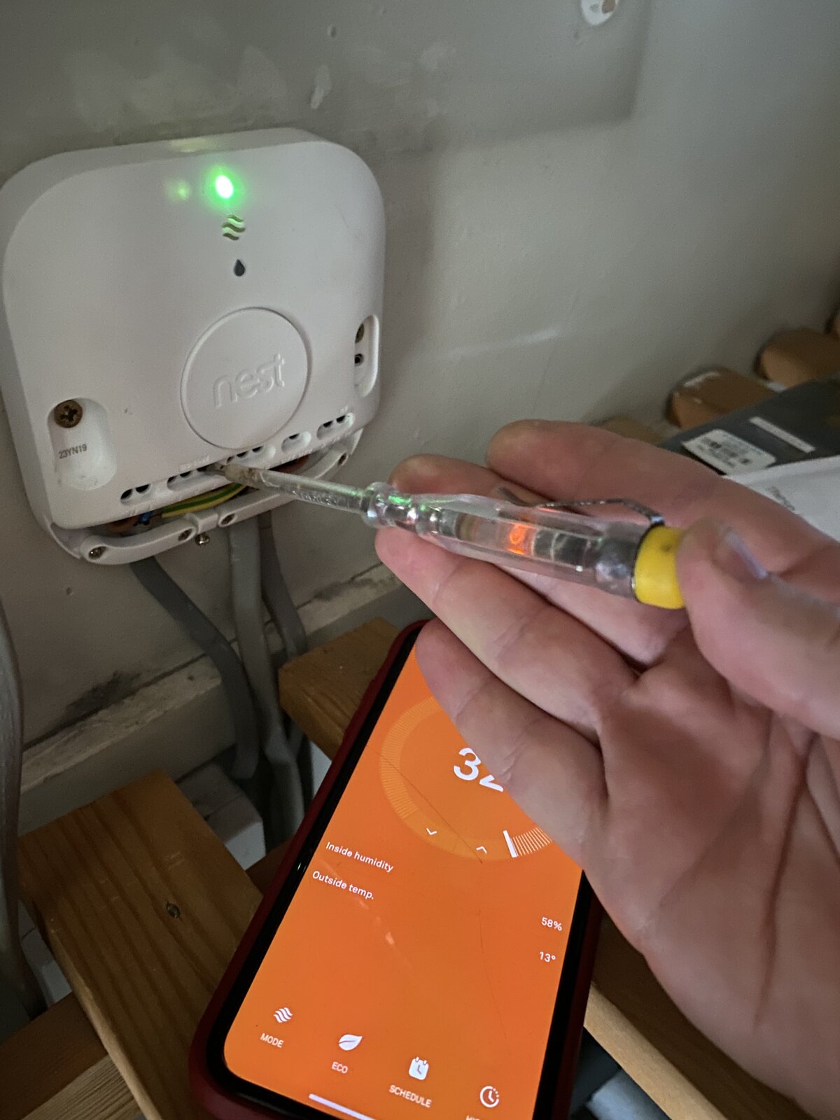

I have tried all sorts to fix this and the problem I think comes from the heat link. The terminal for 3 'Heating Relay Normally Open' is continually live regardless of what the temp is set at in the app or if it turn the system off and on manually. I hear the click of the relay but the live doesn't change. To my mind the heatlink is constantly asking for heat?? I may be wrong.
Any help is more than appreciated.
You are correct that terminal 3 should only be Live when heating is called for.
I would be inclined to temporarily disconnect the wire from that terminal and then see if the heating remains On or goes Off.
It’s possible there is a wiring problem somewhere and the wire you remove from heat link #3 may still be getting a permanent Live from elsewhere.
Pictures of the heatlink showing live on terminal 3

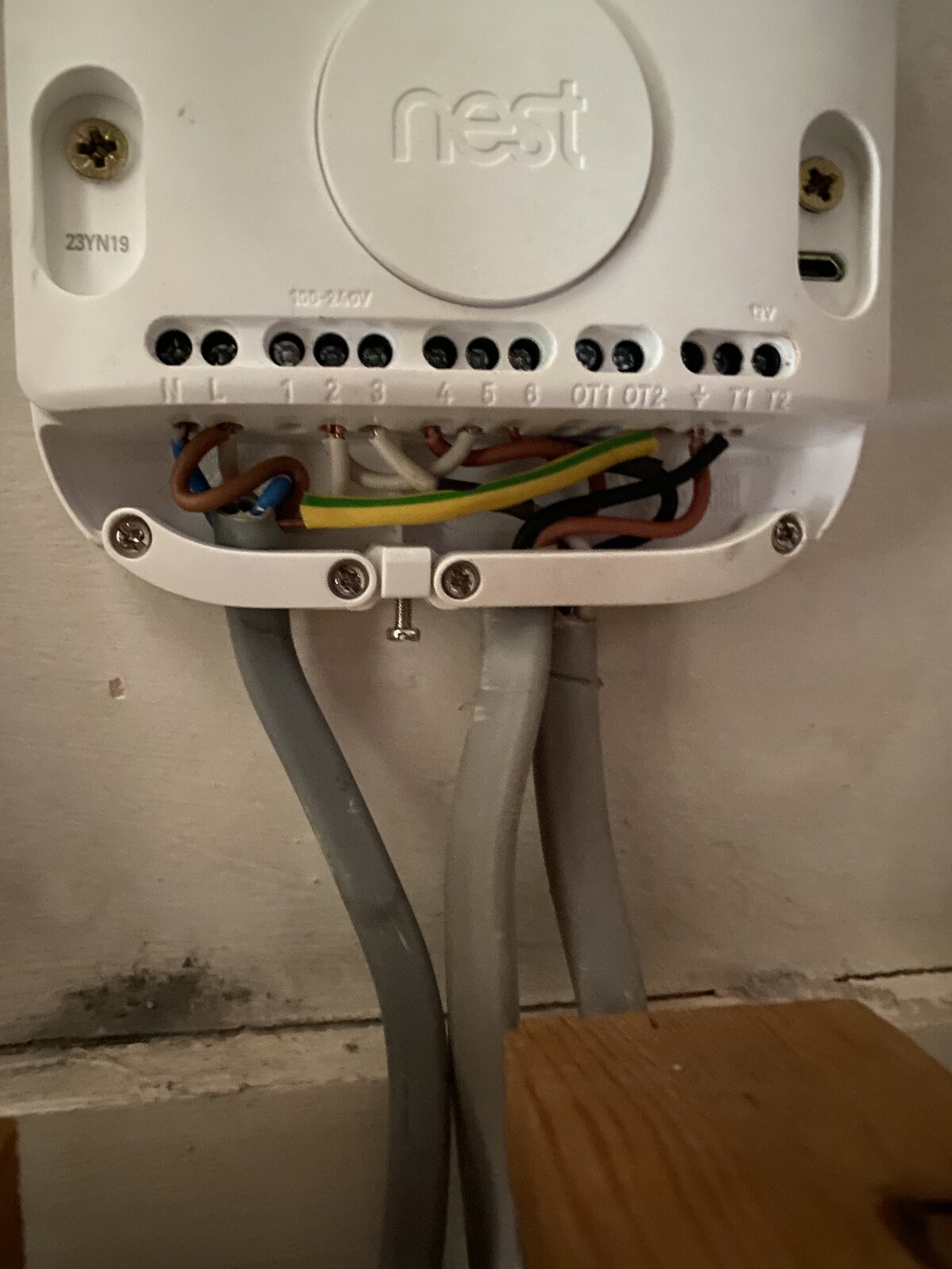

Heat Link Wiring
If the Heatlink terminal 3 is still permanently Live with its wire removed the problem is with the Nest itself.

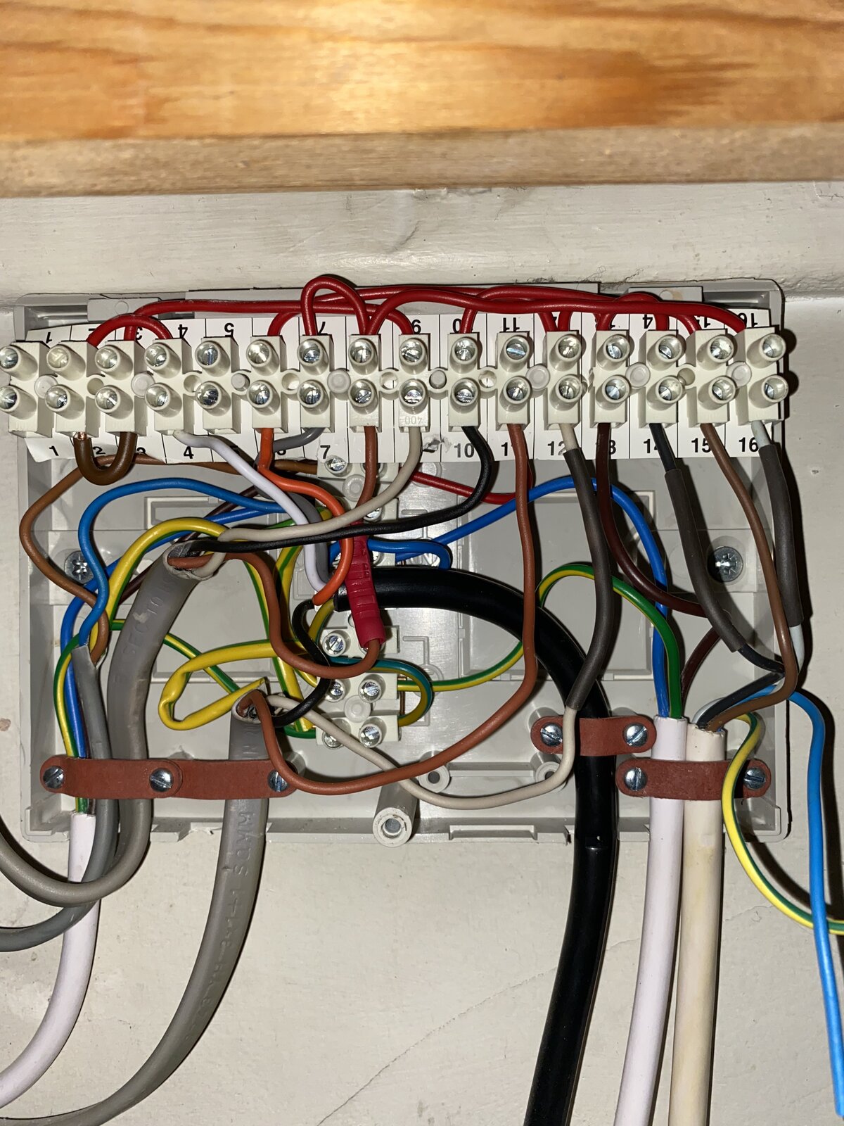

3 comes from the white wire from your 3 port, have you checked this? Can you post photos of wiring center?
The wiring centre,
1 = Empty
2 = Links with 3 to remove the old thermostat
3 = As above
4 = Goes to the actuator - white wire
5 =Empty
6 = Goes to the actuator - Orange wire
7 = Goes to the actuator - Grey Wire
8 = Hot water off goes to terminal 4 on the Heatlink
9 = Central Heating On goes to terminal 3 on the heatlink
10 = Hot water on goes to terminal 6 on the heatlink
11 = Boiler L Goes off to the boiler
12 = Boiler switched live.Goes off to the boiler
13 = Pump live. Goes off to the pump
14 = Cylinder wire.
15 = Cylinder wire.
16 = Cylinder wire.

Having followed the wiring centre connections, the live to the motorised valve white wire (Heating On) does come directly from the Heat link terminal 3 as it should, albeit via a rather tortuous route:
HL 3 -> WC 9 -> WC 3 -> WC 2 -> WC 4 -> MV white wire
I can't see another wire connected to any of these terminals from anywhere else that could introduce a rogue live, so as has already been said, try removing the grey wire from HL 3. If the heating doesn't come on with the wire removed, there is a problem with the HL. If it doesn't, the only other possibility I can think of is that there is a wiring fault inside the motorised valve that is somehow introducing a live on the white wire from one of the other wires internally.
Based on your photo and descriptions, the rest of the connections at the wiring centre are as I would expect them to be. However, I notice that the wire you describe as "Boiler L" [in WC 11] isn't actually connected to anything, which could be OK; older Baxi Solo's certainly should have a permanent L, but maybe your model doesn't. In any event, it wouldn't produce the symptoms you describe.

If I remove 3 from the heatlink the heating doesn't come on and I can control the hot water.

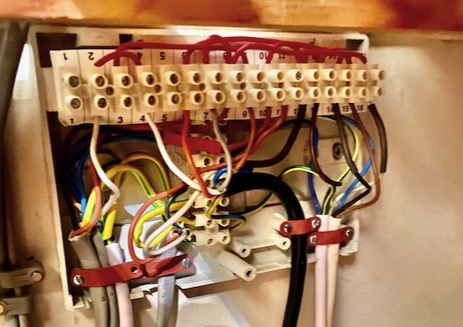

I will post a photo taken before I began doing anything
Then the problem is with the Heat link. Terminal 3 should only be made live when the Nest tells it to switch the heating on.

On this photo, the crimped wire is going to number 10 in WC, yet number 6 on other photos?
