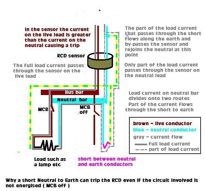

Immersion heater (IH) connected to Neutral-Earth fault.
I installed a new one (Backer 314C, 3kW), ran for an hour then RCD tripped and would not re-engage. The previous one ran for 2 weeks then the RCD became un-engageable.
The RCD is a 300mA one protecting the whole property (detached villa).
When switched on, the RCD trips (usually immediately, but sometimes taking a few seconds).
If I bypass the original wiring and connect the IH to a 13A socket running off a different circuit from a different subDB, protected by a 30mA RCBO, that RCBO trips.
That happens even if the live is disconnected at the IH, and all 3 phases are disconnected at their isolators (there is a main DB and many subDBs), and all neutrals in the main DB are disconnected except the supply and the one serving the affected DB. That is: there is no load anywhere in the property (hence no means therein of raising the potential of the neutral), and the only connections running from the meter box to the 30mA RCBO are neutral and earth.
(the MCBs alongside the 30mA RCBO are all off)
Further info:
The system is TT or TN-S or TN-C-S (uncertain because there is an earth rod in the ground in the meter box, and the SWA supply is 4-core (no CPC core) and I don't know how the armour is connected upstream). Other villas in the development have similar supplies but don't have this N-E issue.
There is 1.6V across N-E at the IH (less in the meter box), presumably arising from loads upstream in other villas. For 1.6V to trip a 30mA RCBO, a resistance/impedance of 53 Ohm or less is needed. I can test the resistance of the IH N-E only with a basic multimeter, not a Megger; I get open circuit, ie. inconclusive. But this IH is only a day old. It seems soo unlikely that it would develop a N-E fault so quickly.
(other IH resistances: L-E infinite, L-N 19 Ohm (correct))

Bernard,
Thanks; good diagram and annotations.
Doesn't apply here, though, because there are no energized loads anywhere in the premises. All 3 phases are isolated at a bunch of 3-pole isolators (one per subDB) in the main DB. The only voltage is the 1.6-ish Volts on the neutral.
Bernard's diagram is a good demonstration of the principle of RCD tripping during an E & N fault, but this is only good if the load it switched on, and drawing current, where the return current then splits between Earth and Neutral during E - N fault (shorting ) However, if you had other loads running from that RCD protected power, and if you were looking at your IH, which had been isolated on the live only (i.e. removing a fuse from the live feed but leaving neutral still connected) (both poles not isolated) and if you had a Neutral still connected, and there was an earth fault on that IH element, it would then trip the RCD because the return current from other loads (appliances) in use would be lower as some of it will pass through this IH fault directly via the earth thus bypassing some of the current returning through the RCD's Neutral sensor coil.

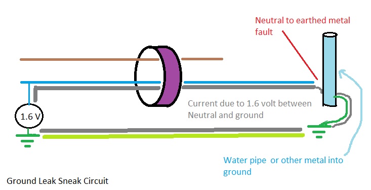

This may be the mechanism, a fault Neutral to pipe work or other metal work that has a connection to the ground
Bernard, yes that is strong possibility he should check what type of earthing system there is apart from a ground rod that he said was there, really needs to check if the armoured cable earth is tied to N at the DB as well or not.
