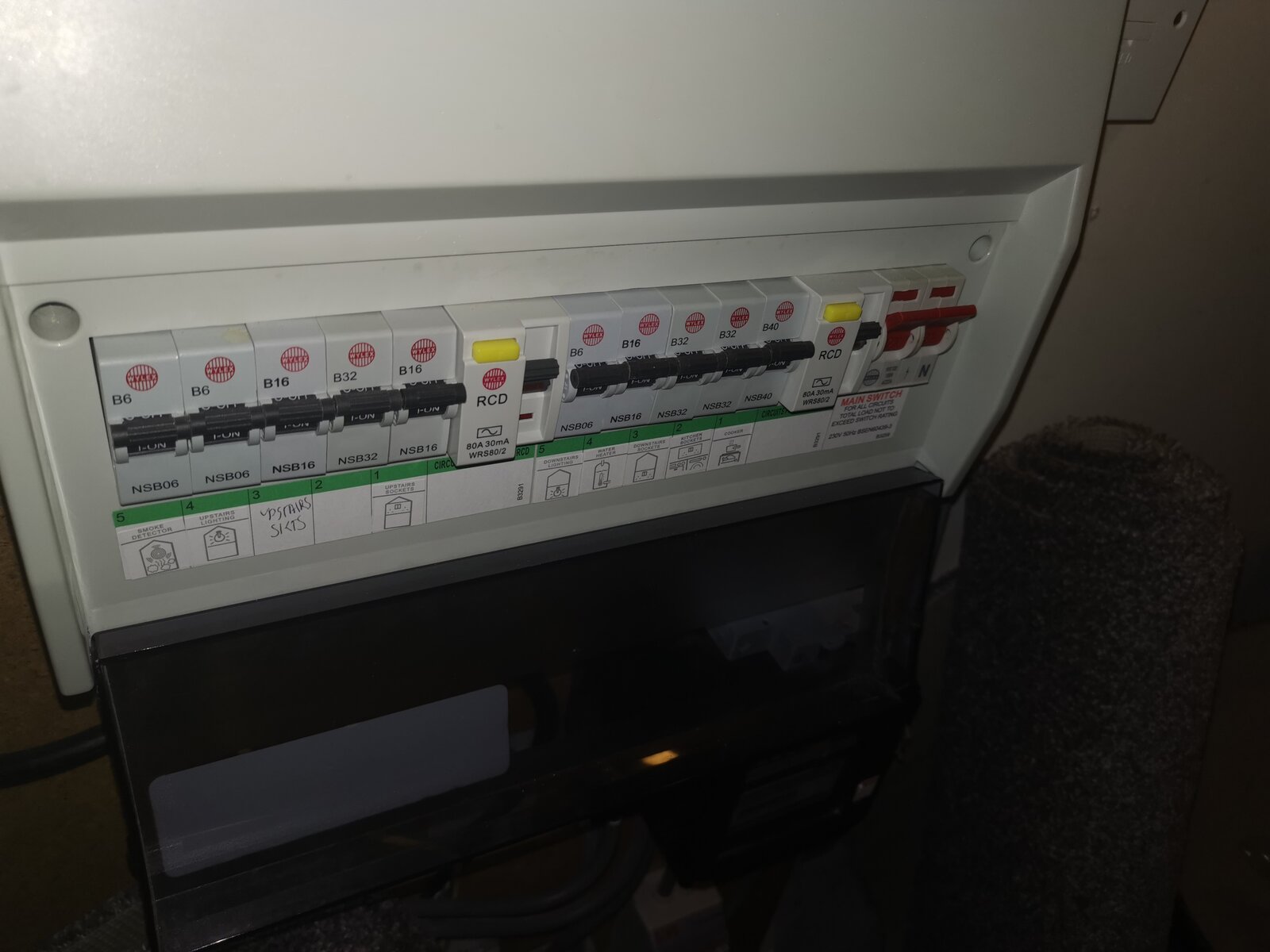

Ive removed the plug socket and the cable is a lot thicker than 2.5mm looks like 4mm at least and it's being fed from a switched cooker socket switch but doesn't show a fuse on the front face and that's controlled from the CU with a 40amp NSB40.
I've checked the kitchen circuits by isolating at the CU and confirmed that the oven supply is on its own circuit. The hob is a 6 gas burner hob with ignition, however this comes off the kitchen sockets circuit and not the oven circuit.

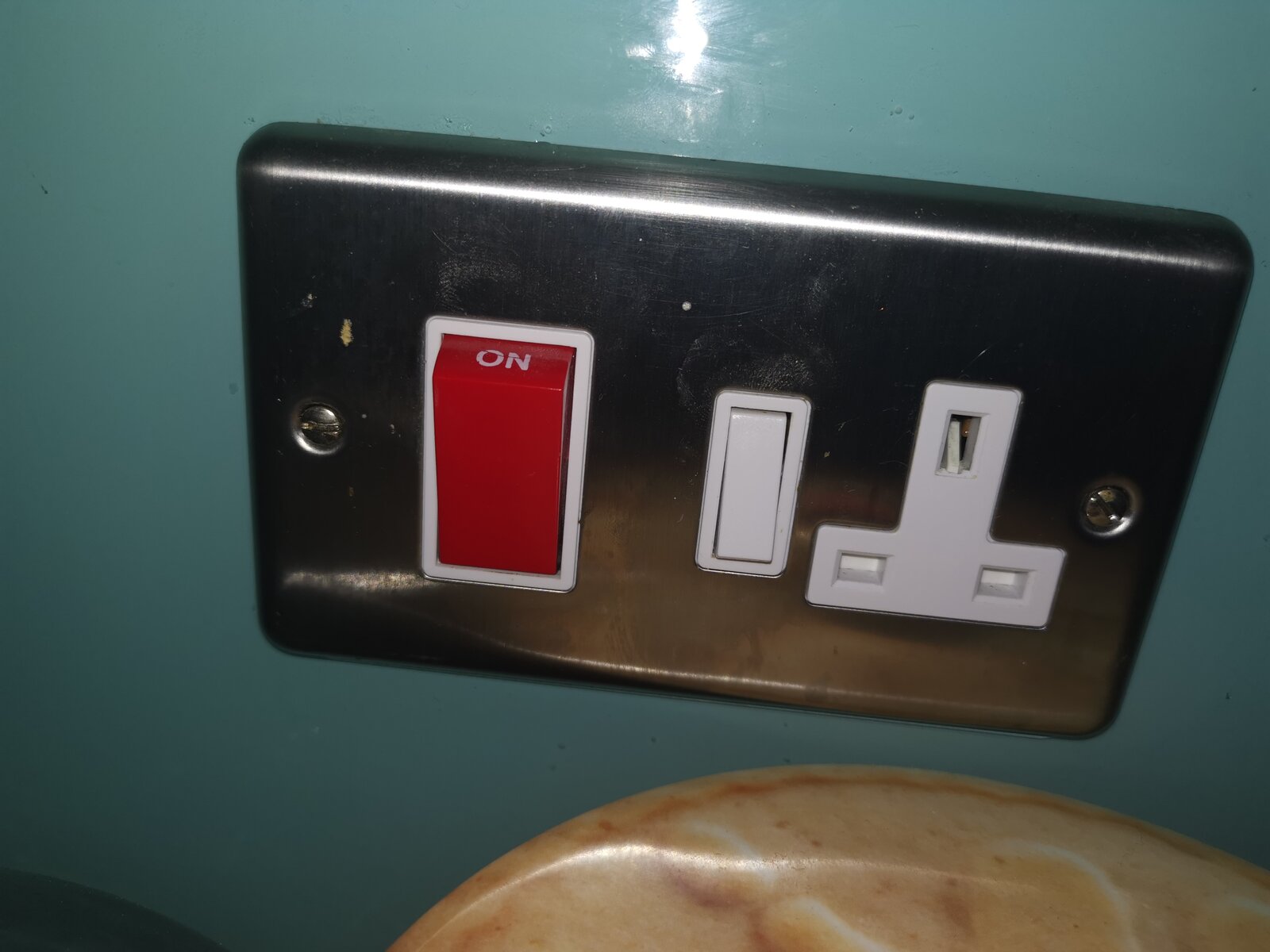

I was thinking swapping out the plug socket behind the oven with a fused spur? As the 'cooker isolation switch' doesn't show any fused part on the face plate?
The cooker switch looks like one of these but in metal?

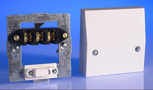

Forget about (so-called) Fused Spur - Fused Connection Unit.
I don't know why you think that would be suitable.
You need one of these instead of the socket:
https://www.screwfix.com/search?search=cooker+outlet+plate
There is no need for a fuse in the kitchen.
If the cable is 4mm² then the MCB should be 32A - but the 40A might be alright for an oven.
If it is 6mm² which is normal for cooker circuits then the 40A is alright.
The instructions also state:
"ELECTRICAL INSTALLATION: This product requires professional installation to a dedicated cooker circuit (identified by a big red cooker switch) by a qualified installer, such as one of our Team Knowhow experts."
From experience, I am not sure that applies to Currys who will only do it if it matches their tick-list.
The oven is stated as 5.9kW which is 25A but you must add 5A for the socket at the switch so 30A which is fine for what you have.
A view of a Cooker Outlet Plate; it just screws to the back box instead of the socket:

Here are photos of the cooker switch and that feeds the double socket behind where the oven is going.
The cable from the back of the socket was bigger than 2.5mm and I thought 4mm but 'maybe' 6mm as the photo below shows the cooker circuit rated at 40amps...

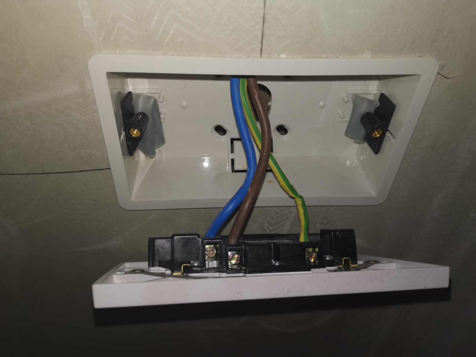

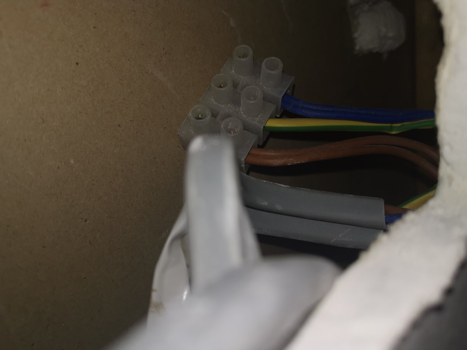

Edit ive just taken the drywall socket backbox out and pulled some cable through to see if I can find anything on the sheath.
Its difficult to read but looks like this
Basec 080 BS 6004 6242 Y H 2 x 6 (or maybe a 5??) + 2.5 SOMM PX 93
I don't think they do 5mm cable therefore must be a 6mm?

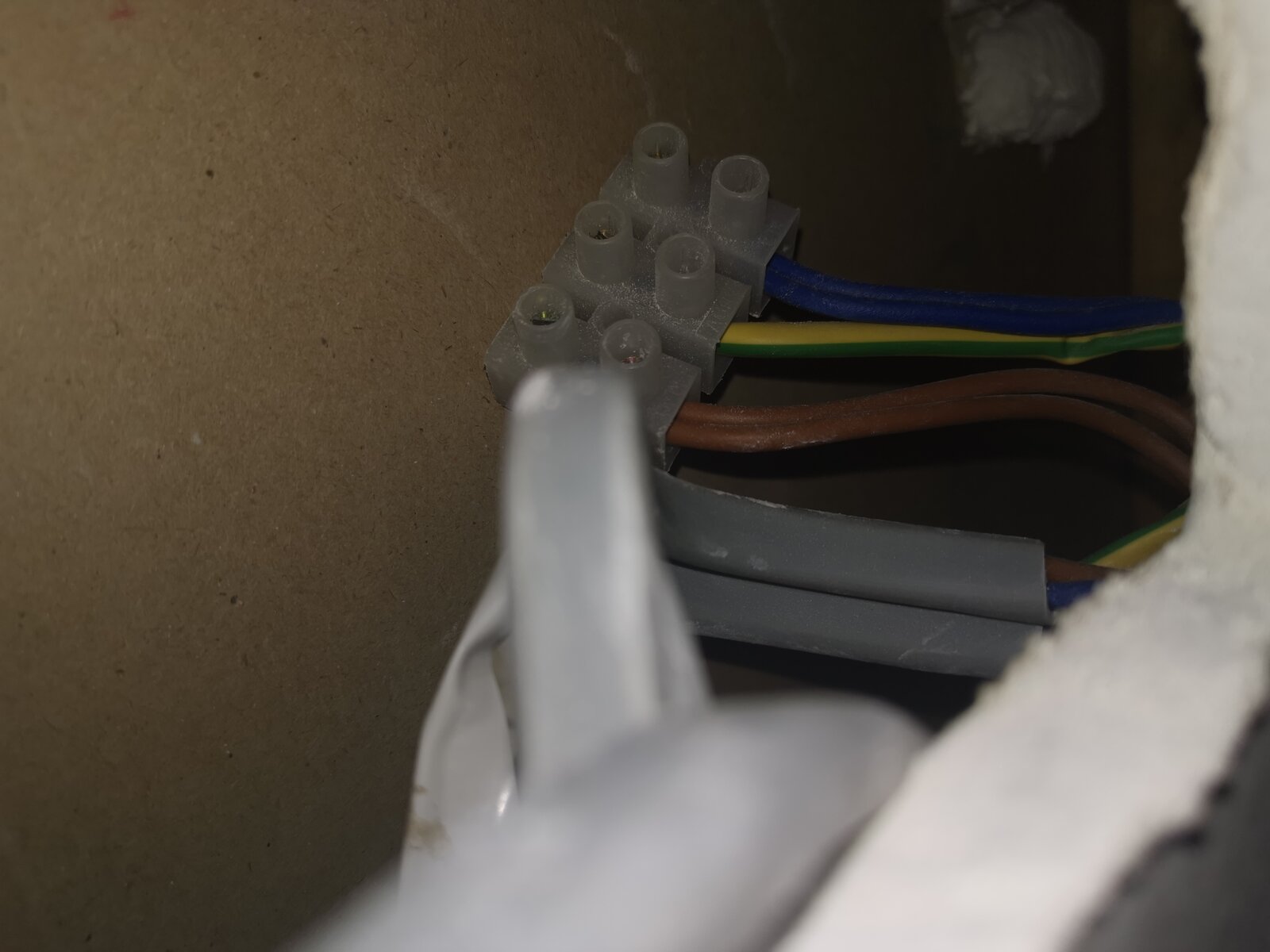

Also found this inside the drywall...... Picture below, looks like they run short and extended with a terminal block.... Might use some WAGO connectors on there instead to make it more secure?

Hi Mate i won't be able to use the socket as it will be behind the oven do they do those cooker plates in two gang sizes to save me having to install a new backbox?
A Cooker Outlet and blank plate, then.

Hi mate it's the cable leading to the double plug socket for the oven, I took the drywall backbox out of the wall to pull the cable through to check the size and I found that terminal block in the wall. Therefore I'm thinking of using a Wago terminal block and termination box to make it more secure?
Edit Ive just checked the continuity and that terminal block isn't feeding the oven must be kitchen circuit sockets..... Will check further tonight.

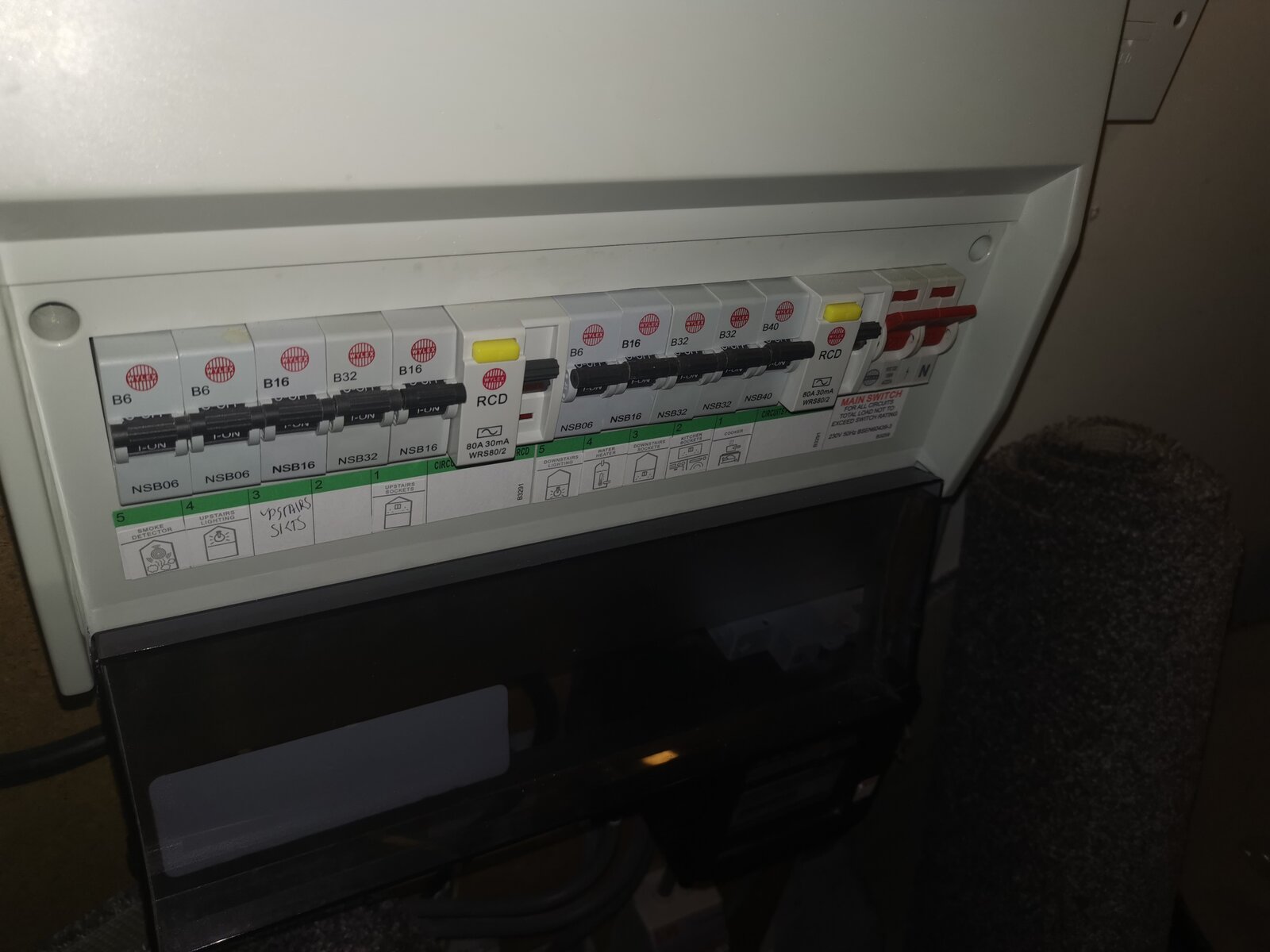

Hi All I've just purchased some 6mm heat resistant flexible cable HO7RNF.
Whilst in the wholesalers I got speaking to an electrician and when I said it has a 40amp MCB on the 6mm oven circuit he said it should be 32amp as they changed the regs about 8 years ago as it could catch fire?
Do I therefore now need to replace the MCB from 40 to 32amp?

If those cables will reach the back box and you fit the dual backbox which allows two single gang accessories, then you could fit the Cooker Outlet and -
either join the cables in the backbox and fit a blank plate, OR -
if it is the socket circuit, fit a socket which you do not have to use.
