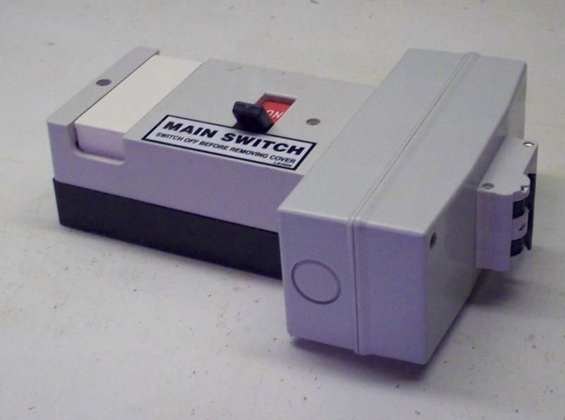

If by "sideways" you mean with the MCB not facing you - i.e. with the DIN rail it's on at right angles to the plane of the wall, (the MCB could still be vertical) then I think a 2-module enclosure would be shallower than a KMF 800.
Yes, that's what I meant, and yes, if one did that, I'm sure that a 1-module (or probably even 2-module) enclosure for the MCBs would be shallower than a KMF800. However, I'm not aware of any such enclosures being available off-the-shelf, and if one was going to manufacture/improvise one, one would have to give some consideration to the amount of air circulation/ventilation required around the MCB. If one used a standard off-the-shelf 2-module enclosure and mounted it sideways (with MCBs facing to left or right), I think it would probably be appreciably deeper than a KMF800.
However, conceptually, 'sideways MCBs' would seem to be a viable idea.
http://www.tlc-direct.co.uk/Products/BHCT2.html
As I said, "I suspect that they may detract to some extent from the small overall size of the KMF800, which is its main attraction". A pair of those things would considerably increase the footprint.
Kind Regards, John
... If one used a standard off-the-shelf 2-module enclosure and mounted it sideways (with MCBs facing to left or right), I think it would probably be appreciably deeper than a KMF800
I have to concede - it's not 'appreciably deeper'. In fact, if one includes the switch of the KMF800, the enclosure is actually less deep:
A 1-module enclosure, if it existed (never seen one) would obviously be far less deep.
Kind Regards, John

The one BAS linked to is 49mm wide (or deep, depending on which way you land it). The 800KMF is 66mm deep excluding switch lever.
FWIW, the KMF800 I photographed (a real MEM one) is about 66mm deep including the switch lever, 54mm excluding the lever - and the enclosure I had to had was slightly wider than TLC one at about 53mm.
Whatever, I've already conceded the point - that a 2-module enclosure on its side can be 'less deep' than a KMF800, certainly when one takes the lever into account.
Kind Regards, John

With a slight redesign of the terminals the ones in the photos would be fine in a 47mm deep box.
Eaton stand to be corrected then!
http://www.neweysonline.co.uk/neweys/pdf/MEM_SP_&_N_Switchfuses_800KMF_Technical.pdf[/QUOTE]
Yes, it looks as if they do:
There's a bit of an optical illusion due to parallex in the photo - the depth including the switch lever is something approaching 66mm, even though it does not look like it. Of course, it's possible that the Eaton leflet was correct when written, but that the specimen I have is earlier or later in date, at a time when the dimensions were slightly different;my one has probably been in my cupboard for a couple of years.
Kind Regards, John
