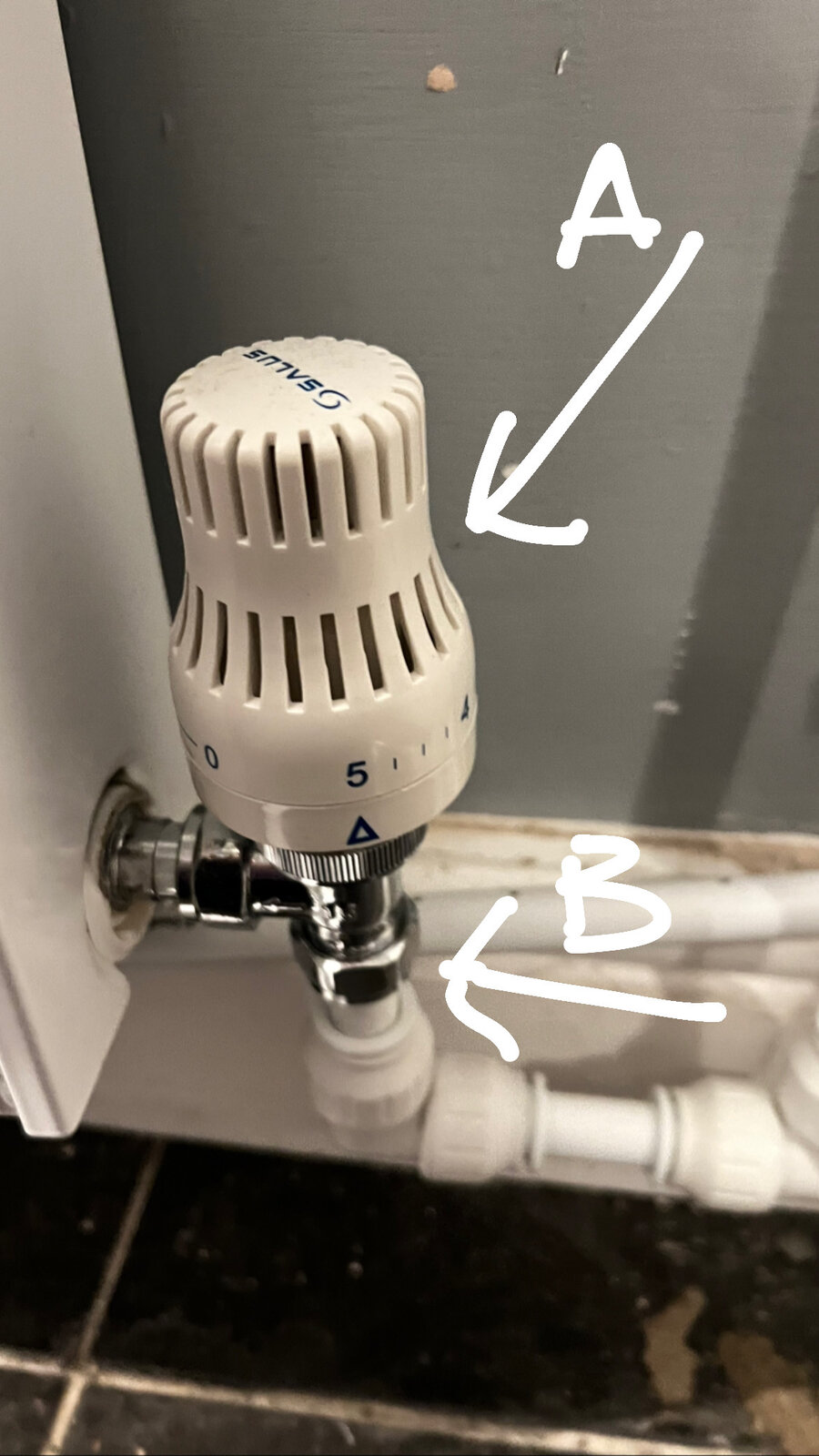

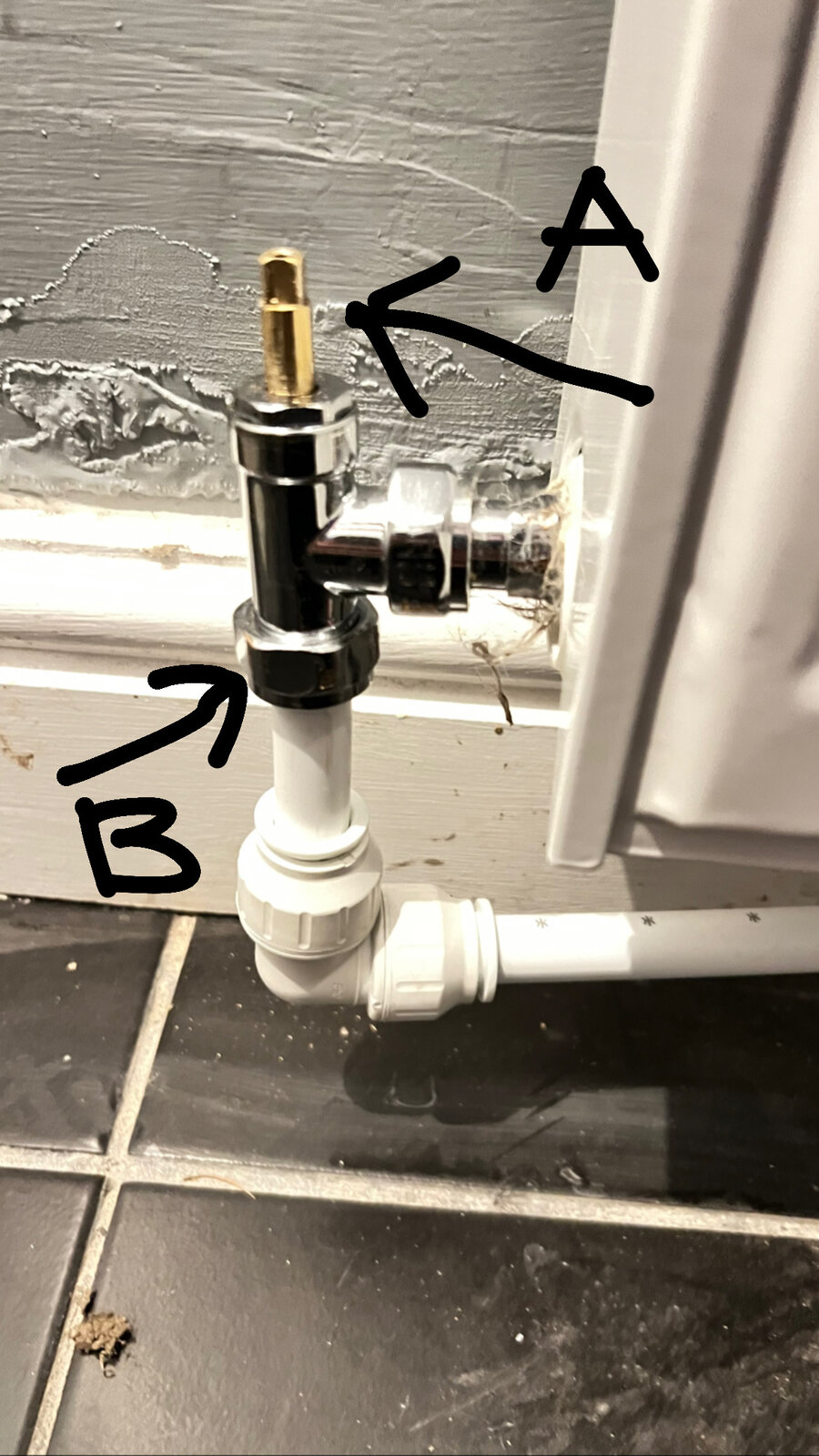

So the ones with TRV do I just turn A to off or is it B? And then the wheelheads is it A or B?

After taking off the plastic cover ,the brass spindle is visible ,can be turned with pliers ,but a spanner is better as pliers tend to slip and churn up the brass
