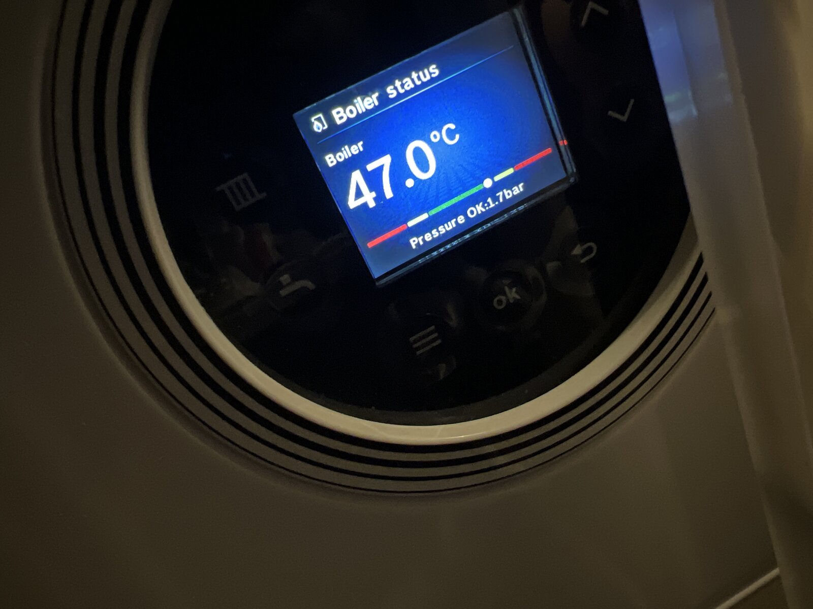

Check the valves on the pipework coming out of the boiler (a photo may be easiest). What pressure is showing on the pressure gauge? Are the upstairs radiators getting hot?

Boiler pressure is showing 1.7

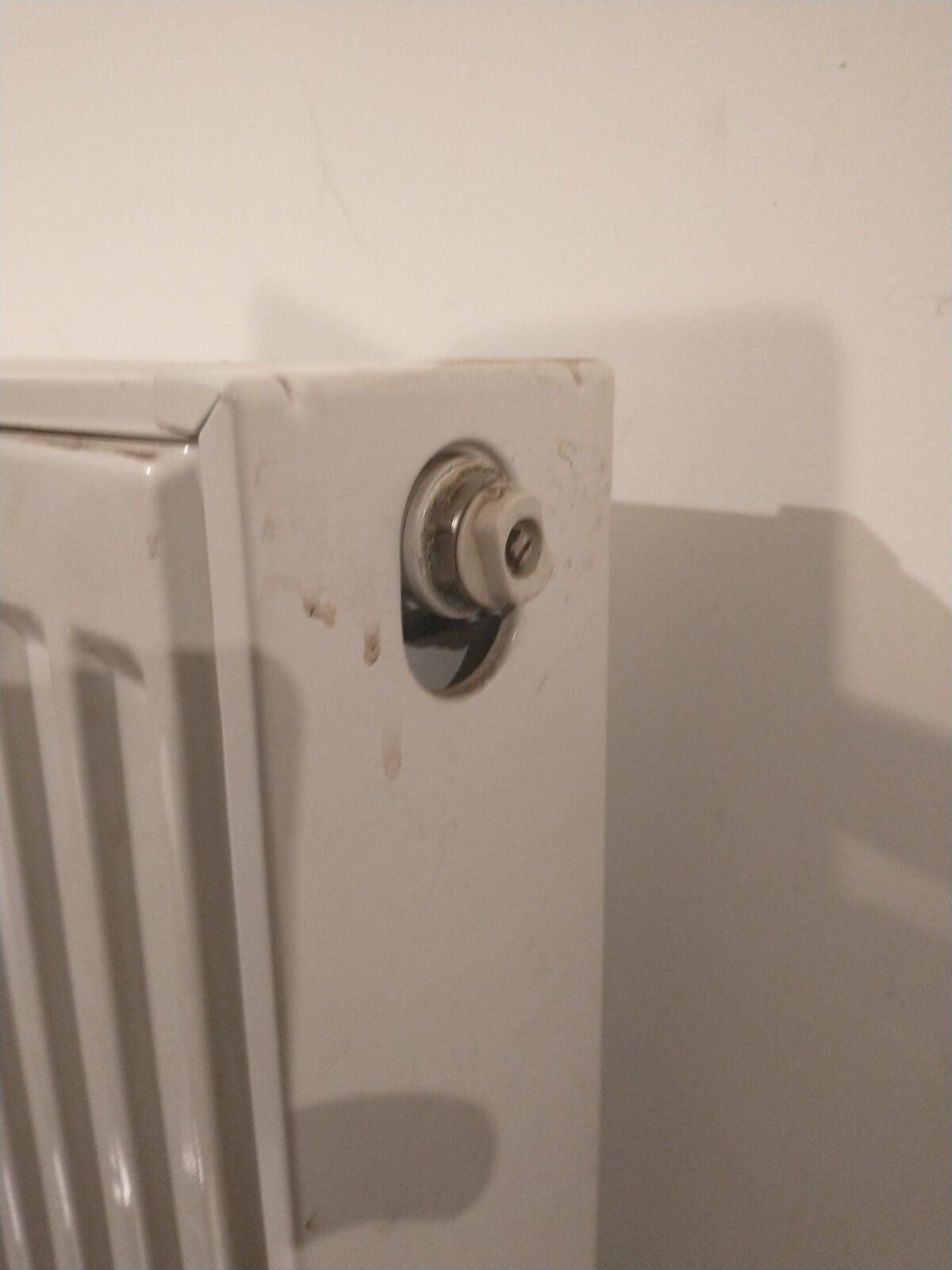

Is your new radiator a modern one with full-size threads at the top? (Like these) 16751174238675951532402400571644.jpg

If yes then I've had success by;
Acquire a spare radiator tail, a length of garden hosepipe, some PTFE tape and a big bucket.
If it's a short length of hosepipe (3' or so) fit it over the rad tail (hot water helps), fix it on with a jubilee clip or a cable tie if you have them to hand.
Switch heating off
Close both valves on the rad you're going to bleed (we'll start with the new one)
Bleed that rad (with the bleed valve) til water stops coming out.
Remove one of the chrome plugs at the top of the rad, replace it with your spare valve tail.
Attach the end of the hose to the valve tail (if you haven't already done that), stick the other end in the bucket (preferred- easier to see/hear air bubbles) or in a drain.
Ideally you'll have a friend here at the boiler.
Get your friend to turn the filling loop on and off to maintain about 2 bar pressure (avoid going above 3).
Turn one of the radiator valves on to full. Listen/watch for air pockets coming down the pipe, run it for at least a minute (if using buckets, try and have 2 so you can keep the flow going).
After a minute, close the open rad valve then open the other rad valve.
Again run for at least a minute.
Close that rad valve.
Tell your friend to close the filling loop.
Wait til water stops coming out of the hosepipe.
Remove the rad tail.
Refit the chrome plug.
Bleed system/operate filling loop til pressure is at 1 bar or so. Bleed all the radiators, not just the one you've been playing with.
Try the heating.
If that doesn't shift the airlock you will have to repeat the trick on an upstairs rad (but from the sound of it upstairs is decorated and you'll always get some spillage doing this trick).
EDIT Before doing this it's worth making sure at least one upstairs radiator is switched on (both valves open)- so any air moving will end up in that rad. If more than one is on that's fine, just remember to bleed them all. And the boiler (assuming there's an accessible bleed valve on it)

Yes it’s a new modern full size radiator. It’s 600x600. I’ll check back on here tomorrow and check out your suggestions
Ask brother to check that he has connected one pipe to the flow ,and the other to the return. I very much doubt there is an air lock ,with every other radiator closed down and the flow from the pump concentrated through the new radiator,and 1.7 bar of pressure in the system ,I would fully expect to get some flow through the new rad.
