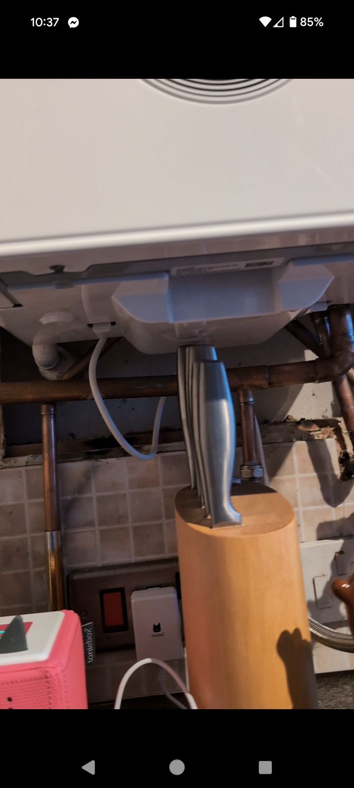

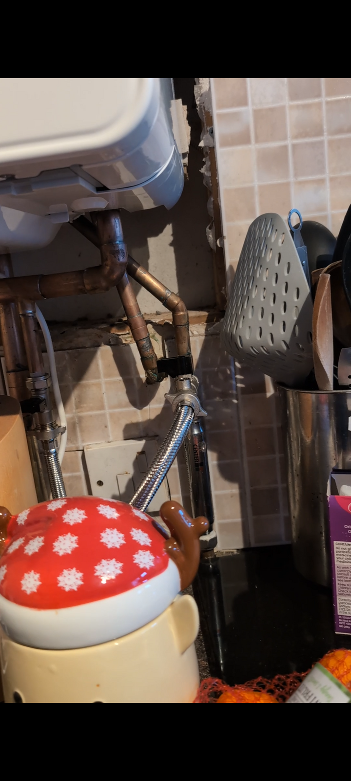

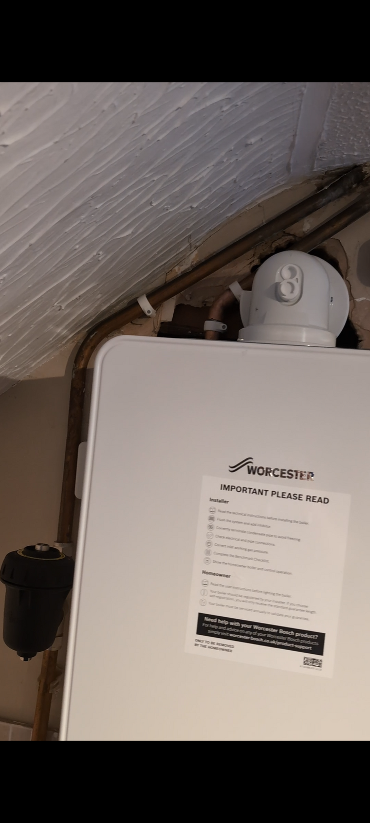

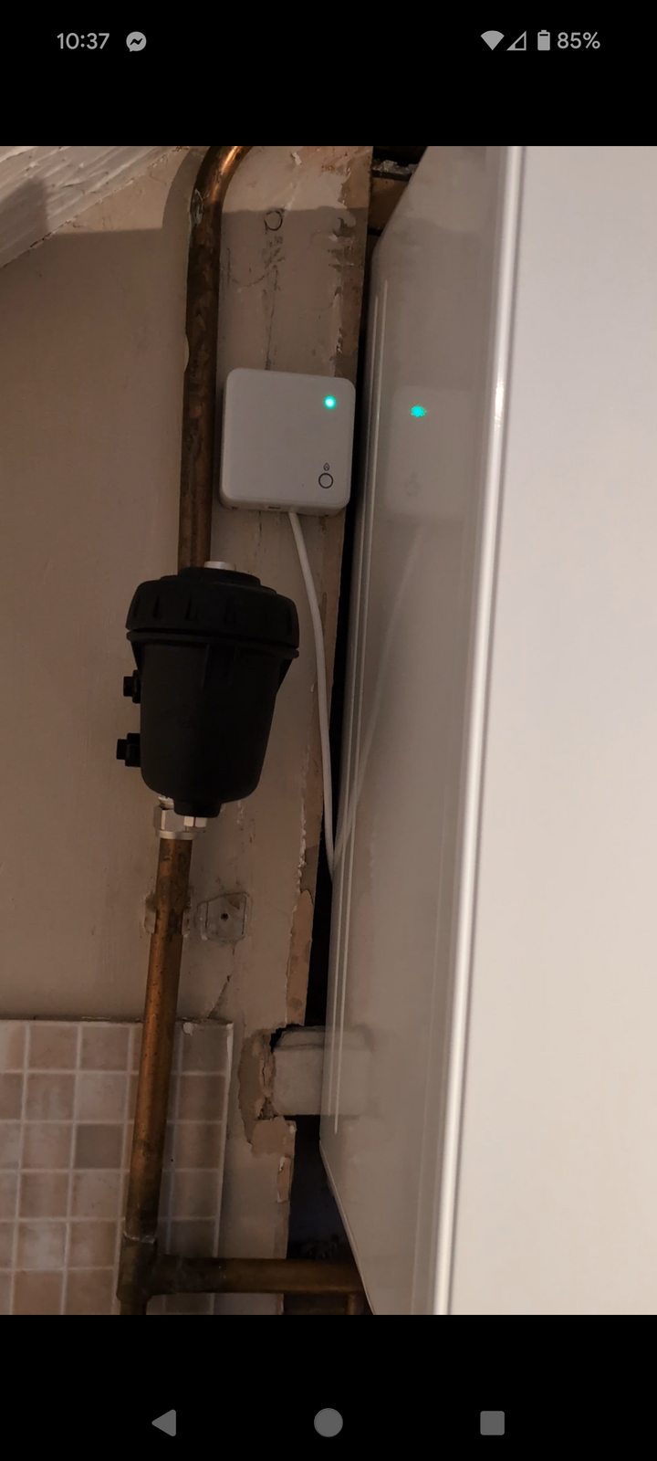

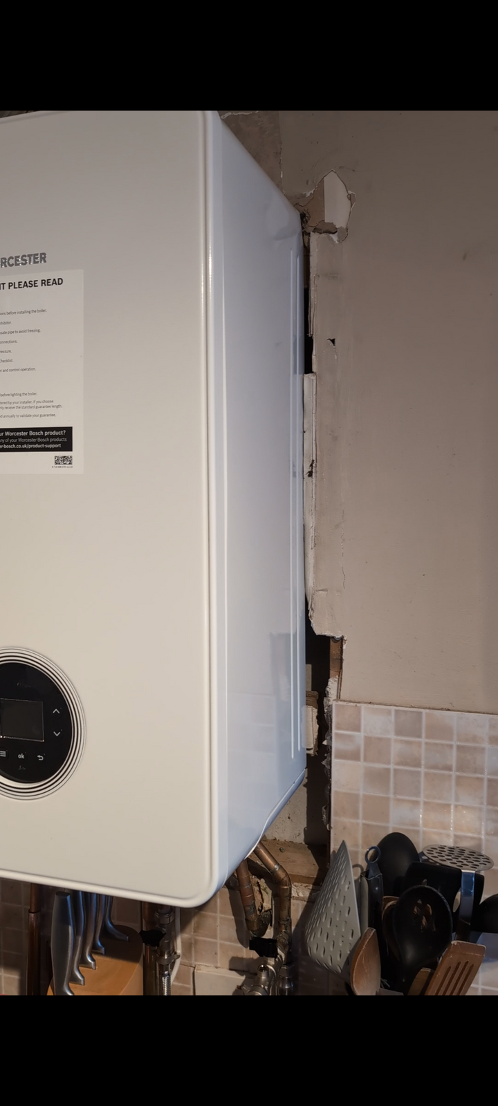

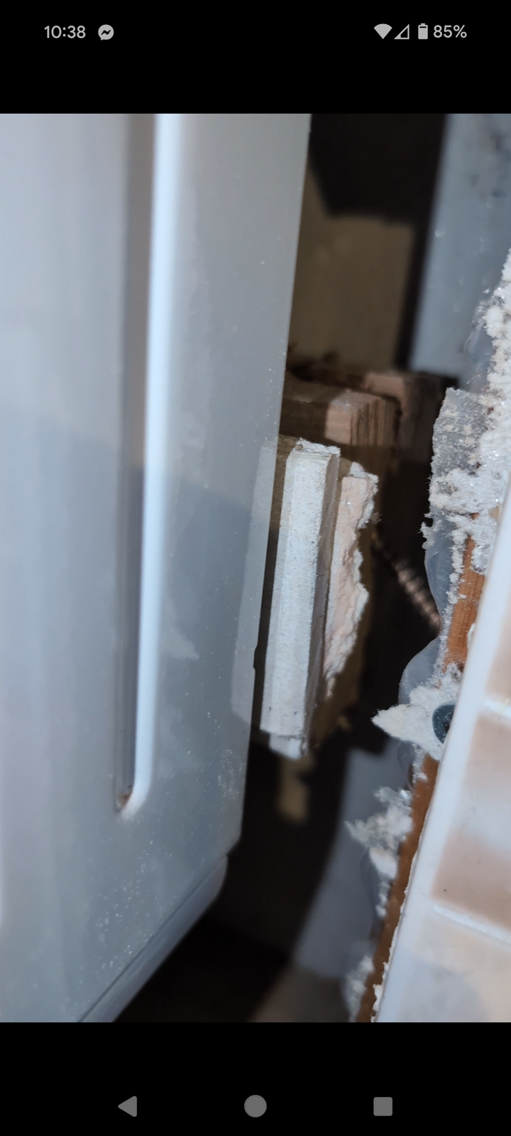

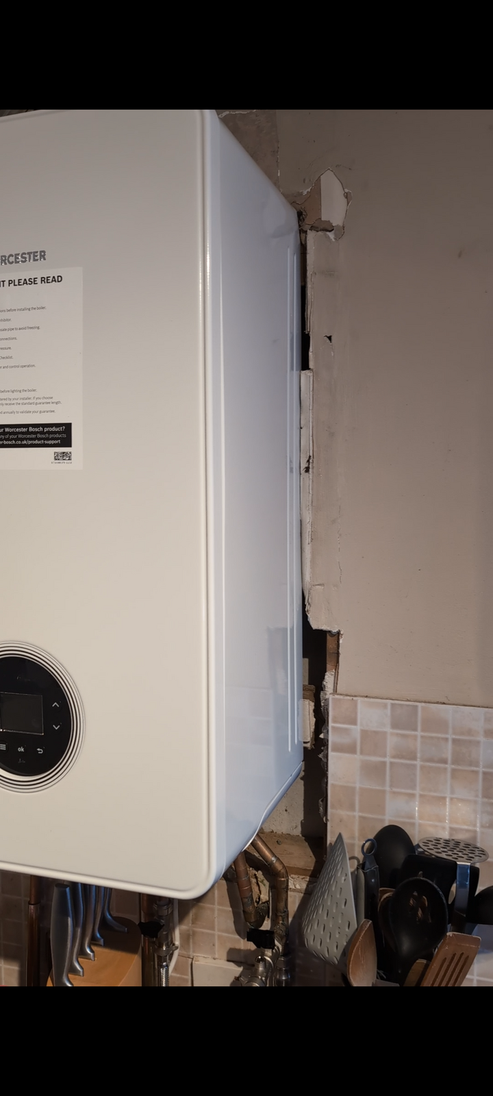

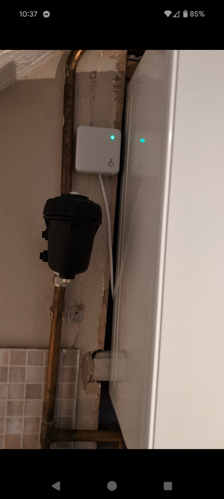

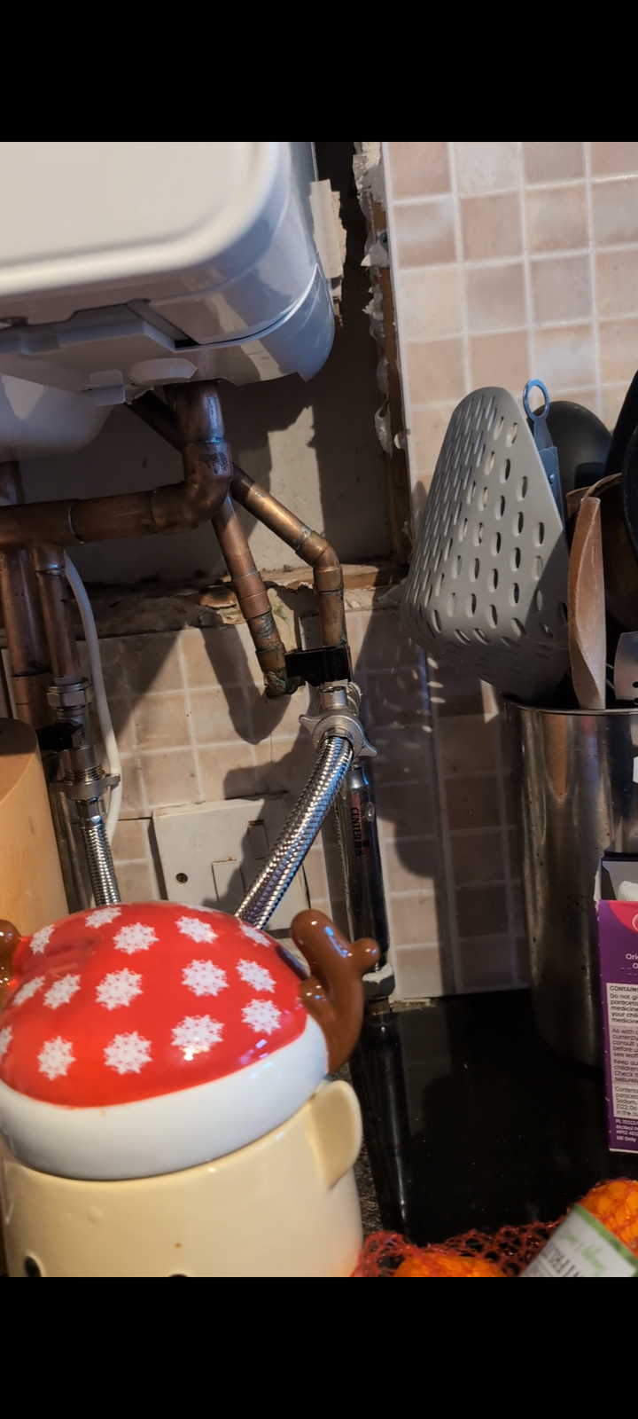

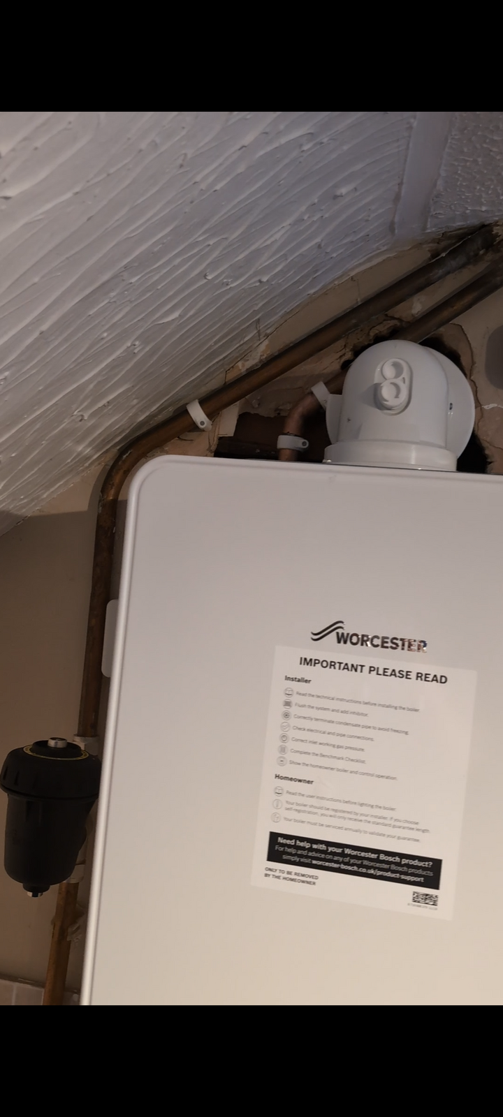

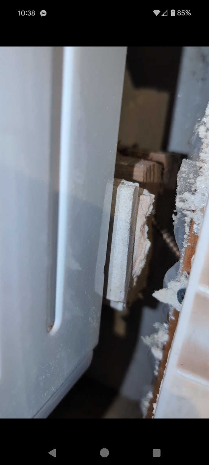

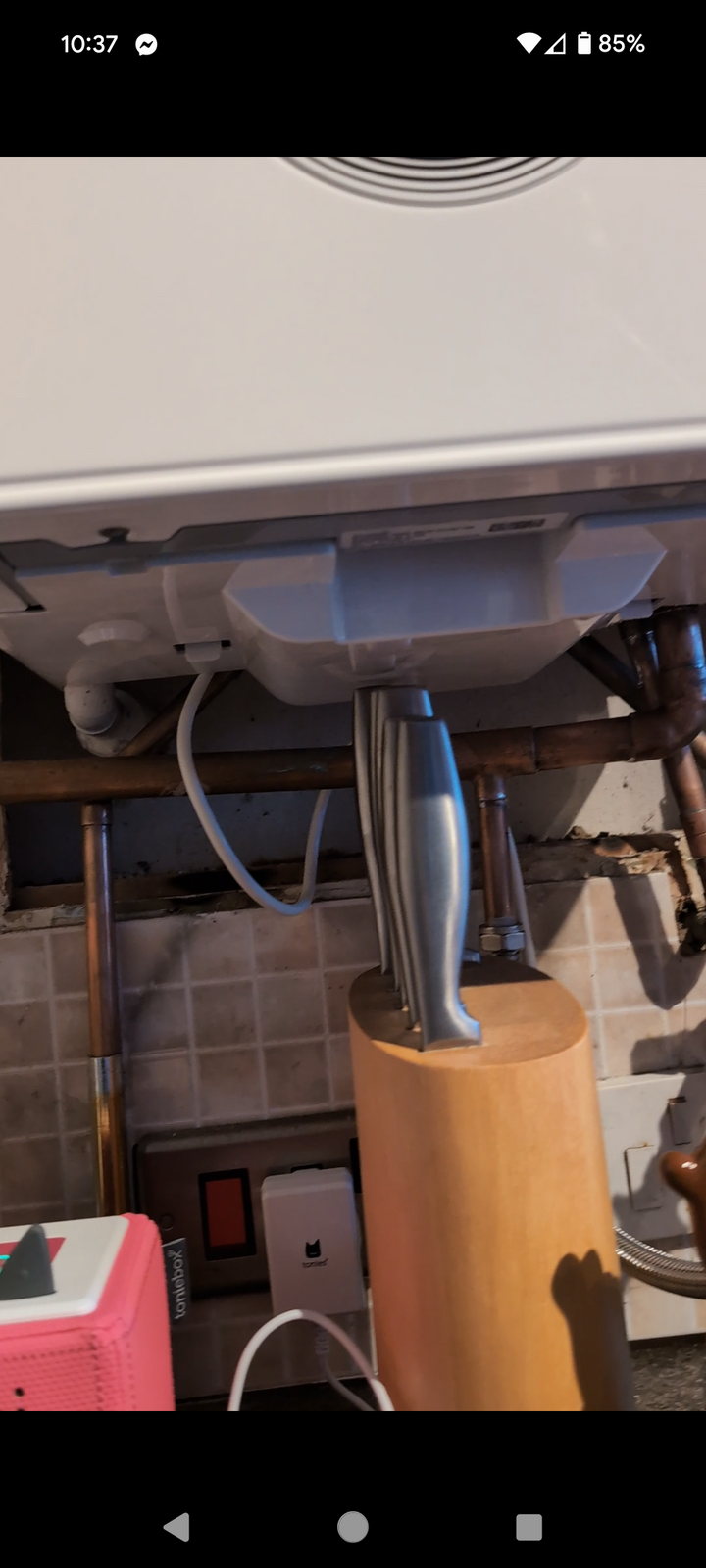

Hi
I had a new boiler fitted yesterday, of course alot smaller than the previous 18 year old one so expected some diy around it but it was not expecting this! They said our walls are just single brick and partition wall so they had no choice. It seemed like the old boiler was hung on some sort of board first from what we could see underneath but they're saying it wasn't and this is how the old one was.
Is this ok? Is it normal? Should I be complaining or getting a second opinion? Any ideas on how to fix on a budget as this eyesore just cost £2800 so money is now tight! I've attached screenshots from a video I took but was too big to upload.
Thank you in advance

Boiler installers tend to do whatever is quickest and easiest for them, was this a Boxt or Heatable install? It looks poor and I wouldn’t be happy either but you will find that they have covered themselves in the t&c’s so as long as it meets installation and safety standards then it’s down to you to do the cosmetic work.
I would give them the opportunity to answer any concerns you have and then if your still not happy seek a second opinion. I wouldn't be happy with it, but I'm a gas safe registered engineer, so tend to be picky.

Heatable thought we were safer with them than Boxt. Unfortunately couldn't afford local tradespeople as the quotes were £800+ more. Aware of the t&c but seems like they could knock out half the kitchen and get away with it now! Just was worried about if it was secured enough as the bottom batton doesn't even go all the way (can see in the last pic)
Yeah I spotted that, but it looks like several pieces of timber, maybe they're secure to the brickwork? The boiler hangs on the top batton anyway.

Not a brilliant job.
Getting the system cleaned is a must as others have said...
As for the boiler, i assume you are building a cupboard around it?
