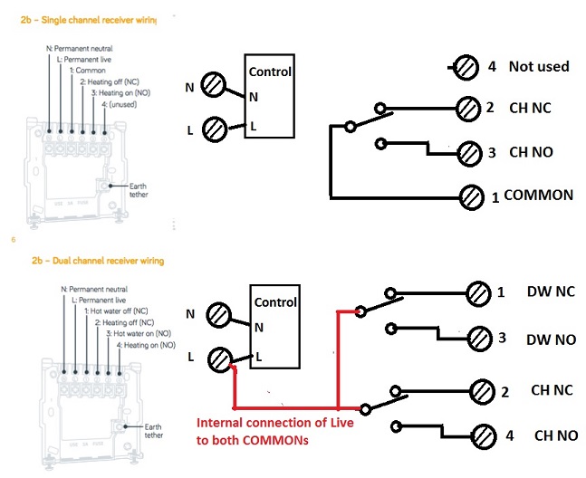

I had a Hive fitted which was using just the Heating channel for obvious reasons. It's worked flawlessly for 3 years on the old combi. The engineer had some "issues" with the existing Hive and insisted on replacing it with the heating only unit stating the existing dual channel one wouldn't work. He said just the receiver would need replacing, but ended charging me for a whole kit - this wasn't mentioned at quote time. Looking at the Vaillant manual wiring diagram it states that there are two Room Thermostat (RT) terminals, one of 24v and another of 230v. The dual-channel Hive works on 230v. Could he not have just connected the Hive into the 230V RT terminal rather than me have to spend another £180, seems to me he either doesn't understand his electrics or I'm misunderstanding completely - not for the first time.
