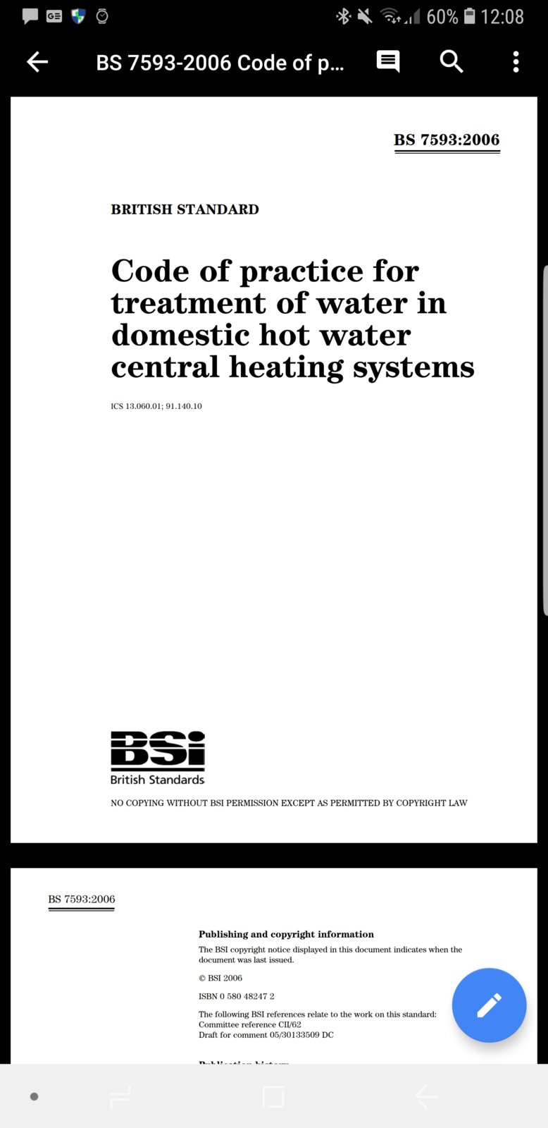

No you don't. Which is exactly what you did. A system should be treated to BS7593 (do you possess this document or Re regurgitating things you've picked up and misinterpreted here?) To state from the outset that the installation is not having a powerflush says it all.

A system should be treated to BS7953
BS 7953 : 1999 describes the types of interior and exterior entrance flooring systems, and gives recommendations for methods of selection, planning, installation and maintenance.
Power flush your floor matting to get a longer warranty on the boiler ? Don't think that works......
Bloody autocorreckt B7593... :LOL:
