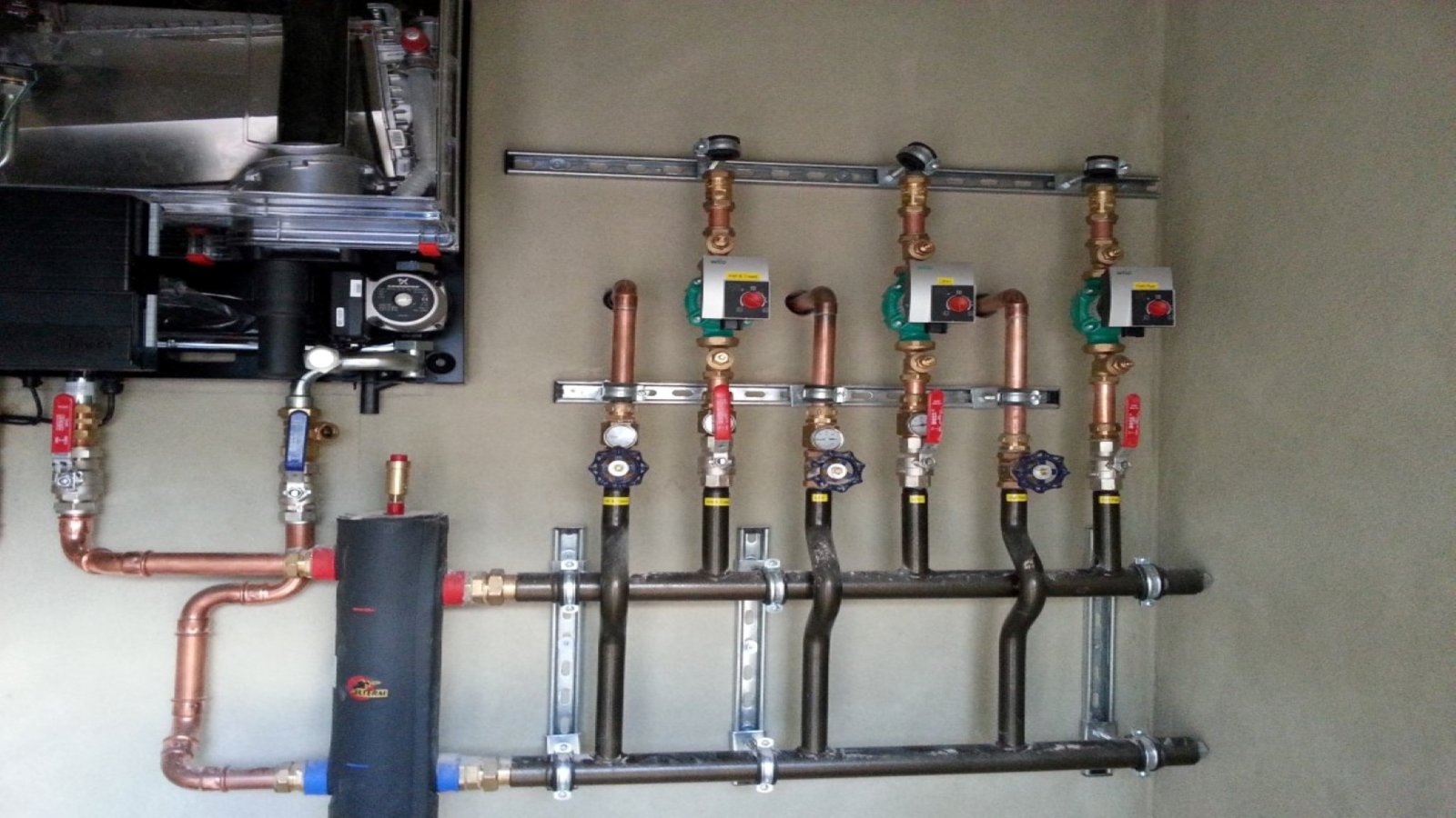

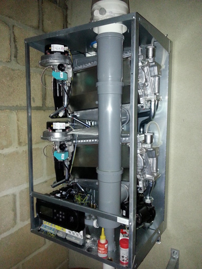

I only saw inside the case when the cover was off for the week, can't say I saw inside the heatex, obviously.
Nozzle
Trust me..... they're great heat exchangers . If on a clean system. We are agents for Atag commercial and look after a lot.
They need a clean system
