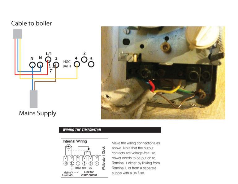

I could not get the timer suggested but was told the Drayton Lifestyle LP711 would do the trick.
This is its manual.
http://www.heatingcontrolsonline.co.uk/instructions/LP.pdf
I would appreciate some help with wiring this thing
This is what I currently have.
The cable between the clock and boiler is as follows
Red goes to L1 where it appears to have a link to the incoming mains supply which terminates at 3
This I presume is a perm live
Yellow goes to 4, I presume this is the switch live
Blue goes to the neutral
What I don't know is where to put the red and yellow on the new time switch.
On the wiring the time switch picture, I think the red cable should go to 1 (com) and Yellow will go to 3?
Any help on this would be REALLY appreciated
The system is a real simple setup The timer just needs to switch the boiler on and off, they are no other controls, no stat anything
Hello c_l, yes I agree with your 'logic', notwithstanding the fact that I can't see your system.......
The original connections seem to suggest that the 3 Core&E has a permanent live to the boiler (red), a switched live (yellow) and a blue neutral. So, for the new, basic timeswitch, the red should be connected to 'Com' (or 'L'), and the yellow should go to terminal 3.

Thanks again POD
Its not actually my system.
The boiler is either a Glow-worm Fuel saver 65f or 80f
The system is real basic the boiler timer just switches on the boiler at times during the day
The only way to switch the central heating off is to actually go up stairs and turn the fullway valve off, to stop water getting to the radiators
There is a small and I mean small hot water tank
They are no other controls
No instant hot water
Perhaps then, you might advise the customer to at least have a room 'stat to control the pump on such a seemingly wasteful and basic system?
