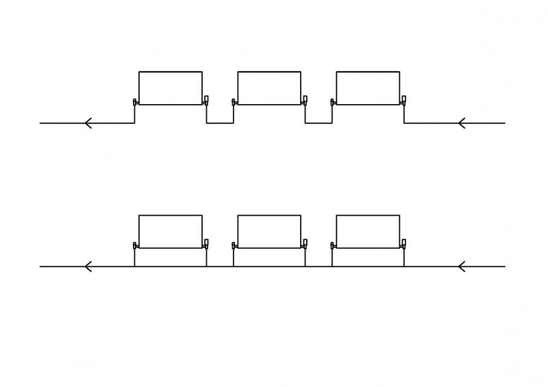

Still would have thought TRV's would potentially block off flow downstream?
If I turn off a rad on a any floor then all the rads on that floor go cold.
Something funny here. Surely, that must mean that the radiators must be connected so that the return from one radiator is piped directly to the flow on the next, (as top diagram below). If you fit TRV's to the system you describe, when one room warms up and the TRV closes, they will all go off. I have a one pipe system where all radiators, bar one, are fitted with TRV's and sit atop a common loop, so turning one off doesn't affect the others, as bottom diagram.
Your diagram sums it up ....
Yes - correct - I have removed floorboards expecting to see a pipe underneath each rad but their isnt one!
Thats what I was expecting to see on my system.
Someone has worked on the system in the past, probably to zone my upper two floors into two seperate loops - Each of these loops run into seperate motorized valves near the boiler. But each loop has 5 or 6 rads in series.
In that case individual control will be impossible. But on a positive note, in theory, I would expect a better temperature differential across your boiler than with the standard 1 pipe layout :D
