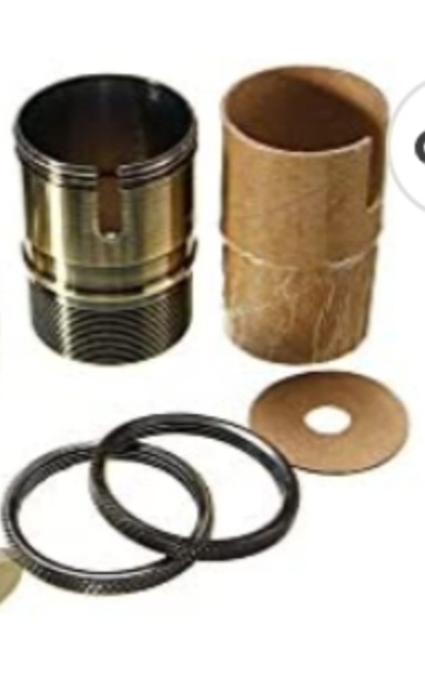

A friend of mine has asked me to fit a brass lampholder to a standard lamp for which she has purchased a fancy Edison Screw decorative lightbulb (E27) in place of the current plastic bayonet lampholder.

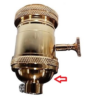

The new brass lampholder arrived and I was surprised to see that it didn't have an earth connection, only a plastic screw at the base to clamp it onto its fixing which is a threaded connection embedded into the wooden lamp.
The inside of the cylindrical body is lined with what looks like cardboard, but the base section I've marked with an arrow is metal and the wiring terminals are only a few mm above it. I have tinned the wires before connecting them to prevent any stray whiskers poking out and made sure that the insulation is right up to the terminals. However the lack of an earth connection worries me slightly. The fitting is rated 240V (AC) and sold in the UK by a UK company, so it must be OK right?

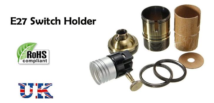

The full spec of the lampholder can be seen here.

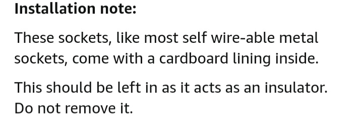

Apparently the 'cardboard' inner counts as the double insulation - this may need some investigation!
Edit: the website and company appear to be slightly more legit than some of the suppliers we have seen recently. Were there any CE and double insulation markings on the packaging/instructions?
After some further thought, and if that really is just 'cardboard', I would fail it in a PAT for the fire risk alone - I don't know how it would cope with a 100W filament bulb - are there any maximum wattage warnings?

Mine does have a note about the cardboard....not sure about it being a "socket" though :unsure:
However, I have just noticed that in one of the photos, it shows a circular cardboard disk....I didn't get one of them maybe that's what's lacking.

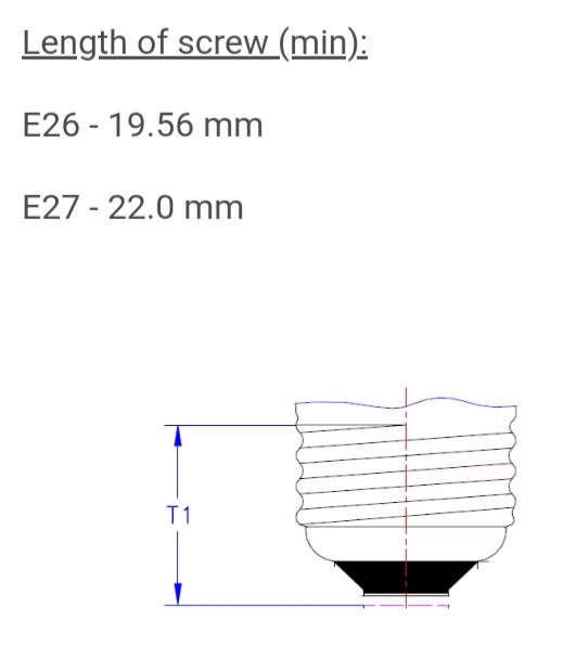

This is a US design and most likely ES26 rather than ES27. That means it doesn‘t necessarily conform to any European standards and an ES27 lamp will be a poor fit, leaving considerably more thread exposed than it should. I wouldn‘t fit thi socket.
Proper ES27 sockets have an earth terminal but ones with built-in switches are rare. The only ones I‘ve seen have pull-chain switches rather than rotary ones (I live in Austria, where Edison sockets are the de-facto standard and BC22 is virtually unknown among the general public).
Difficult to measure the bulb holder, when I take it back to it's owner and get the E27 bulb I might me able to get a better idea. But is does say that the length of the screw is "min" so it could be still be longer than the lengths stated.
