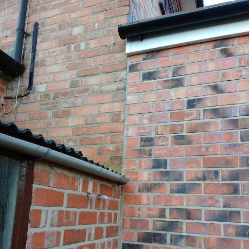

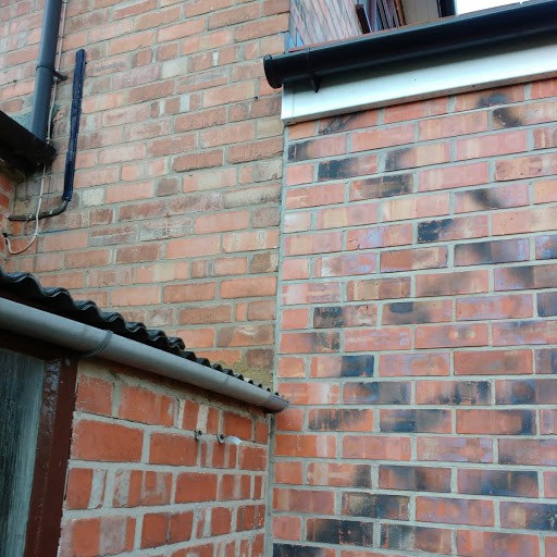

Because house and extension are built at different times, different construction methods, prob different foundation spec.
A flexible joint is therefore best. Known as a 'firfix' in the trade.
Hopefully new foundation based on current building regs which are not based on an allowable settlement figure hence structure should stay put. Aesthetically toothed joints every time if marrying into flush brickwork but each to their own.
Toothing out used to be the standard method for an extension, but it was always known to create a 'plane of weakness', even when used in newbuilds.
Nowadays to step back the brickwork and use a wall starter kit is the preferred method, as you are not stuck with the existing gauge.
When building on a clay soil or similar you will always get a certain amount of settlement, so there is a fair chance of getting a crack in the brickwork through the toothing.

When you lay bricks the bed joints are compressed. With toothing every other joint joint isn't compressed by the brick above, so the joint needs to be carefully packed in with mortar, but it's never quite the same as being built as part of the wall.
So then you will see a precise vertical join where old wall meets new wall?

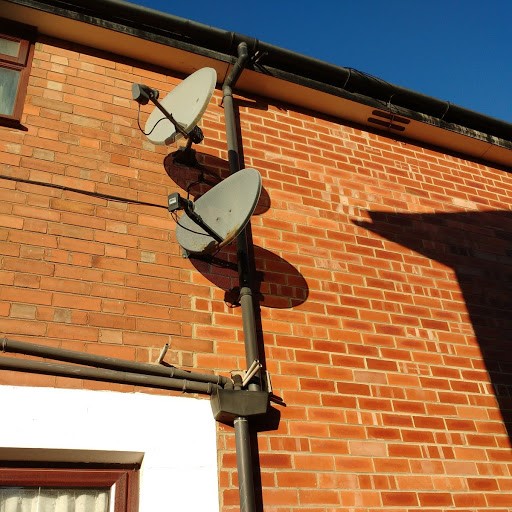

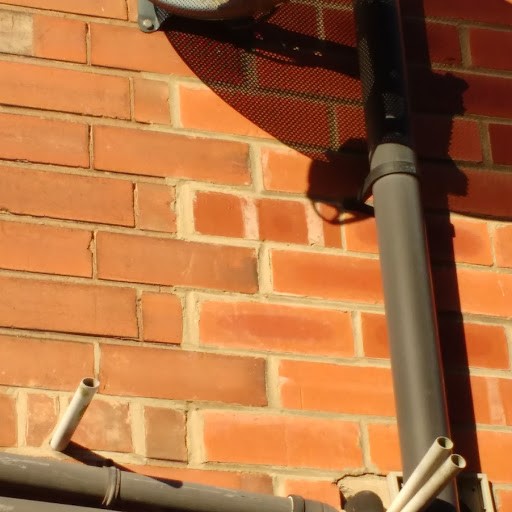

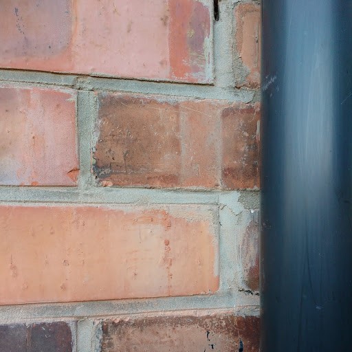

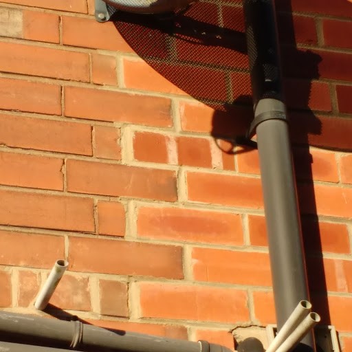

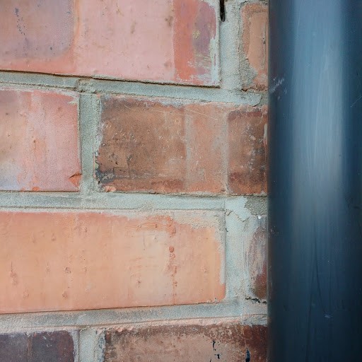

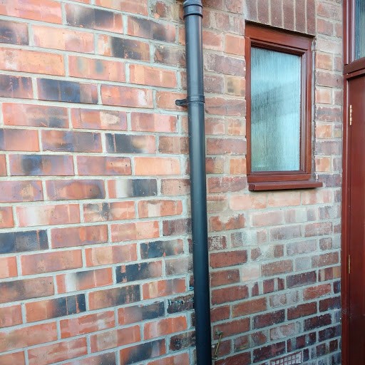

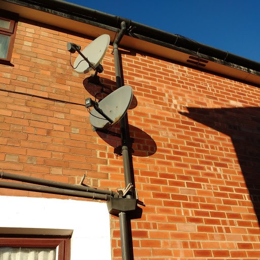

Well here's my reality. My extension done 5 years ago and neighbours extension done 25 years ago with brickwork toothed in, not sure what happened with the crocodile wall connection, perhaps its moved??
Lovely. What address shall I send the gold star to?
I'll also mention it at my next conference and organise some coach tours for all the UK building inspectors who have been doing it wrong for all this time. Get a big box of teabags.(y)
