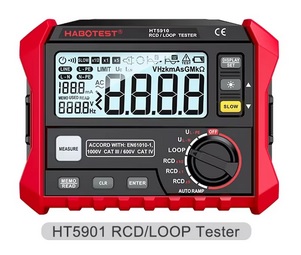

I spy with my little eye earth wires, same as everyone else temp-earth_tonemapped.jpg the problem is of course you really need to test is is an earth, the the gear to test it with is expensive. Loop impedance tester.jpgThe big question is why fit metal fronts, just leave as it is, can see why you want to fit a dimmer switch or smart switch, but just to have a metal front, why?
