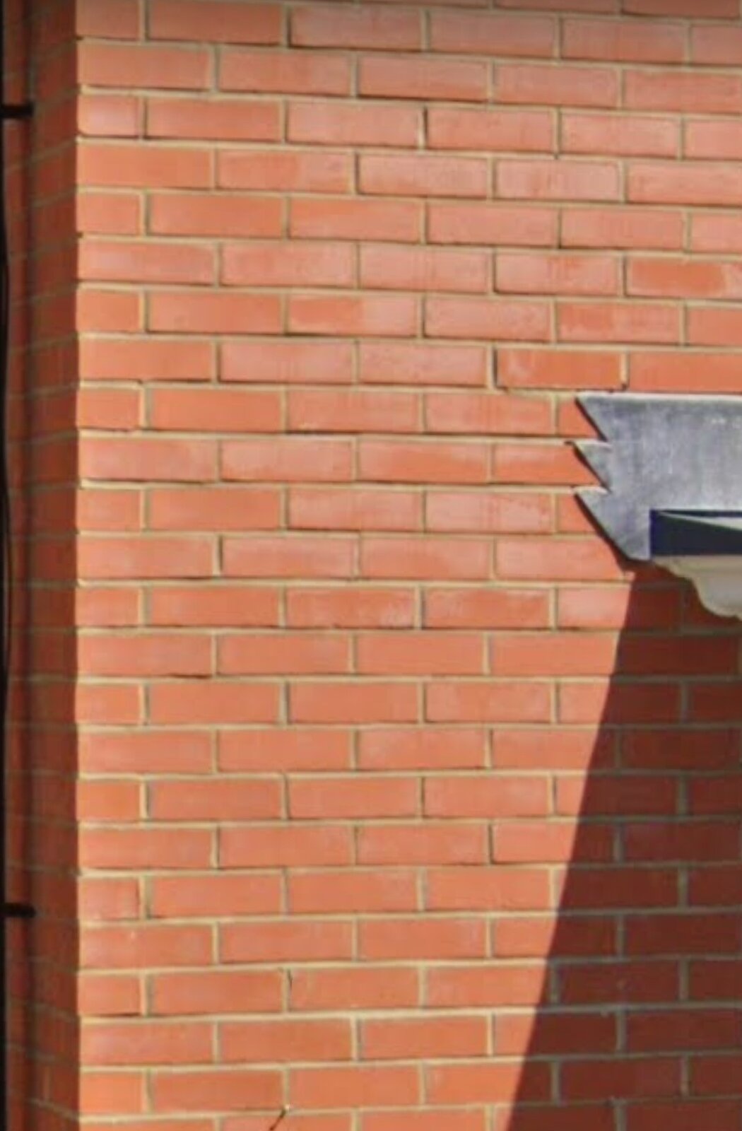

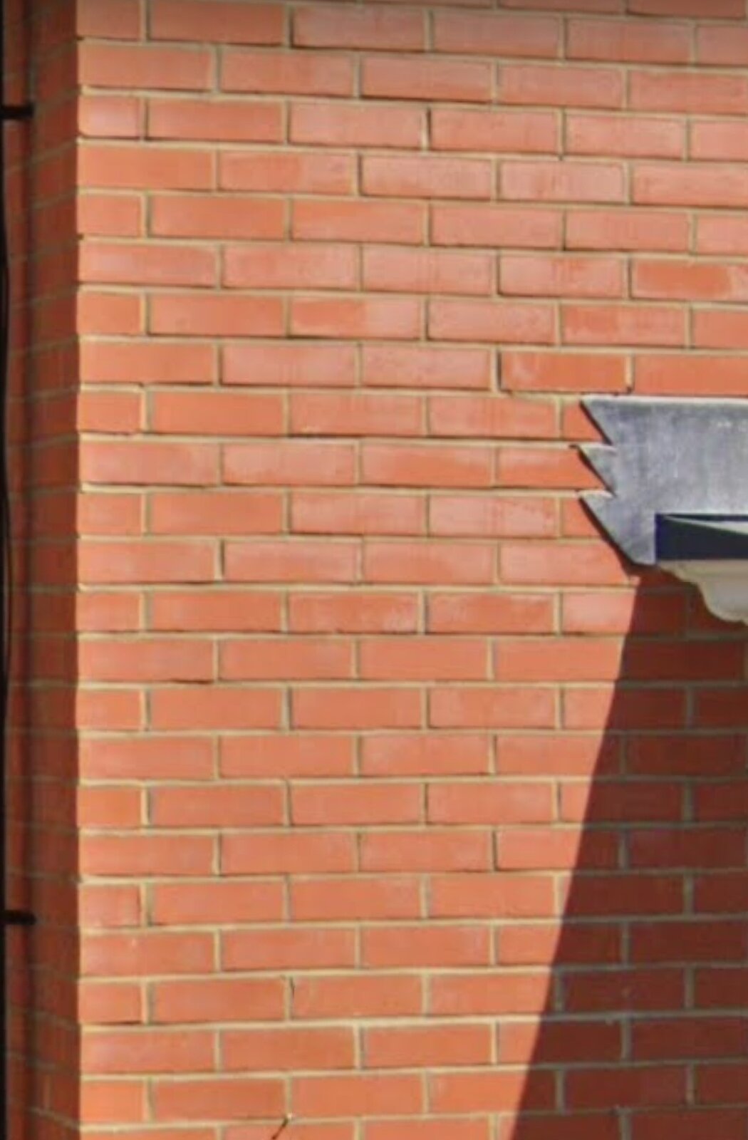

QQ - any ideas what this "sheen" is?

Hard to tell from photo but probably just efflorescence.
Leave it alone and don't worry, should be fine after a winter. Will probably get worse before it gets better.
