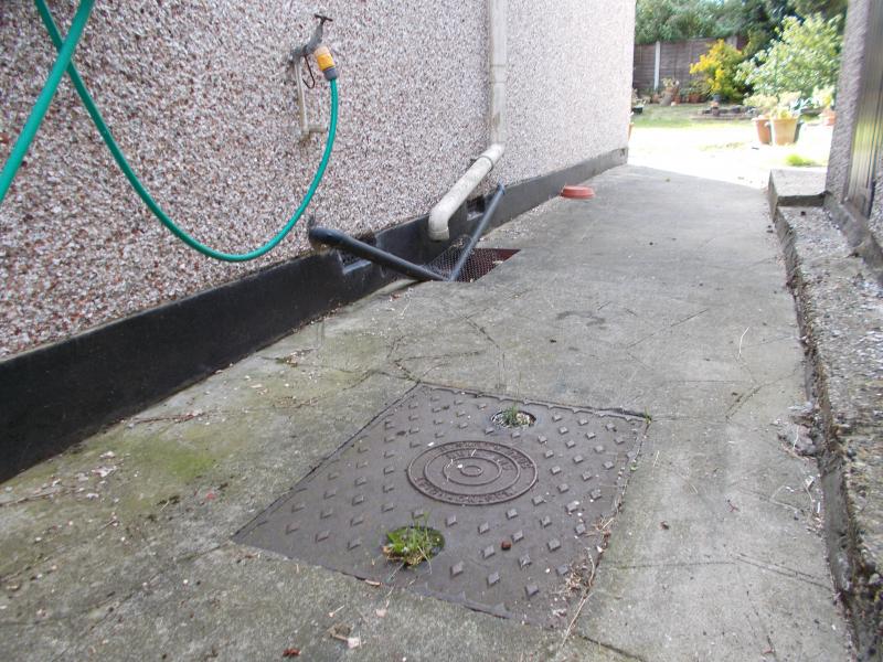

Waiting to hear from Anglia Water with the build/over near sewer agreement, they have said so far we can put the new build footing up to 300mm close to the sewer pipe and do away with the middle inspection chamber, what is the situation for the new build toilet connection, not much room there so will it be above the existing sewer pipe and drop in from the top or take it straight to the front inspection chamber somehow?

Updated the drawing, hope there's enough information, if not, let me know. The new build footing is just a guide line, Anglia Water need to see the base goes deeper than the sewer pipe, they will decide the footing depth

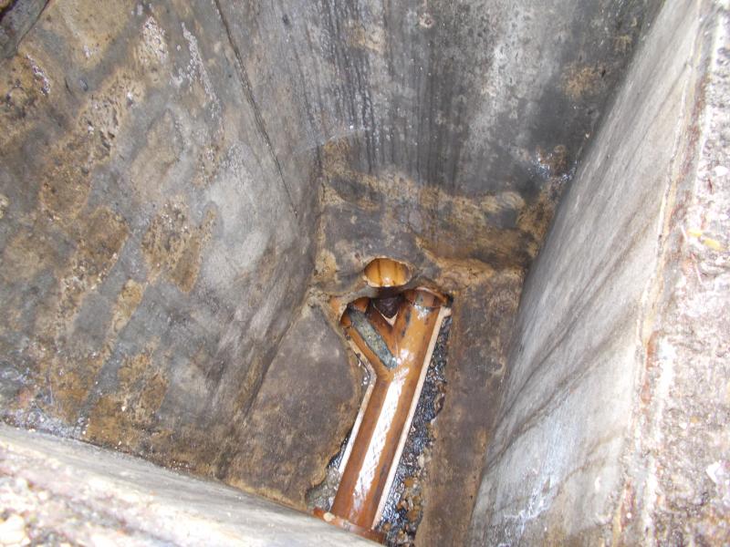

Rear manhole top of run with channel bend, invert level should be 975nn below cover. PLEASE CHECK THIS OUT..
The other critical measure we want is centre of new WC as shown on sketch to the middle of rear channel bend manhole mentioned above. Reason to see if you can get a fall from internal sub soil stack with AAV into this M/H

Yes sorry, bad drawing on my part, basically I was showing the bottom of the sewer pipe is 1.250m to the ground level. the sewer pipe is in the centre and the centre of the sewer pipe is 650mm from the left wall of the property No:41
Is existing soil pipe to bungalow external.
It's all underground so not sure how it's connected to the WC and no soil vent!
See drawing http://www.docdroid.net/glx4/img-0003-new.pdf.html
Middle Inspection Chamber

Confirmation of invert depth of rear channel bend manhole .
Distance from new soil stack to middle of above rear manhole.

It is a public sewer with next door neighbour.
It is just not practical to try and get into existing manhole with new soil connection and you can not drop a new foul into existing foul with out new inspection chamber.
The way I've read the research the new build connections they would normally like it to go to the new inspection chamber or to the existing inspection chamber at the front?

This proposed layout does not give adequate clearance from the existing public manhole.
We have also advised that a clearance of 500mm should ideally be achieved, however we would accept 300mm subject to a suitable foundation design to ensure no adverse loading on the public sewer.
Do you need to know the measurement from the ground level manhole cover to the bottom of the sewer pipe?
Regards oldun
Not sure yet where the soil stack position will be yet, it's approximately 1.500m from the middle inspection chamber between middle and rear manhole. If you want the exact measurement then I can work it out for you from the plan.
Is this the information you need?

Leave the centre M/H serving bungalow`as it is. Grey water inlet does not comply, but that was how it was when Anglia adopted sewer.

Your new manhole needs to be 460mm diameter to comply with the depth you require.
Your problem will be the three quarter sectional bend into the channel bend on rear manhole We cut our own out of either 15, 30, or 45 degree bends, which ever suits best. It must be kept as near as poss to the channel outflow to function. Benching to other side of channel may need to be taken up higher and more vertical Suggest you fit this first before doing any drainage. Do not forget to allow where drainage comes through co.ncrete founds
