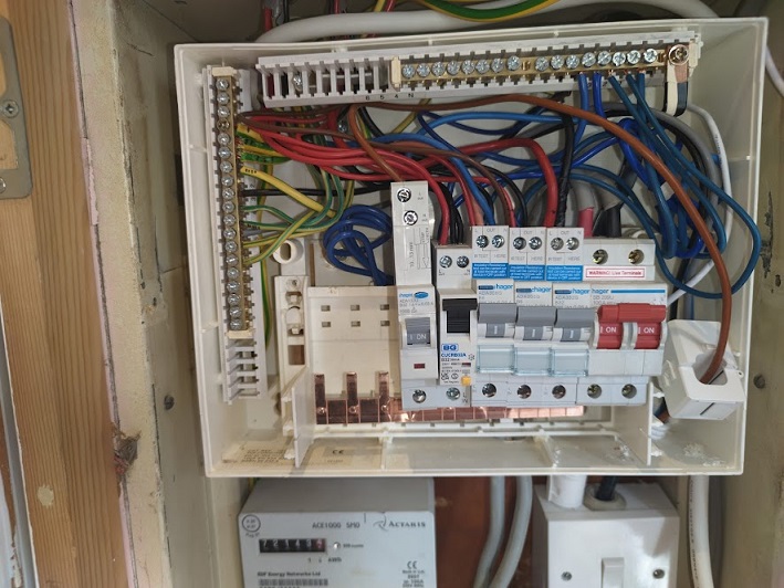

That doesn't appear to be true from the photographs posted.
Well I'm missing a component, I believe I mentioned this. Pretty obvious that it's not gonna look good when the breakers are not held in place correctly. It's to be expected that the old situation looks better than a work-in-progress photo while a component is missing.

the bottom part of the bar is too tall for the clips that hold it in place
The MCB/RCD/RCBOs hold it in place, not the clips
which is not ideal
Why not? I can't see any of the wires clipped; what holds those in place?
(See pictures).

Is that anything to worry about?
Yes and no. It fits well and makes good contact, just like the original busbar. The rating is also high enough. But it means that a breaker from a different brand that clamps down slightly differently on the busbar will cause everything to go crooked and uneven. The only safety concern I see of the busbar being held up by the breakers is that it might shift easier when a new breaker is installed and comprimising the contact that it has with the other breakers, without it being obvious to the installer. This would cause overheating on the non-protected side. The risk is small, but I'd like to avoid it.
Then that breaker should (shall) not be used.
Rubbish.
Get another installer, then.

This is acceptable? The issue is that behind the breakers is no full DIN rail, only the top ridge of a standard DIN rail. In the unit's design, the top of a breaker is mounted on the plastic, while the bottom part that would normally mount on the bottom of a DIN rail is not secured. Instead, the bus bar is relied on to hold the bottom of the breaker in place.
What wires?
Er, so the one that I think is the newest one, is a bit of a disorganised mess, and I can't believe the cover will be easy to fit with all the breakers doing the Mexican wave like that.. Have you got some more breakers yet to install on the end of that bus bar?
Yea I agree. Because I removed the RCCB everything moved further to the right and some cables were exactly the right length for their previous configuration. Additionally, the neutral tail of the BG RCBO is miles long.
There is stuff improved that you can't see though. For starters, the two earth wires are not spanning across the unit anymore. And in the original one there were 2 cables wired to the earth terminal that put a lot of strain on the bar. These have been re-routed as well and some damaged insulation has been replaced with conduit.
You can buy new DIN rail and fix it in place if you want a better mount for breakers.. but if you're going to that extent why not get a new (metal) CU?!
What wires?
The red/brown/black/blue things!
RCBO everything and reuse old locations?
It is, but it's not recommended to cut them.. They'll tuck away somewhere I'm sure

In your "work in progress" photo the main switch is on. You have said that you have no means of isolating the incoming supply to the CU, so this whole mess must be live.
You can't possibly get the cover on the CU with the devices in those positions.
You have an exposed busbar.
You have a neutral conductor with an exposed core.
At least one device that you have installed is not intended for use in that CU.
