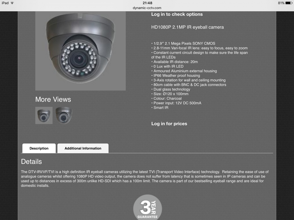

I use these on the budget end domestic cctv installs
Something like that is a much better option due to the vari-focal lens fitted.
You need to be careful with HD CCTV. At first glance the image looks great and the human brain fills in a lot of gaps to kid you into thinking there's more detail than there really is. It's a step up from standard definition but unless you choose the right cameras wide angle fixed lens cameras positioned around a house are unlikely to provide the levels of detail required to identify people you don't know.
But I don't know the specifics of your property. This is why it is essential to look at each installation on it's own merit. General advice still remains the same though, vari-focal cameras are more effective than fixed lens wide angle cameras.

Great stuff. Sorry if it all sounds complicated, in reality it isn't but you do need to understand what is happening and what makes an image good or bad. The biggest problem is that as an industry there is so much bad information and so many lies it makes it hard to understand. You presume a "30 metre" camera can be used for distances up to 30m when in reality it might only have an optical range of less than 5m !!
Think the camera and its capability compared to its required function is sometimes misunderstood.
at 30M away the IR can see that far (if specified) , so you will be able to make out theres something there, and depending on the lens fitted, it will determine if you see enough to id him at 30M away or just see him/her/ something.
Its not how far the camera can see, or how much the camera can see, its about getting the right camera for that scene and whether you want to id, recognise, detect a person at a particular location within that scene.
Jo Public get the wrong idea with these cheap camera kits.They see a nice PICTURE and think that it will do the job.A specific camera with the correct lens is the correct way to install a system.These cheap kits do not stand up in a court case unless the image of the person can CLEARLY be indentified . Thats why when installers quote for cctv the customer says how much!!!.Thats because we use the correct camera for the job not cheap fixed lens cameras that look the part.Also we set up the dvr for them and not just get people calling the office, can you help me i have a swann kit and it will not connect to the internet ?
