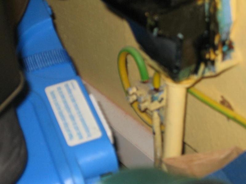

Hi Phil/River,
Thanks for this advice. To be honest I kind of prefer the method Phil suggests (no offence intended River).
I think I can see the MET (looks like a large chunky piece of terminal block fixed to the board where the meters/fusebox are attached to, can see a couple of different earth cables running into it - that the right thing?).

PS- Yes that sounds liked the MET (Pic would confirm it )
Confused now!
I understood it that I connected a flying lead to the earth I found in the ceiling, then the other end to one probe of the meter, and the other probe to the MET.
But I don't understand where I can use an extension lead - do I need to connect that to the earth in the ceiling to make the link? Sorry if I'm being thick.
Sorry, pic attached, poor quality but hopefully you can see if that's the correct thing.
[/img]
