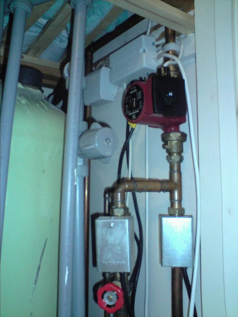

Is there any way you can post a pic of the pump and surrounding valve assembly??
Hi guys
As requested, I've attached some images below of the setup in the airing cupboard. Ignore all the brown plastic piping, that's just the shower pump plumbing.
You can't see this cos the airing cupboard shelves etc are in way, but the pipe leading into top of pump boiler goes up, left, and then eventually down into the boiler which is downstairs. The smaller vent pipe comes off this pipe in a 'T' just above the white junction box and disappears up into the loft. I can't see where the cold feed joins the piping (I'd need to go into loft for that) but it's definitely not in the airing cupboard. The other white box is the wireless thermostat sender.
Above shows further down the piping towards the base of cylinder. In between a couple of the black wires you can just see a silver in-line isoltating value (flat head screwdriver type) which is apparently a bypass (although 3 rads, 2 in bathrooms and 1 where roomstat is sited don't have TRV's anyway). The large pipe on far right, leading from the right most valve, leads under the floorboards to the radiator feeds, which in turn leads to the pipe which heads downstairs and from which I can hear the bulk of trickling per my issue (2) in original posting.
Let me know what you think or if you need anything else...help much appreciated!
Thanks,
I think if the pipe T'd in to the flow (the one above the white box) leading to the pump is a smaller size then it is the cold feed, in which case it begs the question "Where is the vent"????, you need to follow the pipes into the lost and find out how and where they are arranged, then if poss draw a diagram and post.
