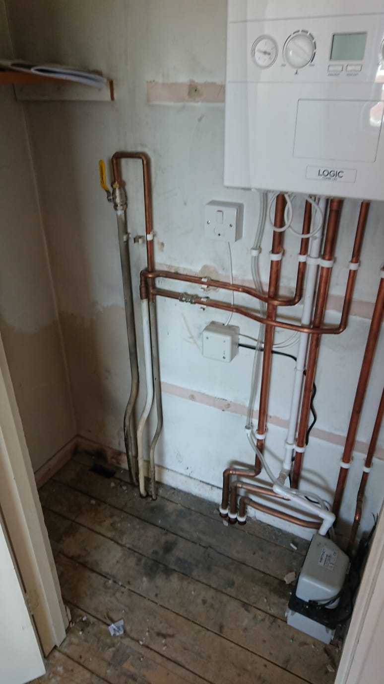

Unfortunately the old stop cock running down the side of the chimney breast is cemented in and said he could try and remove is we signed s declaration buy advised it could cause any number of problems water wise under or through the house so we will avoid that one, silly question while I am here, this lever on what looks like the water supply to the boiler (left hand side) , what this stop the water to the whole house? As I want to Rip out my kitchen sink and all soon

Turn it off and see though possibly not, that may be the old rising main that ran up to the attic to supply the cold cistern that would have been up there.
You want to ask the plumber as he would have had to turn the mains off to get that yellow handled lever valve installed.
I tried it, it turned of the water to the cisyern, the cold water tap to the bathroom upstairs but not the hot one

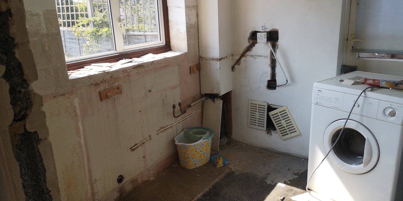

Ive pulled mist the kitchen out so think I'll leave the rest for the people that know what they are doing

If it doesn't turn off the hot then the 15mm cold feed up out the floor will be the rising mains supply and the 22mm pipe will have been the old cold feed down from the cistern. The lever valve should be on the 15mm pipe before the tee to the boiler. That ISO valve - that really shouldn't be there at all IMO - will shut off the cold supply to the boiler and by default the hot water.

Managed to get water turned off outside in the end and managed to get the kitchen all out now thanks to all of your helpful advice
Crap photo I know but it's better than the old kitchen that was in there
