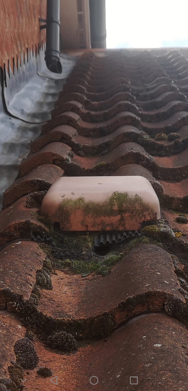

This is the vent for her SVP
I have someone who will move this to the right and replace with the right one for that tile.
It's struggling to breath. I smoke tested it and was only creeping out from one side. Its so tight to the tile
I'm confident this will cure the problem or her problem.
