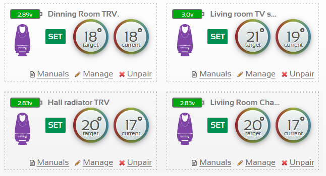

Simple test, is the return water hot, if so the lock shields need setting. The basic idea is there should be around 15ºC temperature drop on each radiator when the TRV is wide open, but not an exact figure, so what I did was use the info from the TRV heads, 4 TRVs-1.jpgif the current exceeds the target then the lock shield needs closing a little, used this method at late mothers house and once set the TRV's kept the rooms spot on.
