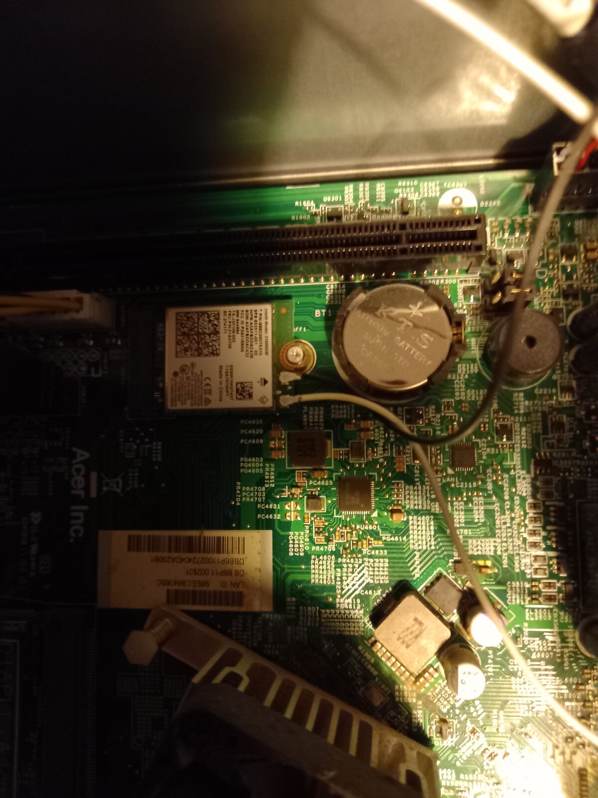

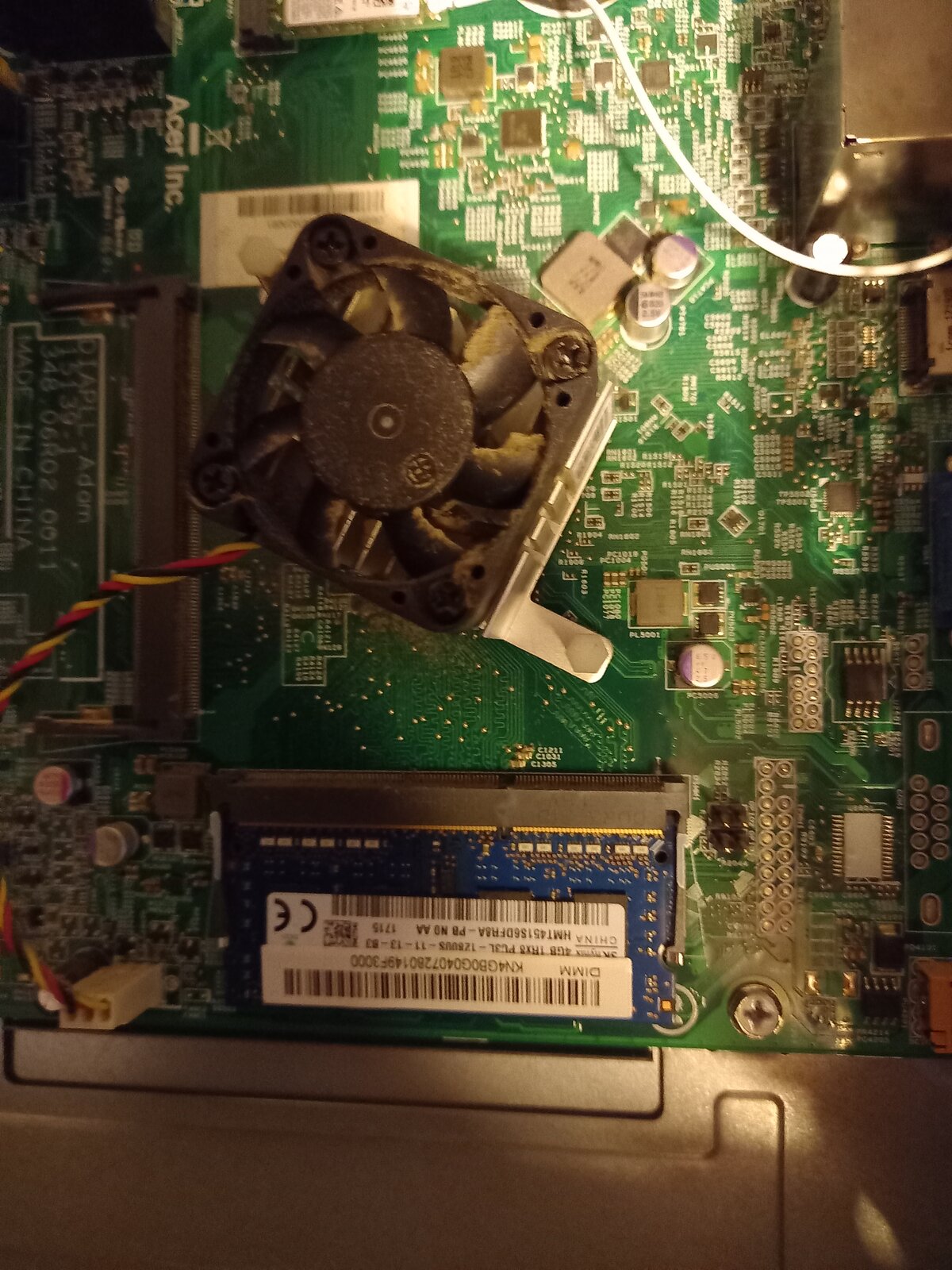

Opened it and took a couple of pics. I assume the RAM is at the bottom of pic 1, and a slot for an additional RAM at the top of pic 2.
The speed is getting worse, really past a joke! I'd be a bit surprised if extra RAM cured it, and solved the ongoing audio output problem, but for £12 I might try it. Where do you get yours from? I assume need to specify the computer to get the right one? That info also useful if I go for a new computer and want to add extra RAM.

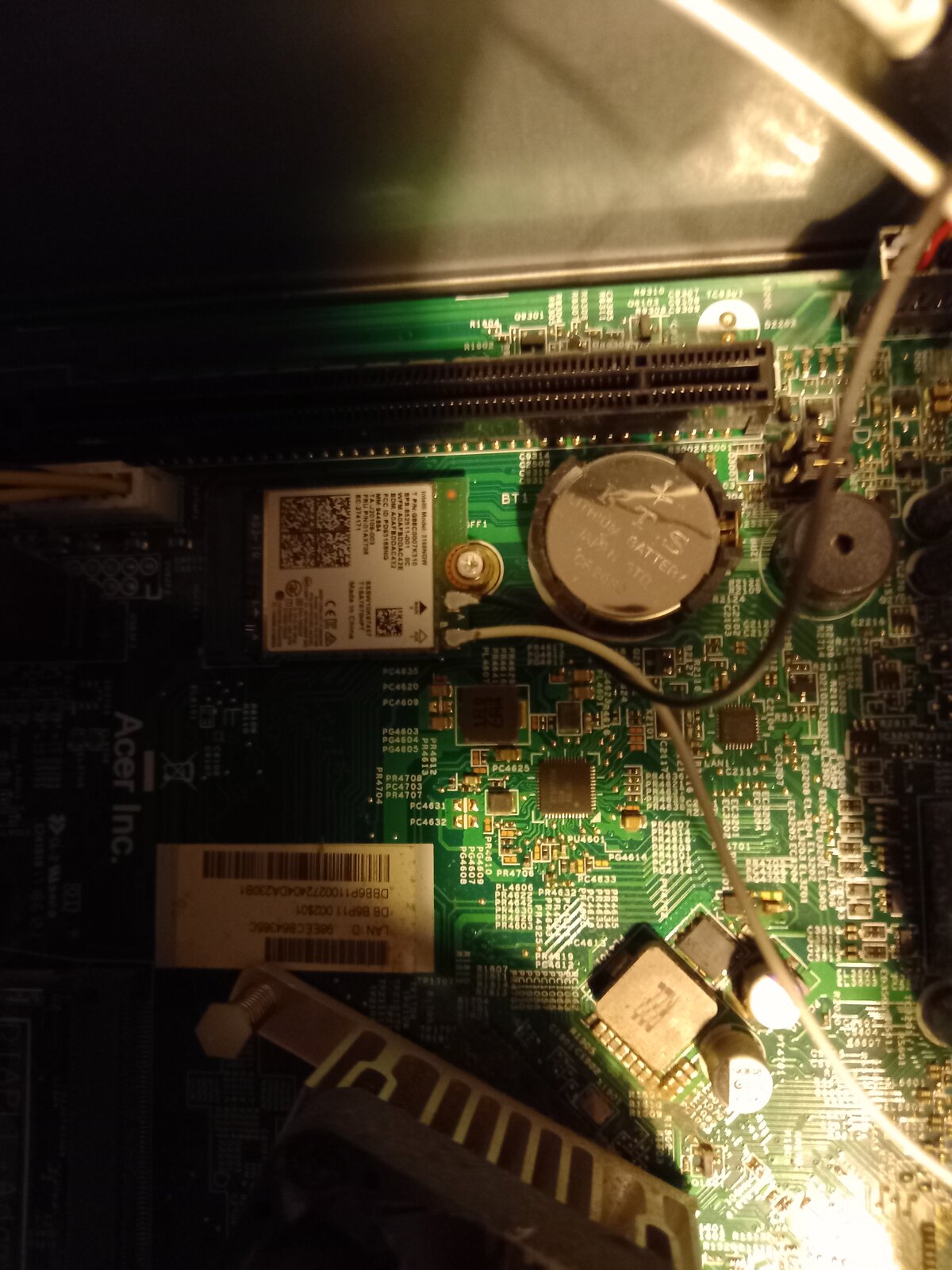

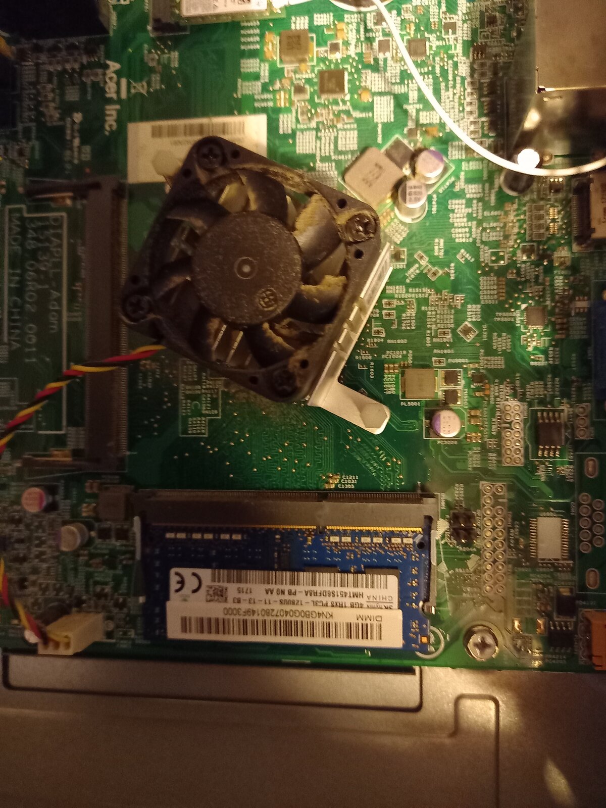

Poor photos, but it looks as if you only have the one memory/ram socket, so all you can do is replace the single 4Gb with an 8Gb stick.
You need to source the correct spec, and type. Take that stick out, get a decent photo of it, and post it on here. Either side of the memory pcb, there are metal clips, push those out, to release the pcb. To replace, offer the pcb into the socket, then press down into the clips, until they latch.
The slot in your second photo, is for an expansion card..
