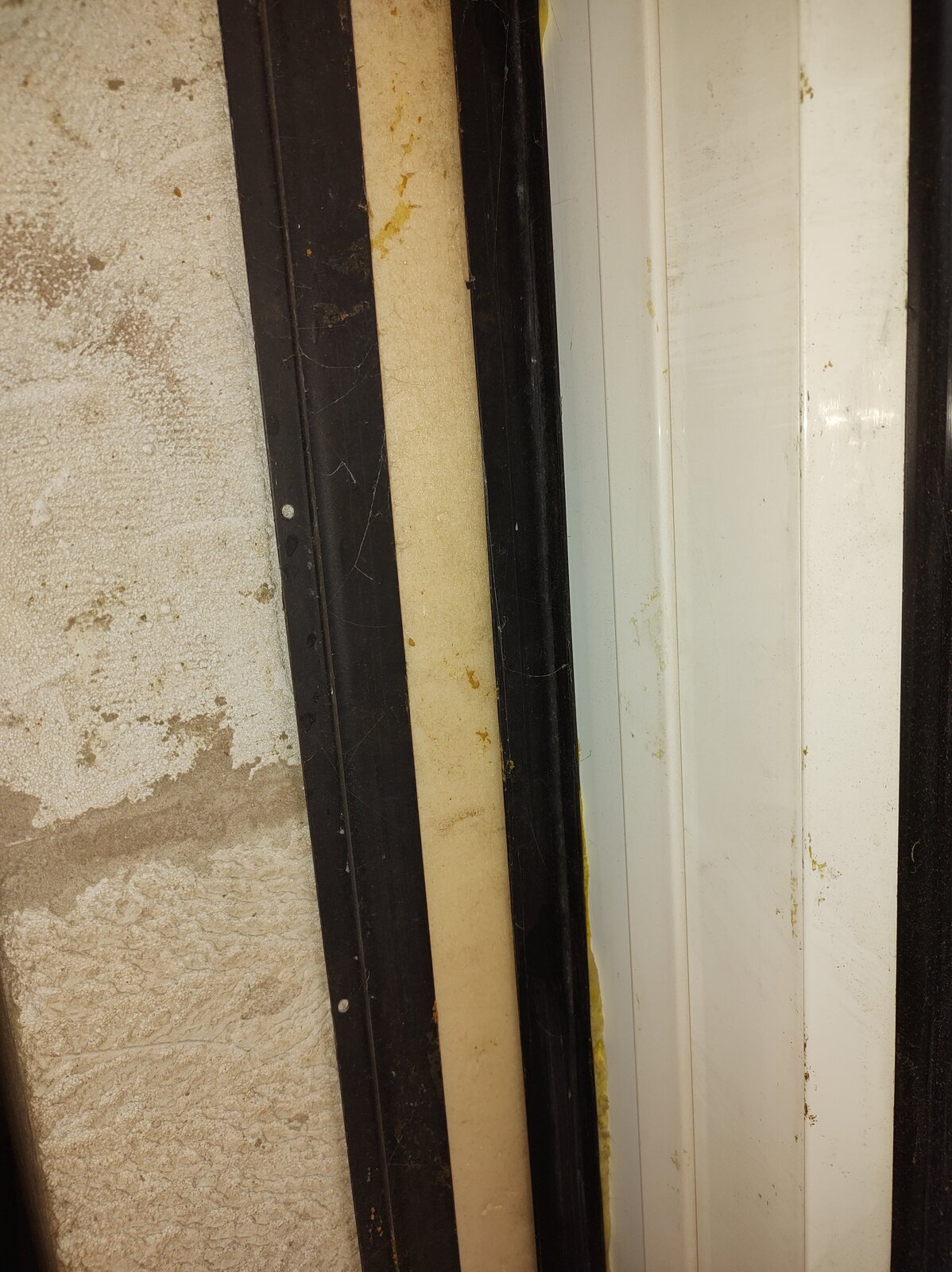

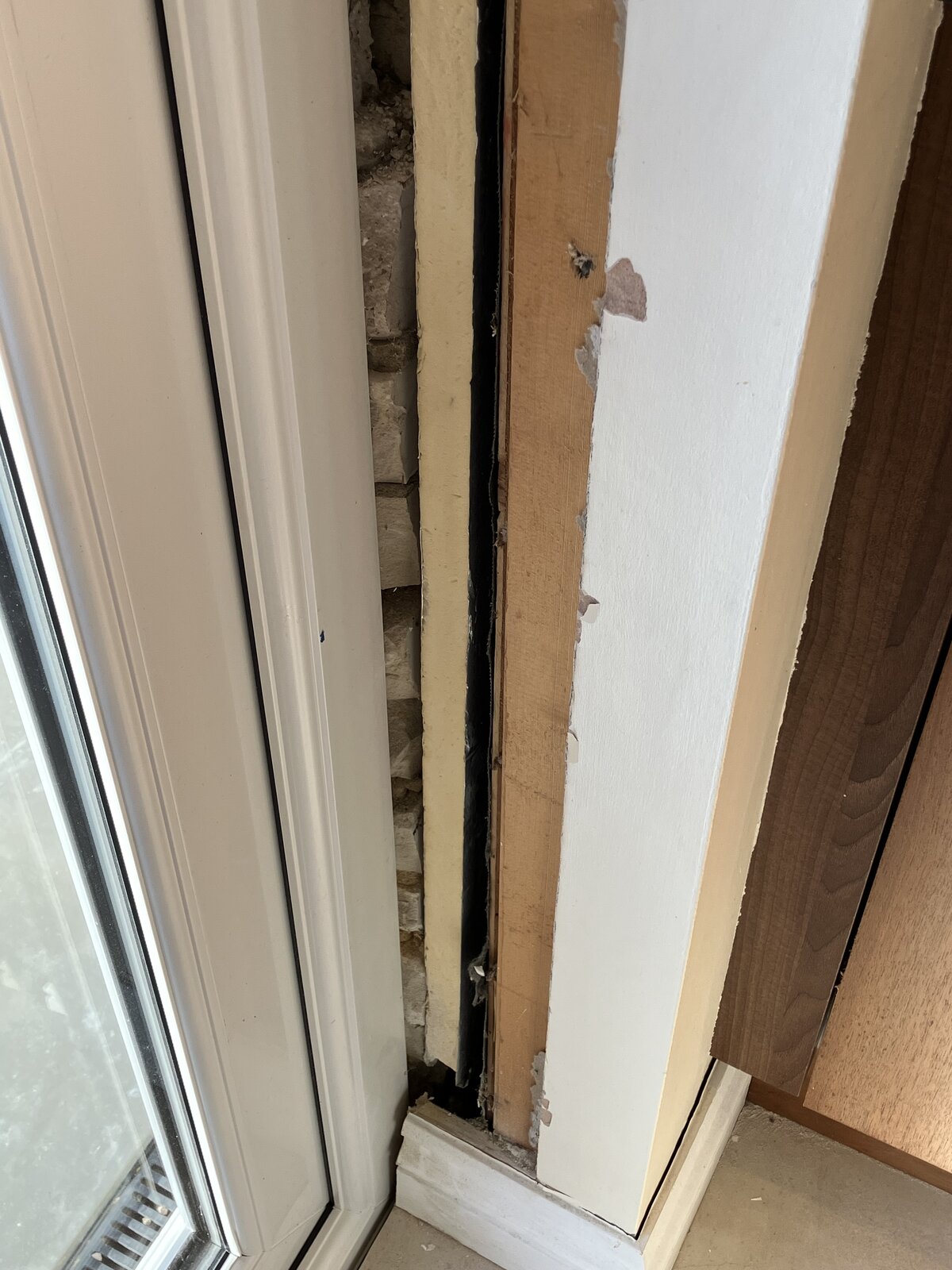

New doors in timber frame house no cavity closers used and insulation put in cavity. Help!

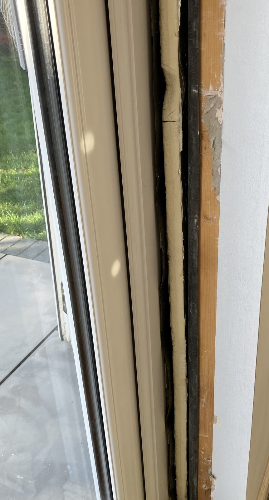

noseall has explained what you need to do, insert a continuous vertical length of damp proof course between the celotex and the masonry, fold it round the corner and (hopefully) there's a little gap between frame and masonry where you can tuck it in. I would run a bead of silicone between frame and dpc. Make good the plasterboard, obviously it's primarily fixed to the timber but some expanding foam or blobs of no nails to gap fill when you press it against the dpm will make it more secure

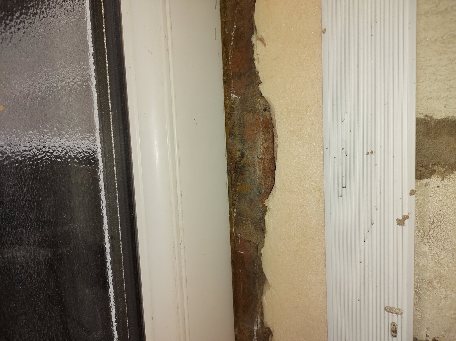

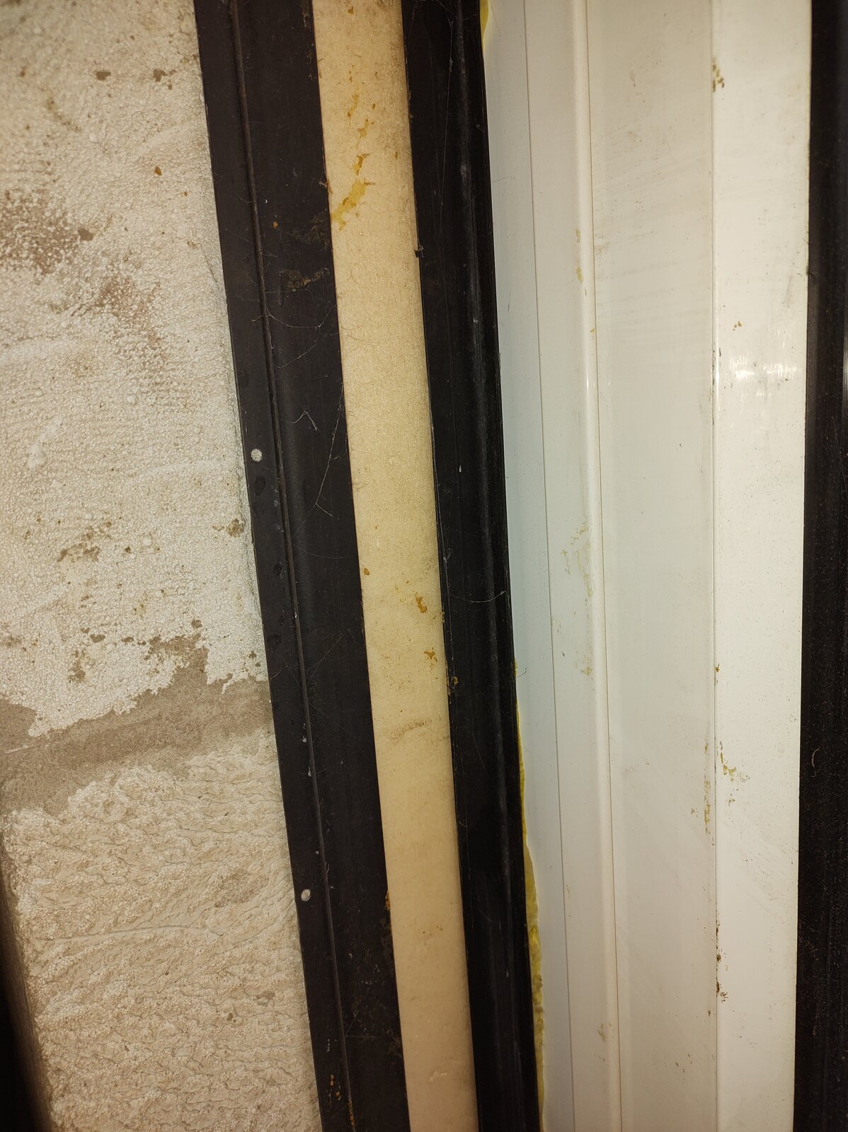

Before:

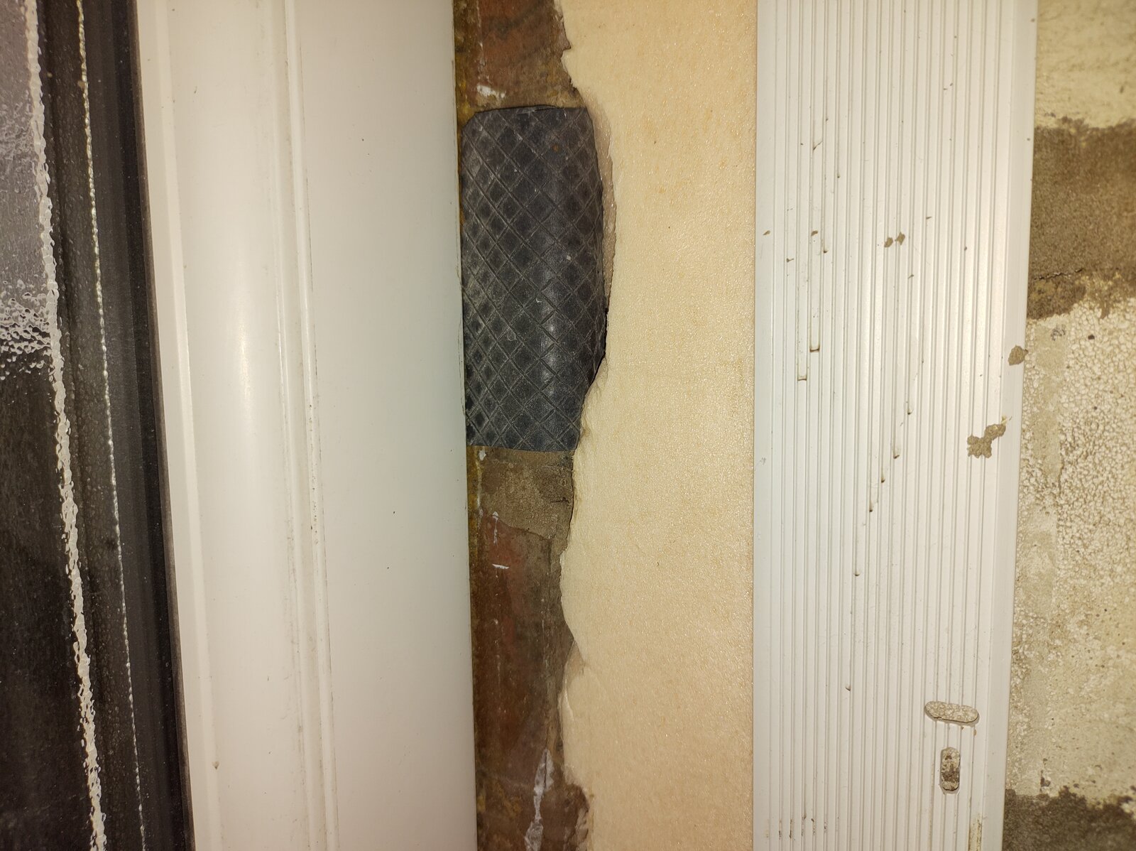

After:
And for info: - a complete cavity closer in action, it's just a strip of PIR with two plastic "T" sections to hold it in place. You could fit some but you still need the DPM because of the exposed masonry. I try to wedge them in tightly so the plasterboard can be stuck to it for a bit of extra support.

Before:
After:

Thank you. That is what it looks like inside ours and they did do a vertical dpm between the insulation and the masonry.
I’m worried the pir will sweat and rot the timber frame?

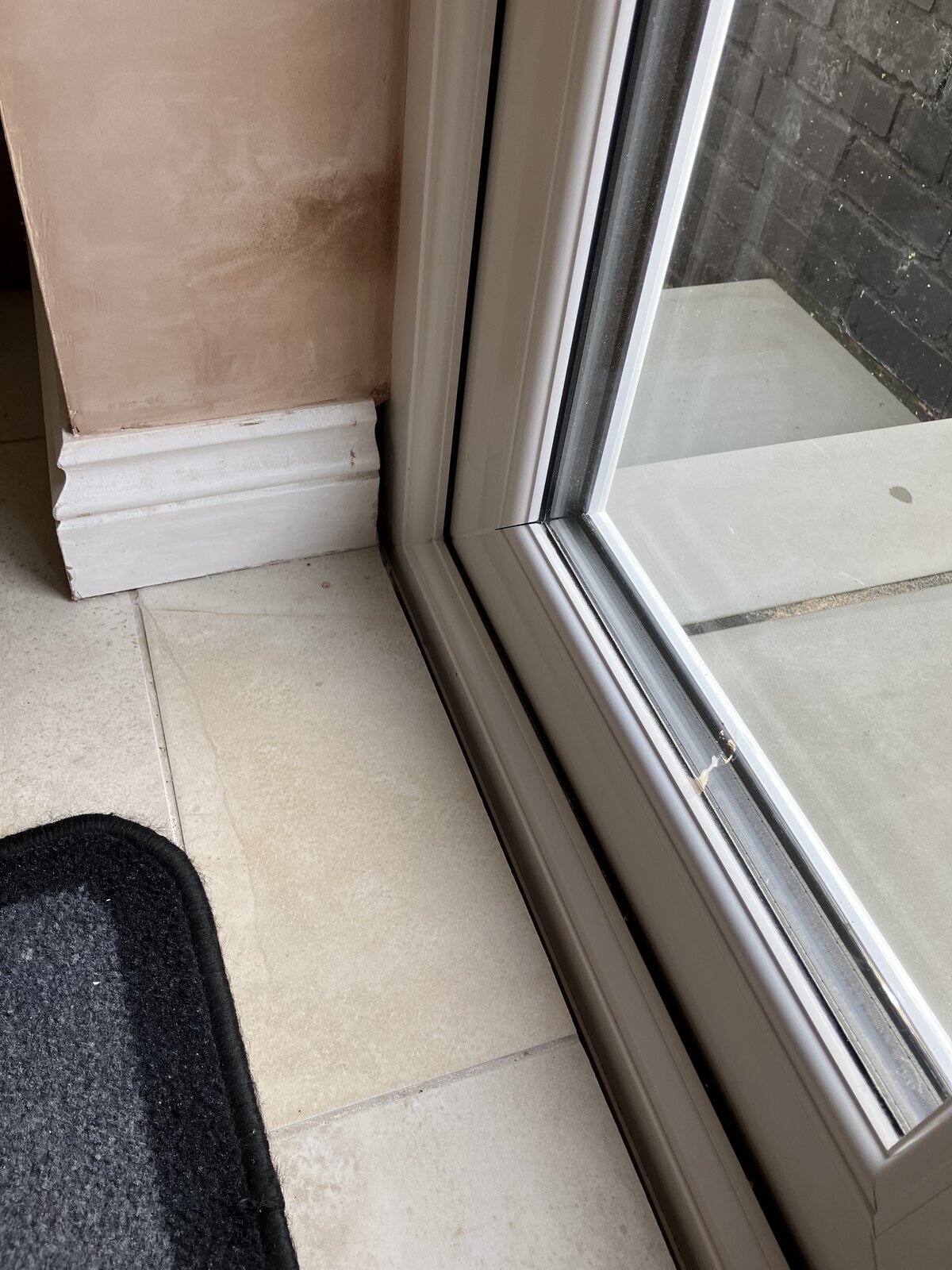

The pir only went down to an inch above the skirting board so expect we’re going to get cold bridging there.
Forget it, that's not what happens or will happen.

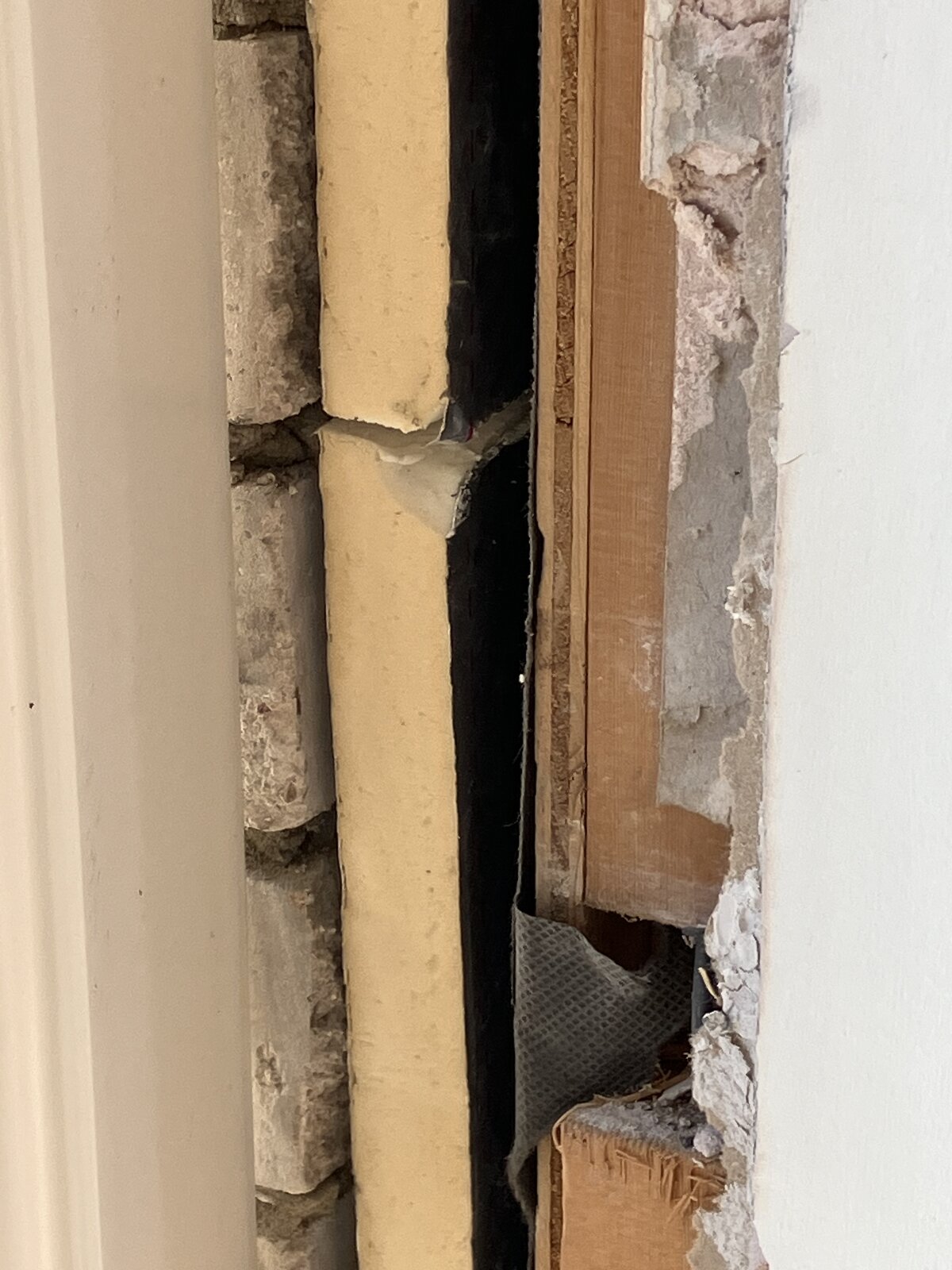

However, there needs to be a vapour check on the face of that timber before you plasterboard it. That vapour check should over lap the existing vapour check that will be (/ should be) on the frame below the plasterboard.
Otherwise it's as in the photos from cdbe regarding the DPC and cavity closure. Except you will need a layer of insulation up the entire reveal to remove the cold bridge created by that inner brick. 10mm should be OK. Or insulated plasterboard.
The vapour membrane was between the tf and the pir but it didn’t come out over the edge of the frame.
Want to get this right in my head before employing someone else to do this right so I appreciate all the comments.
Think I need to start trying to find a builder locally who understands. Thought I’d managed that but guess not.
The builder did try to fit in a 50mm cavity closer but the back of the masonry is not straight and has excess mortar sticking out. That pir board was just 25mm and a tight fit that had to be hammered in so not sure a pre made closer will work.

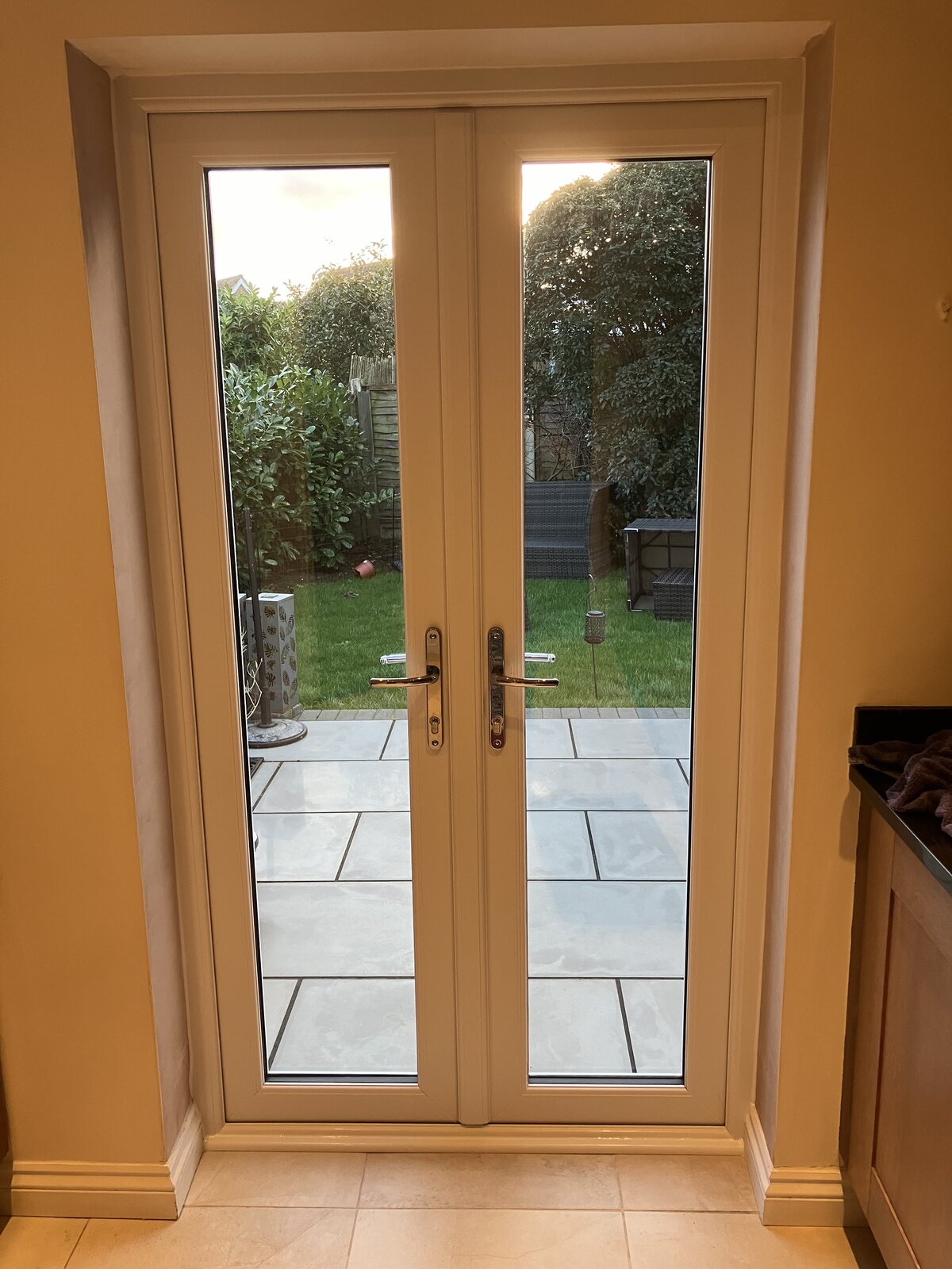

Such a shame it doesn’t look too bad on the outside.. this is the kitchen one.
Lounge ones the same.

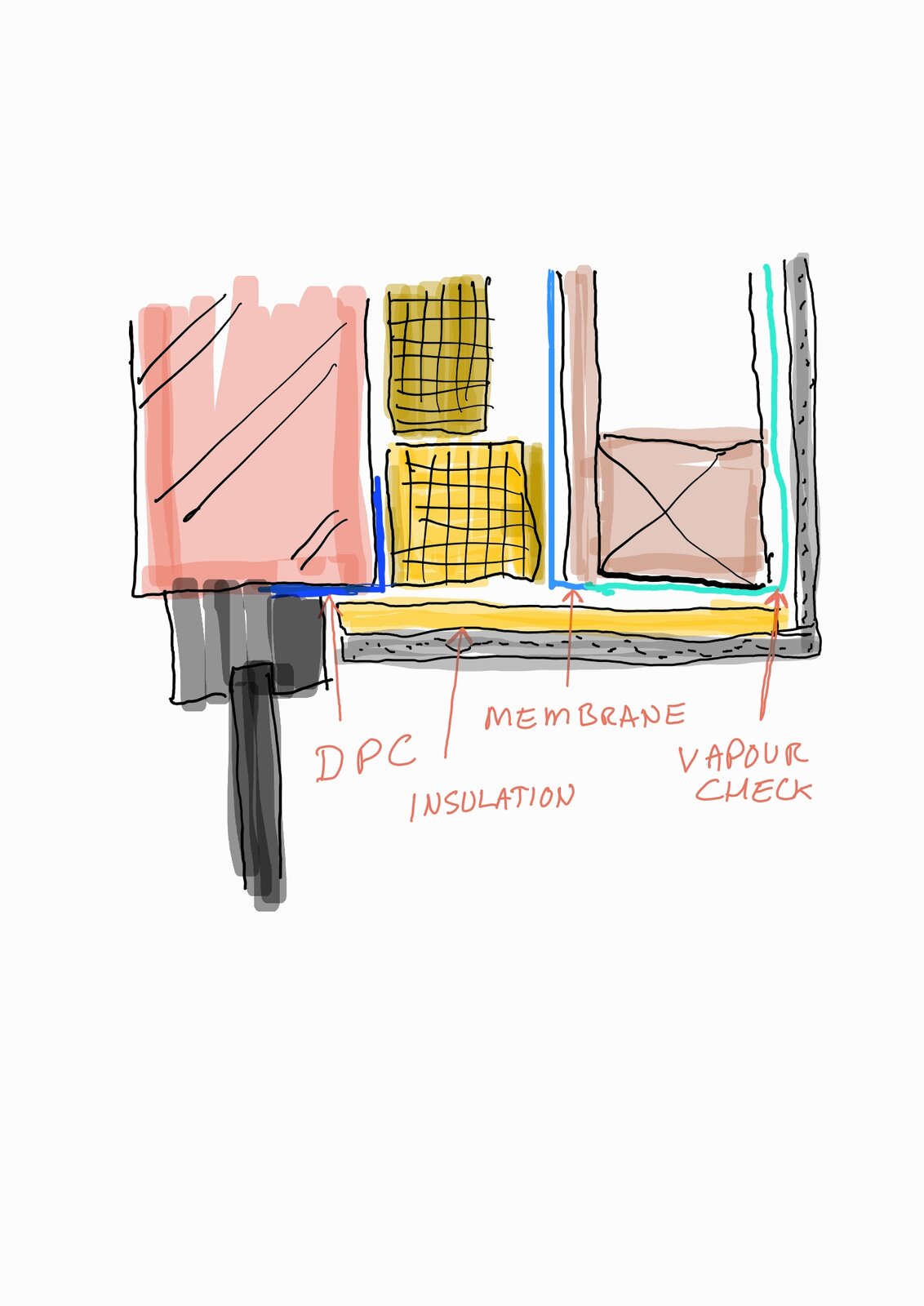

Here is the principle. Ensure the cavity closure is sealed to prevent air leakage. Expanding foam or rigid foam and flexible mastic.
Tape any joins of the vapour check and the frame membrane.
Edit. If that Celotex in the cavity was not there originally, omit that from that sketch and just have the cavity closer. The blue DPC should be a bit further up the cavity than it looks, say 100mm.
