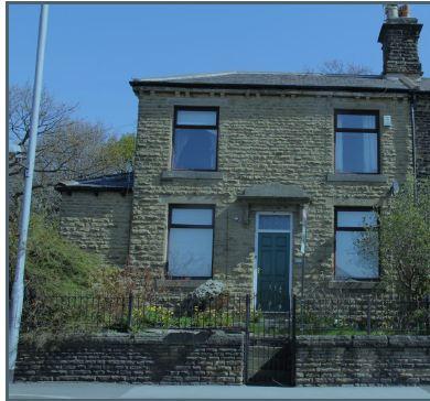

New Double Glazing Installed but Issues with Noise
Stone faced houses normally have quiet a big reveal from where the old sash windows would have been.
I build a timber case around the reveal using 2"x3" then fit the window and foam in.
But contrary to myths double glazed units have no special noise reducing properties.
Thats just salesmen.
Looking at your pictures the profile looks like veka so you've got one of the best 5 chamber profiles on the market.
Regarding the new larger sash.
First put tue back of your hand to where the sash meets the frame, if you can feel any draught then there's not enough compression on the seal, this will be more likely to be arounds the locking area.
Thanks.
I have tested the windows and there is not even a slight hint of air coming through. Like you have suggested it is probably something to do with the material in there.
I have however found what may have been keeping noise out previously.
Please see below the photo taken with the old windows. These were extremely old normal PVC double glazed windows, but as you can see from the photo they had a wooden trim installed around them. I found this extremely ugly and thought it was for some sort of effect.
Perhaps this was actually a sort of sound proofing? I think Id rather live with a bit of extra noise then having this nonsense put on though! Will just get some decent blinds and heavy curtains!
