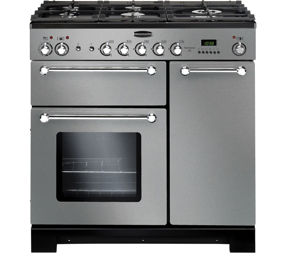

How big is this oven?
Big. Its a
RANGEMASTER Kitchener 90 Dual Fuel Range Cooker - Stainless Steel & Chrome
Note: the house has a terrible cheap oven and hob that came with the house.
After cooking a large xmas dinner we (ok, wifey) decided now is the time to get the oven she really wants.
Cooking a feast with a terrible oven is stressful.
We have the space in tbe kitchen where a range originally went, 100 years ago, and funds, so, why not eh?
Allowing for diversity, this 8.6KW oven will be "rated" at 23.5A so a 32A circuit will be perfectly adequate. I looked at Rangemaster's website, and the 90 appears to have a maximum rating of 7.4KW, which, with diversity comes down to 21.7A. Diversity: 10A + (30% of the balance) + 5A for the socket(if fitted). If you already have an electric oven, (or an electric shower!) then you should be fine with your existing main fuse.
