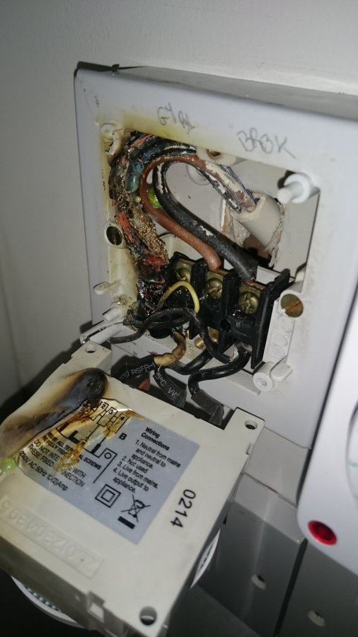

I moved into a new build flat in July 15 and have had repeated issues with my immersion heater which have stumped electricians. Would really appreciate a second opinion.
I have a cylinder in an airing cupboard with an immersion heater at the bottom which is the only source of hot water (no gas in the building). The immersion heater cable is connected to a DP spur with an analogue timer 15cm above. The timer is set to an hour in the morning and 2 hours in the evening. In Dec the circuit breaker to the immersion heater tripped. An electrician (from Checkatrade) came and found the fused spur had blown (photo attached). He replaced the spur, thinking it was just a one off. A month later and the same thing happened again so this time he replaced it with a "heavier duty" spur which looks like minus the fuse to me. He also took a closer look at the cabling between the timer and the spur and found it was 1mm^2 5 core so replaced it with 2.5mm^2 5 core. He said that this was the fault and it would not happen again.
Fast forward another month and this time the wiring behind the timer melted and damaged the timer (photo attached). This is the short bit of cable the electrician had replaced.
I called another electrician this time and he said it may have been a poor connection though he couldn't tell as it had all melted. He replaced the timer and cabling with 3 core 2.5mm^2 as he wasn't convinced the previous electrician had used heat resistant cabling. He also replaced the immersion heater thermostat (Backer BT7) with one that has a reset (Backer BMST7). He checked both thermostats and did not find a fault with either but as a precaution turned the temperature down on the new one. Now the hot water only reaches about 40C but is only one division away from max in the thermostat.
I would like to turn the temp up but obviously am worried about the same issue happening again as no one has actually identified the fault. The building developers have so far shunned any responsibility despite the electrician saying all flats need to be checked for safety. Would really appreciate hearing any input as to what I should do.

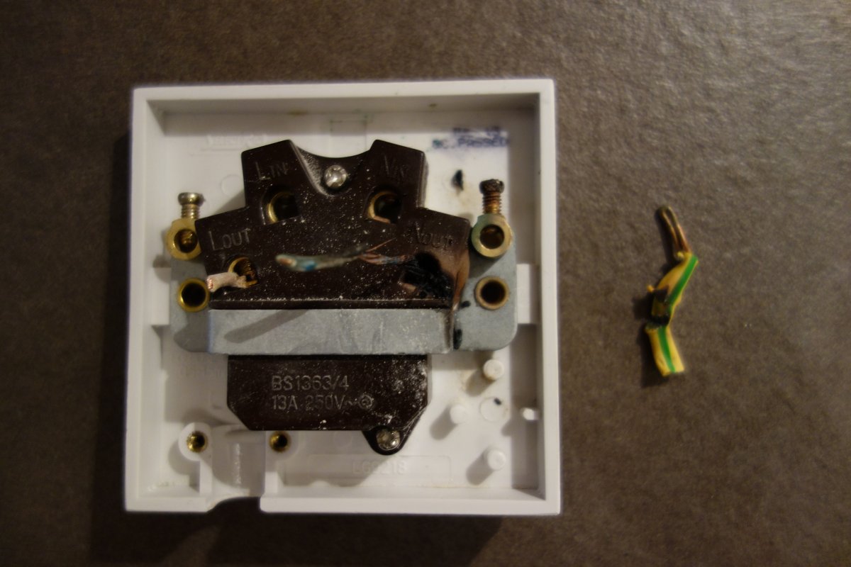

Get another electrician to check how many amps your immersion heater is drawing.
There is no way on earth the wire stubs attached to that double pole switch are 2.5mm².
Is the thermostat switching off? or is the timer switching off before the water has had time to heat up? If the thermostat is switching off too soon, turn it up a bit and try again. There was a batch of 7" stats last year that had a maximum temperature that was uselessly low, the manufacturer has now sorted the problem and the newer stats of the same model work correctly.
Has anyone measured the current drawn by the element? Should be around 12-13 amps.
The usual cause of overheating is poor installation.
Thank you for the fast replies. The wire stubs in the first photo are from the 1mm^2 cabling that the first electrician replaced with 2.5mm.
After the second electrician turned the thermostat down, I left the timer on for a few hours on his advice to check the temperature and it reached a max of 40C so I think it is the thermostat that is switching off. The second electrician did check the current drawn by the element and said it was fine though I don't recall what the value was. I will double check with him.
That would explain it!
I've just read this again, how the hell didn't the electrician notice the cable from the spur was 1mm² when he was wiring it into the new spur? I could see it from a small photo! And what moron used 1mm² flex in the first place?!
It looks like the terminal that had melted was the neutral, the 2 wires being neutral in and neutral out, almost certainly a poor connection.
...He also replaced the immersion heater thermostat (Backer BT7) with one that has a reset (Backer BMST7).
If this is a new installation the element should already have an overheat cutout, the newer Backer elements have a separate cutout with white wires and a little black reset button, and so are supplied with rod stats without overheat protection.
